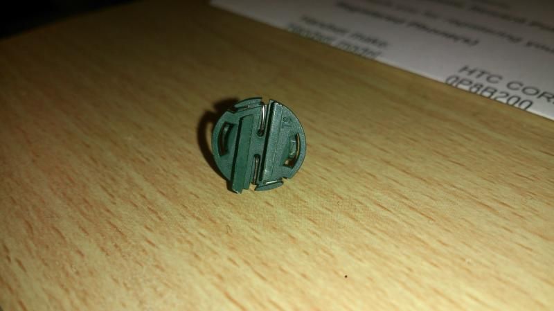

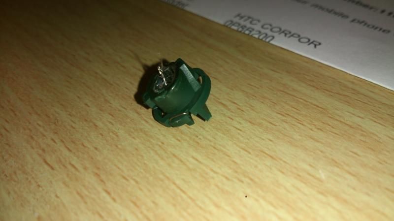

This is from behind the heater controls, off the circuit board, it's been on it's way out for a while, the bulb seems to be part of the holder, it broke trying to get it out. Thanks guys.

Had one blow myself,only ones i could find were genuine toyota, got mine from genuine service parts on here in affiliates but there not cheep .

Think it's bulb,w/cap 90010-05124, hope this helps
cptspaulding
Ask CTP on here. They were £6 each when I bought them earlier this year. I believe Mr T would charge you £9 a pop.

Sub min bulbs ? Most cars use them......you re-use the holder......just wrap the wires around it (similar to an  led)
