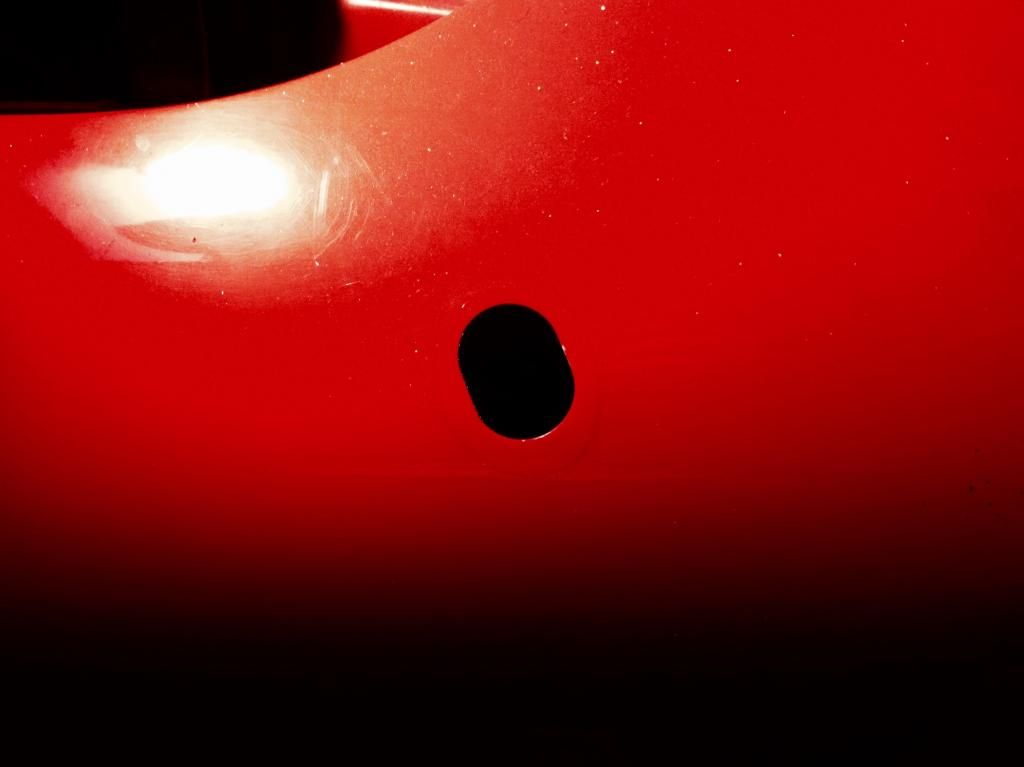

Hi, I am going to completely remove my aerial.
does anyone have any good ideas on something to block the hole in the wing? A bung that fits, or similar?
thanks.

Just to throw a spanner in the works , the hole is not round but a oval
with flat sides.

That's the kind of thing I was thinking too. It's a shame it's an awkward size and position.
Plan is to remove it, measure it and find something to fit. Because my car isn't in use, it can be done without driving round looking like a plonker

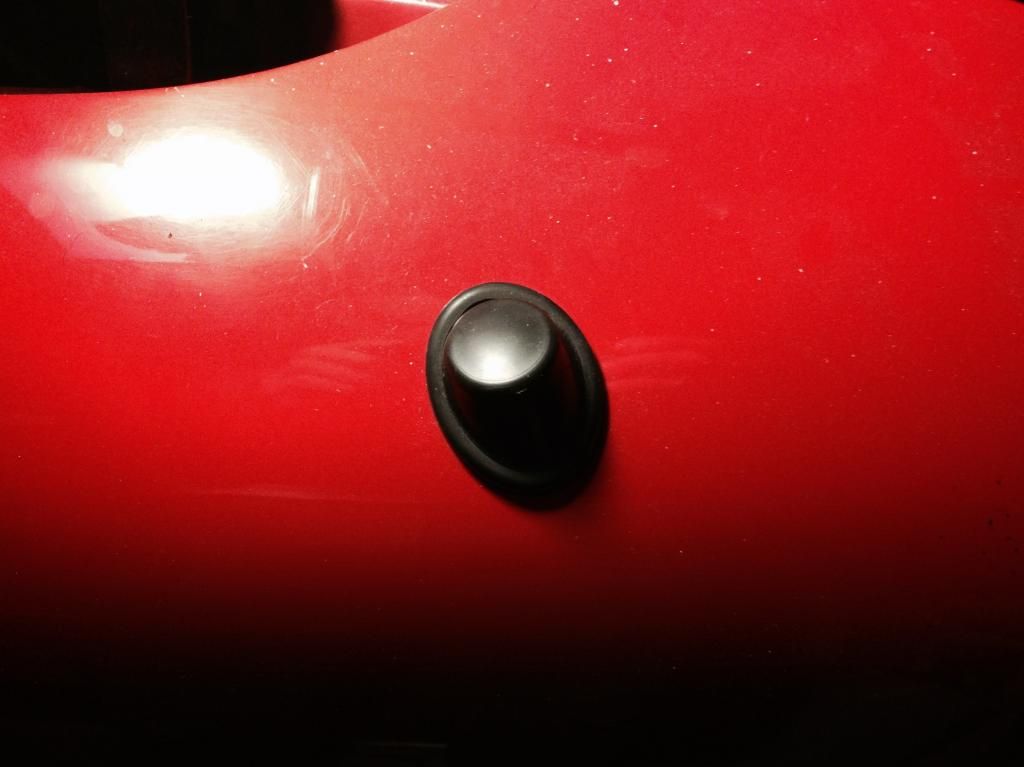

I took the rubber boot off the old aerial and then put a grommet into that, leaving a nice "OEM" looking blank. You can then either knock up a fixing underneath or bond it onto the wing with something like Tigerseal.

Mr Hamspeed, I'm going to do your trick; did you use the bonding technique?

Fin, I've done it today, go to Halfords and get a pack of "Aerial Grommets" for £1.79
Use the smallest (19mm) and plug the top
I think it looks neat.
Just need to bond it onto the car now  s:) :) s:)
Thanks to Mr Hamspeed

Missed this, glad you got it sorted...  s:P :P s:P  I have bonded mine on with Tigerseal, a thin bead around the inside where it mounts onto the wing and a thick bead underneath for some additional strength.
