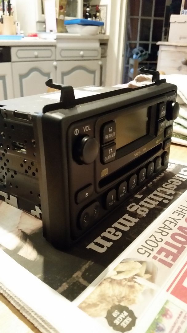

Not sure I am being clear on what the problem is here, but as it happens I have now managed to remove the surround from the old unit, it wasn't hard at all, but I guess the Halfords guy was worried about forcing and breaking it. Anyway, I have the damn thing off now, just need to know how best to proceed. I assume I'm going to have to remove the whole thing to fit this? Anyone know? Some pics below...
So this is what it looks like currently with just the side fill panels fitted:-
i.e. a bit rubbish!
This is the surround off the old unit:-
Not sure what the two big prongs locate into, I assume if I go to the effort of removing the whole unit it will become obvious!

The 2 prongs go into holes under the heater controls. Have you looked at the thread about fitting a new stereo? If not, have a look for that and it should help you. When I did mine it was all straightforward once I knew how to take the side pieces off so you can get to the screws etc. Once you have done it a few times its easy enough. I cant remember if you will have to take the unit out to get it on and I seem to remember taking the heater knobs off to get at screws to remove the heater control panel off the first time I did it but it should all be clear if you find the 'how to'!

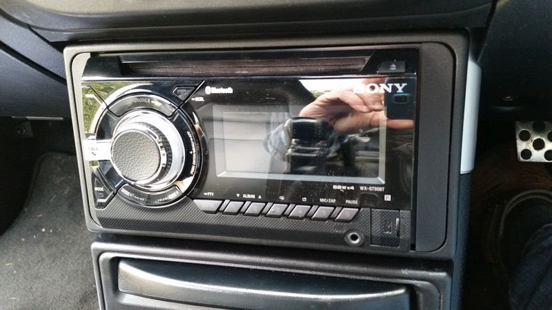

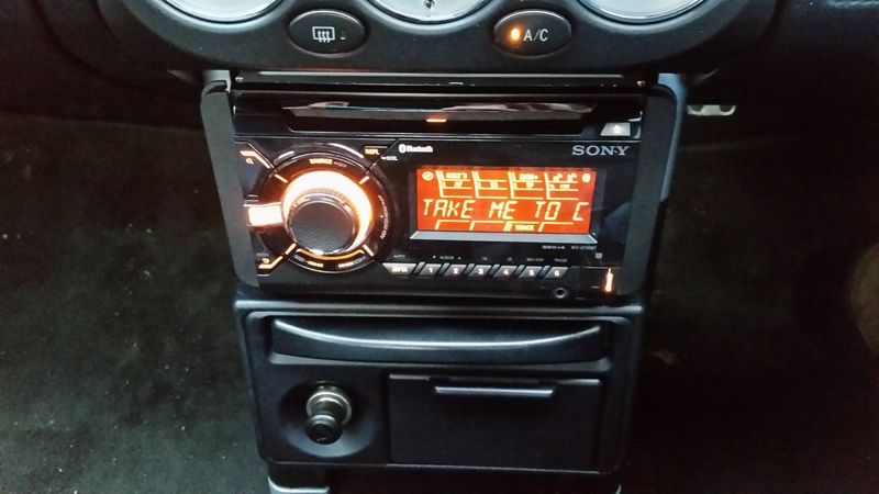

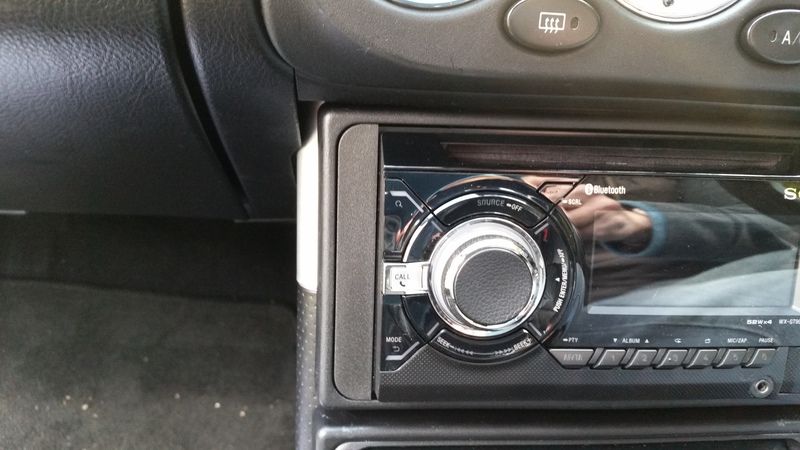

Jaffacakes
Hi all, after taking it all apart and faffing around with it for a bit, this is the best I could get it:-
Side view:-
Front on and to right:-
Front on and to left:-

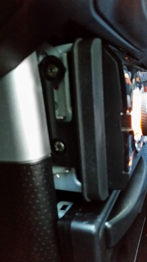

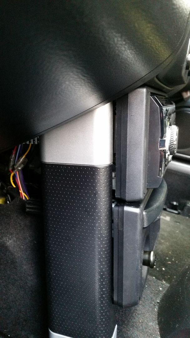

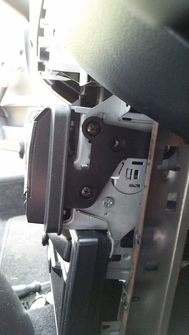

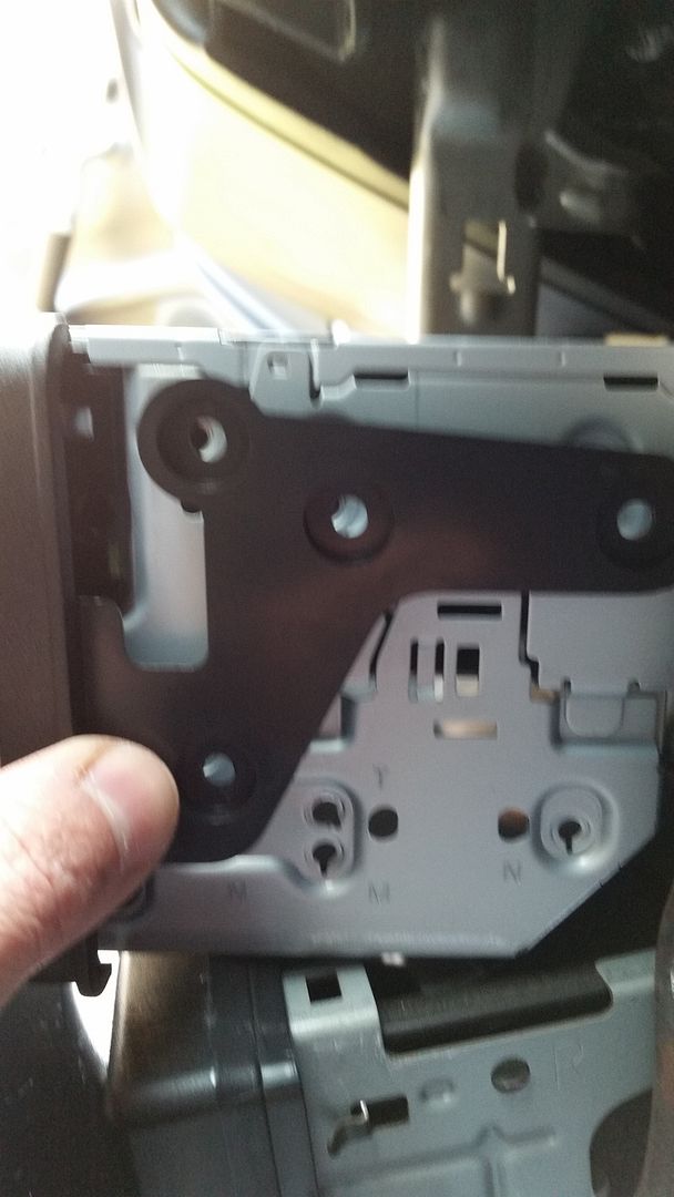

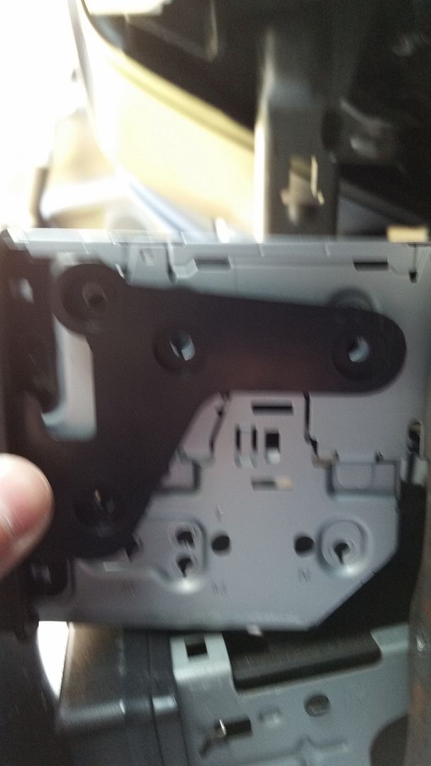

If you look closely you can see the side fillers aren't perfect. I noticed looking at a pic of Markb's, that his side fill panels fit to the side of the glossy black outermost edge of the Sony unit, but with mine, the only screw holes availble to fit them moved the side fills forward slightly so that they actually overlap the edge of the head unit. Hard to explain, but I had to loosen off the front screws on the sidefills to make them bend out slightly.
Picture of side fills with hole aligned and overlapping outmost edge of new head unit front:-
Picture of side fills with the front put flush with outmost edge of head unit which is where I want it, but as you can see, the holes don't line up:-
If you switch sides there is no way of fitting them with screws through the original plate that secures the stereo to the dash.
Side bracket screwed over original bracket:-
Additionally, the original surround doesn't fit brilliantly, its on there, but there is some play forwards/backwards in it if you knock it.
Anyway, looks much better with than without, but I am going to try and get a PFL surround and do something with that.
What I would say to anyone who is uncertain of fitting a head unit yourself (like I was!), that actually getting removing/replacing the head unit is a piece of cake and I wish I had never bothered paying Halfords the £30 to do a half ass'd job in the first place!
Fortunately, for the money, the new Sony unit is great and works brilliantly with my Galaxy S5 phone for bluetooth music and telephone and fits nice with the originaly interior, especially when lit at night.
