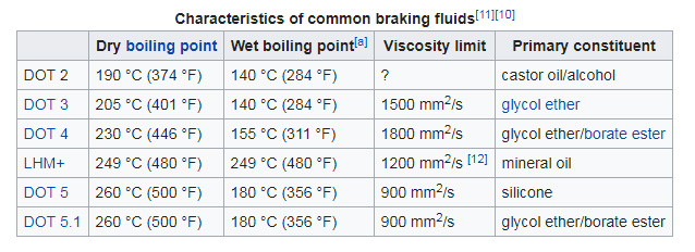

Edit to add some data, first is a generic brake fluid spec taken from wiki site (https://en.wikipedia.org/wiki/Brake_fluid)  and typical for a base spec fluids.
Next some what i would call track spec Dot4 fluids, just look at that SRF wet boiling point compared to RBF which in itself is a very good fluid and what i generally use and just keep it fresh.
