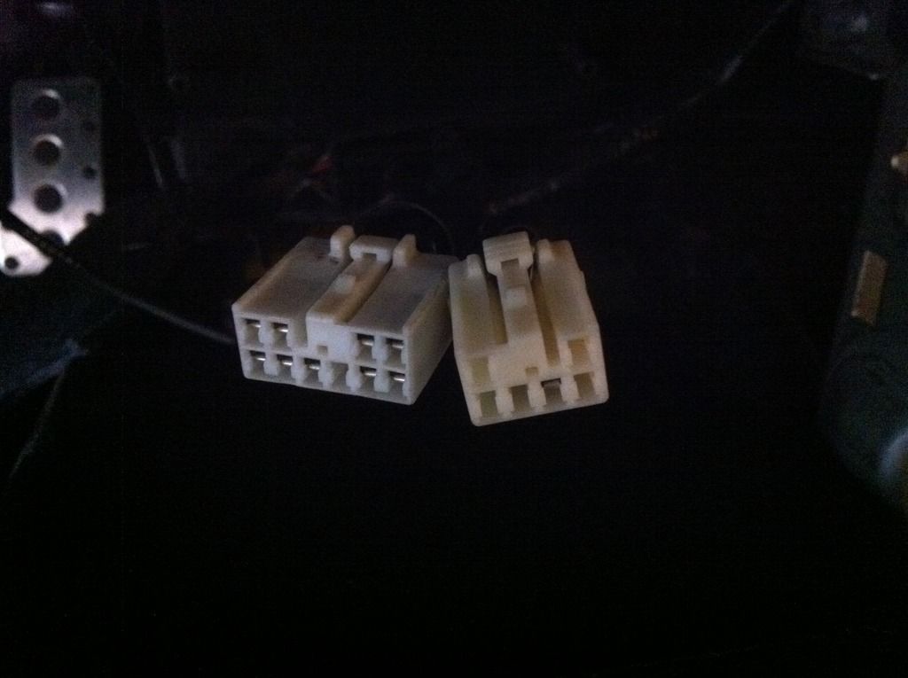

Is it possible?
Because I´ve got just two plugs, which fit into the facelifted stereo. However the other 3 sockets in the unit are still free and radio does not work.
Thanks
Kimitech
These are the only two plugs I have in my car.
They do fit into sockets CN701-1 and CN701-2 as displayed on the third picture below.
Any idea how to mate them with the facelift "fisher price" stereo so it work together?
Would be helpful, if somebody who owns a facelift stereo, take a shot of the wires, how they are actually wired in the connectors.
Kimitech
Put simply, what has to be connected on the facelift radio in order to work properly its radio and CD function?
Or can anybody tell if his fl radio in his fl car works only with the 701-1 and 701-2 connectors as per picture?
Many thanks

Some say, it should work on these 2 connectors I have in my car wiring.
In order to eliminate the possibility the radio is not faulty I would be pleased by following.
Best solution would be if somebody with FL car and FL stereo, could try if it runs just with the 2 connectors attached to it. CN701-1 and CN701-2.
Many thanks for the help
Kimitech
Come on guys, I know I´m asking a lot but you´ll help me a lot as well.
Just some of you could try if the fl radio works with only 701-1 and 701-2 connectors connected.
Many many thanks
Kimitech
So I´ve just tried if it accept cd and it does, it even play cd but you can´t control anything at all except the eject button.

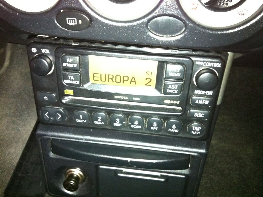

Whoala, works great.
Just the plastic surround is needed - seems like its the same as the one below did it try somebody before if it fits?

Has anyone else managed to make the FL stereo 58806 in a PFL car?. The OP is long gone and never explained how he got it to work.
I also seem to only have CN701-1 and CN701-2 plugs in my car, and with those alone, I cannot turn the FL unit on. Research suggests there are two cables in CN702 that the FL unit might need to work properly.
1) is there a CN702 connector hidden somewhere in PFL cars?
2) should the unit work without CN702 (ie is my FL stereo faulty?)

I have and it works. I did a thread on OEM stereos if I can find it.
EDIT: Although I do have 4 connectors, not 2. And I do have a PFL.

tadekk
Quote from: fawtytoo on July  5, 2026, 21:30I have and it works. I did a thread on OEM stereos if I can find it.
Wait, so your 2002 PFL had 4 white plugs? Were they tricky to find and why doesn't my 2001 have them :(
In any case, it may be moot as I splashed on the GT86 stereo, hopefully it will work on just two plugs I do have
