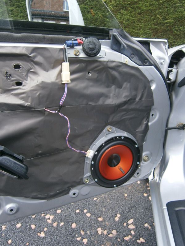

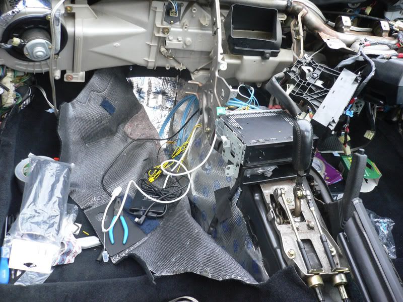

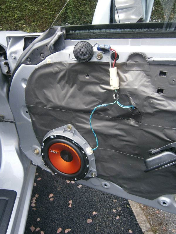

I'm broke.  Nothing new there.  New 2 needed some audio as the stock stuff, well least said about that the better.
So here we go, full system on the cheap.
Edge Street ED306-E2 components - ebay/new - £30
Sound deadening - B&Q - £14
Adaptors - just gutted the stock speakers as they have the rain guard on them.

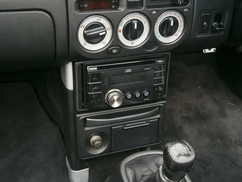

Head Unit - Ebay/Used - £35
Wiring Adaptor - ebay/new - £4
The surround and brackets are stock

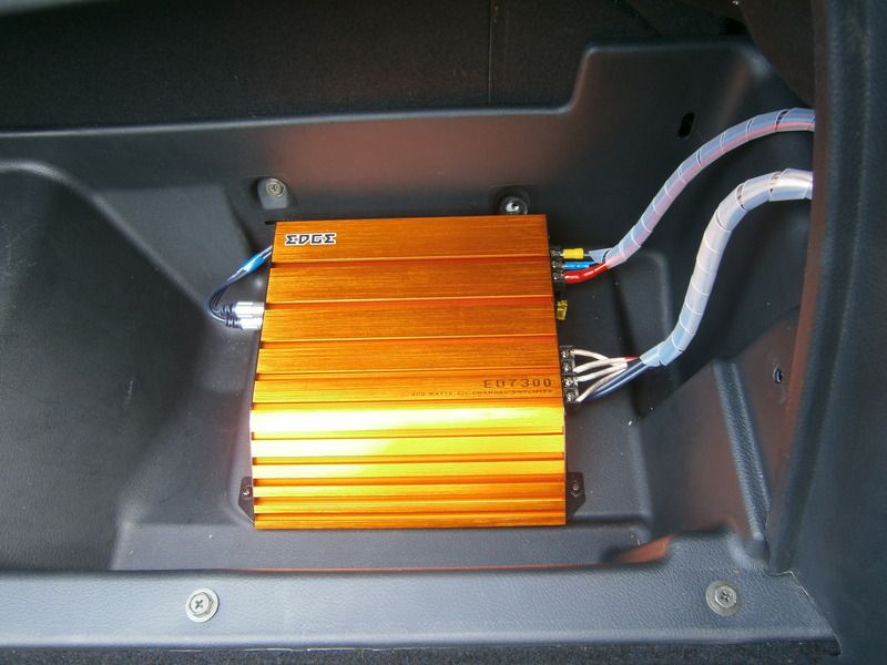

Amp - Edge ED7300 2 channel - ebay/manufacturer refurbished - £35
Wiring kit - I managed to cobble one together from bits left over from prevous installs    s:P :P s:P   - Free
Budget didn't stretch to a sub but hey ho.
Total dosh spent - £119
Doesn't sound half bad either, pretty good for a days work.

Head unit was the first mod I did. Can't cope without BT and USB.

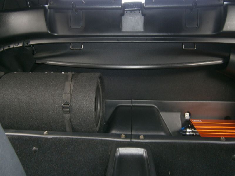

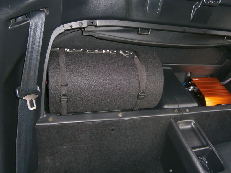

Well continuing the audio on the dirt cheap trend, Sub added today.
This is a bass face 8.1 base tube off Amazon which costs the staggering amount of £25 whole English pounds brand new   s:lol: :lol: s:lol:    s:mrgreen: :mrgreen: s:mrgreen:
I've temporarily swapped my fronts onto the Head Units internal amp and used the Edge amp to drive the sub.  Just until I can get a cheap 4ch amp.
So here's the finished product...
Okay so maybe its not that easy.   The sub as you buy it has two problems, first its ported as its a cheap chav sub, ie loud and a bit muddy/street bassy.  Second its 8cm too big to fit well in the MR2.
Thankfully its also very light for a sub.
So it did require a bit of a DIY trim down....
* First job was to take the sub, port and binding posts out.  Dead easy they screw out and come off.
* Carefully cut round the tube (port end) with a sharp knife and peel back the covering from the tube.  Its actually a very thick cardboard, which acoustically is better than plastic and easier to cut.
* Cut the tube down to 40cm (is normally 48cm).
* Remove the end panel from the cut off  8cm section of the tube.
* PVA glue and stick the fabric back on and fold it in
* Re-insert the end panel tapping it in lightly (its a tight fit)
* Replace the port, binding post, sub.  I actually used silicone on the inside too to make it air tight
* Last job is to plug the port with foam, very important this or it will sound dreadful and now the enclosure is smaller at around 0.3 cu ft, it really should be sealed.
So fired it up and so far so good.  It gives a good amount of bass and much less muddy/chavy.   With the roof down a bit is lost but that's the same with any sub, except for the UD units.
Whilst I has the sub out, I checked it over.   Its non branded obviously, but has a decent magnet and construction.  No worse than the subs you get for about £30 off ebay.   At some point if it dies I will throw a JBL in or the like.
I need to run it in and test it some more, but so far for £25 its an absolute steal.
As a side note I'm fairly impressed that the edge components don't sound too bad off the HU either.  Not as good as having them amped but still decent.
