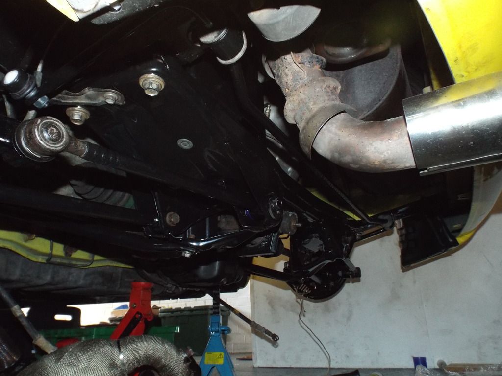

so far so good really see a small light at the end of the tunnel. fitted all the bushes tonight bolted all up ready for brakes
left to do list
1.build rear brake calipers  (tomorrow)
2.Bleed brakes
3. Put in some steering fluid
4. fit exhaust (doing that at Bonsai)
5. MOT
6. Ding Day !!!!!!
justinread72
#135
there are not enough swear words to say how the rear calipers went!
They are done now, things you need to know when buying a rebuild kit the pistons I was supplied have no inners.  you have to remove the old thread and its a impossible task the factory ones are pressed in.
a mate at a Toyota dealer saved me from loosing my mind, so I used the old pistons and as he advised they are fine and the new seals was what was needed , new OEM pistons a pair from Toyota £260 !!!!  s:crazyeyes: :crazyeyes: s:crazyeyes:

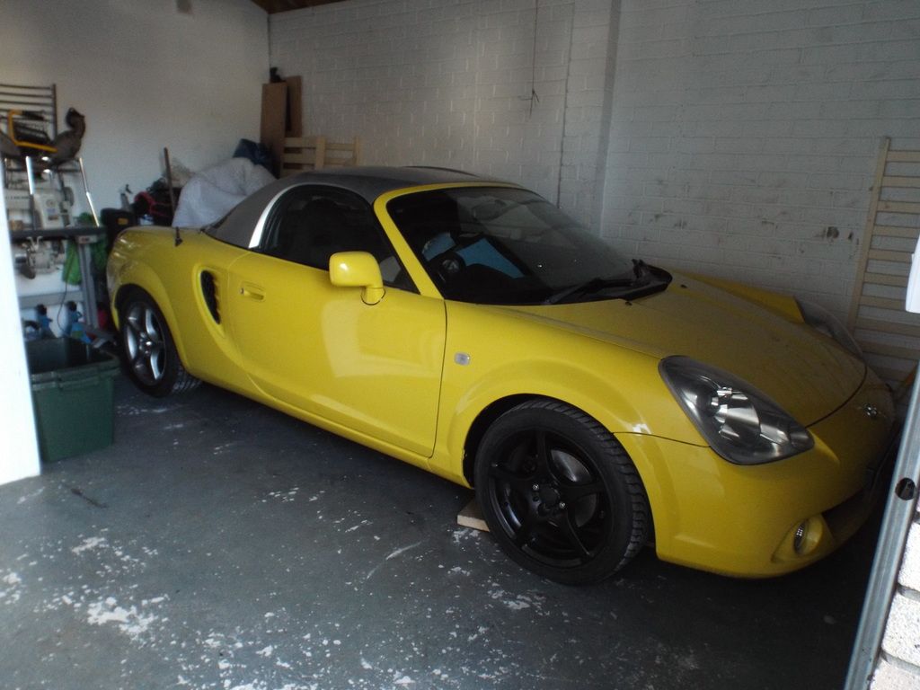

And finally
TOUCH DOWN !
so off to Bonsai next week for a check over and oil and filter change and new exhaust and my bargain induction kit
cant wait to drive the beast and my its low !!!

Well done chap.  s:-D :-D s:-D
#140
What an awesome looking...........hardtop!  s:lol: :lol: s:lol:
Well done mate lots of hardwork has payed off.
