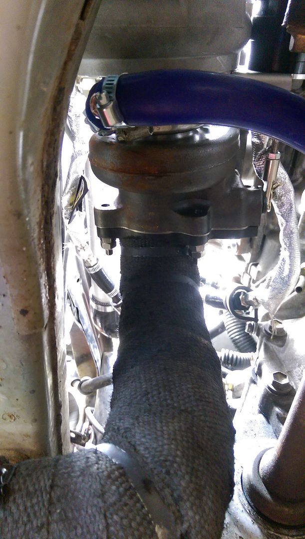

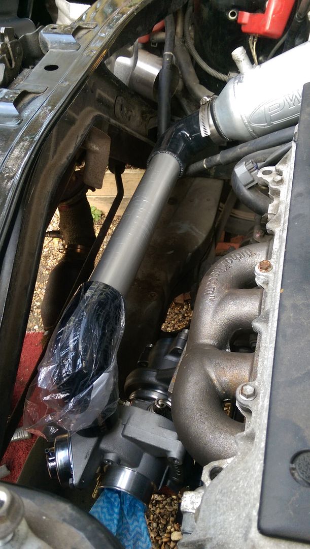

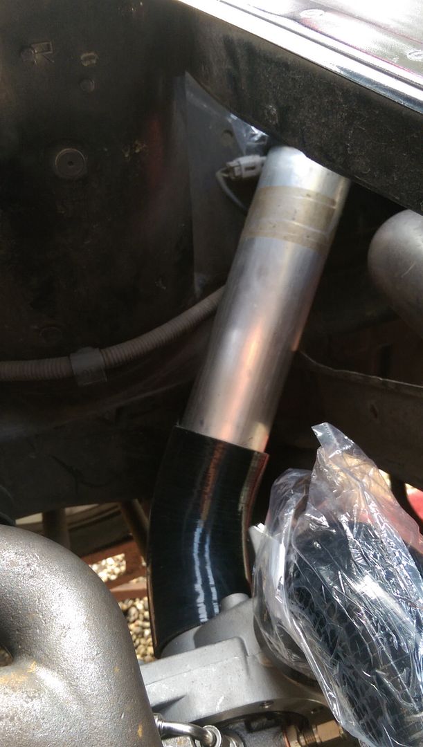

Today's progress the post turbo piping nearly complete.
Just need some new jubilee clips/clamps

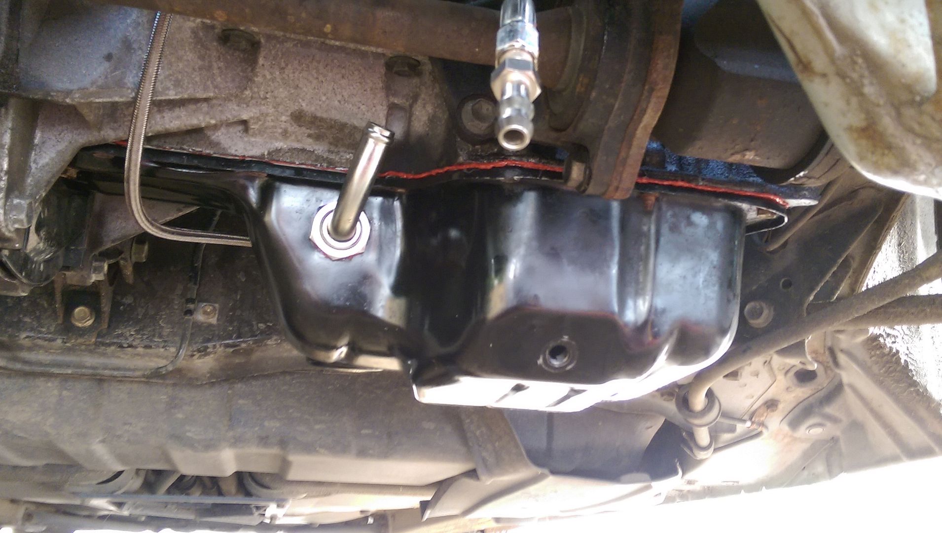

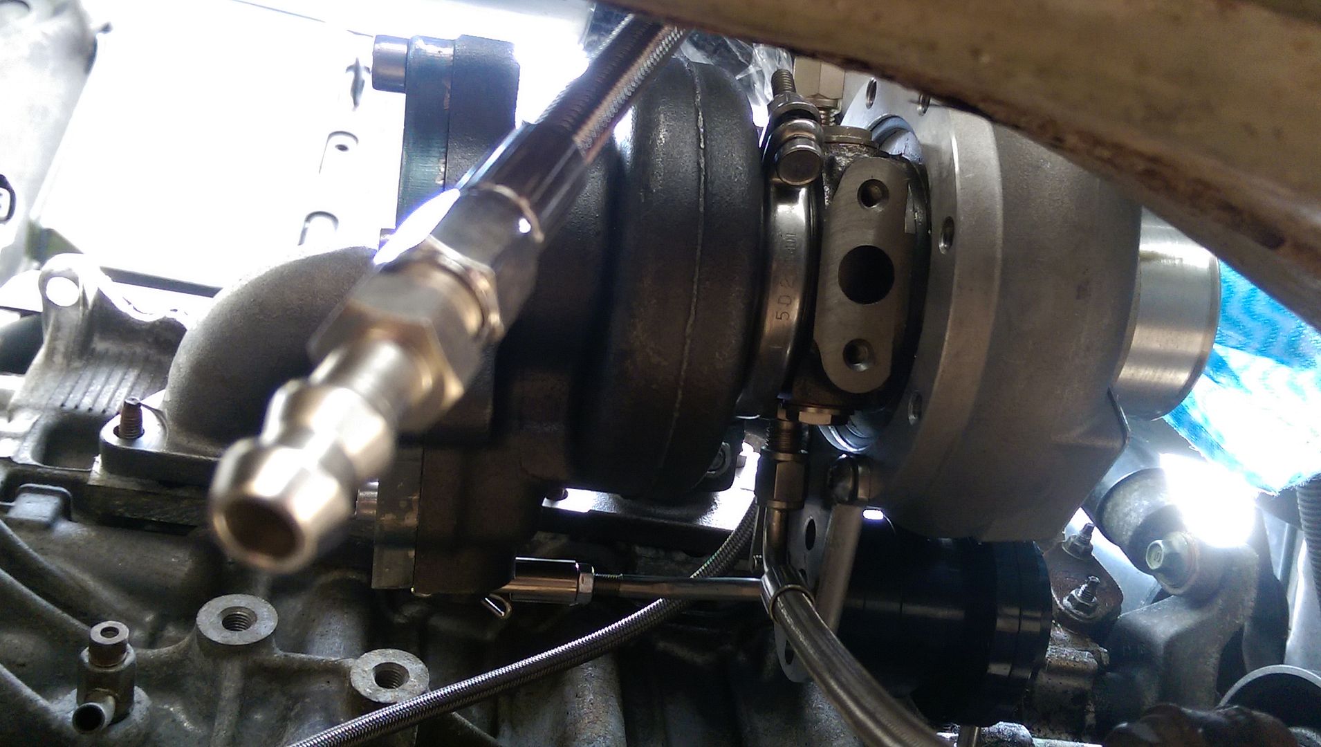

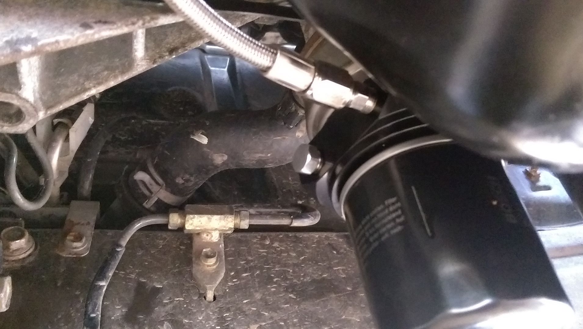

Sump tapped and return added plus sandwich plate installed
I will need to fabricate a support bracket for the turbo.

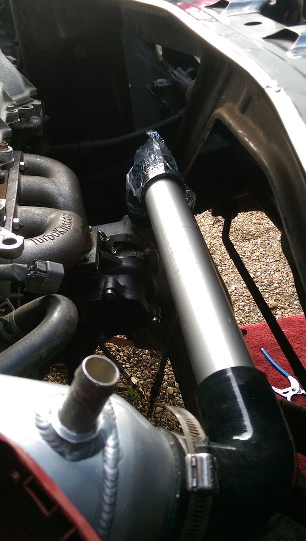

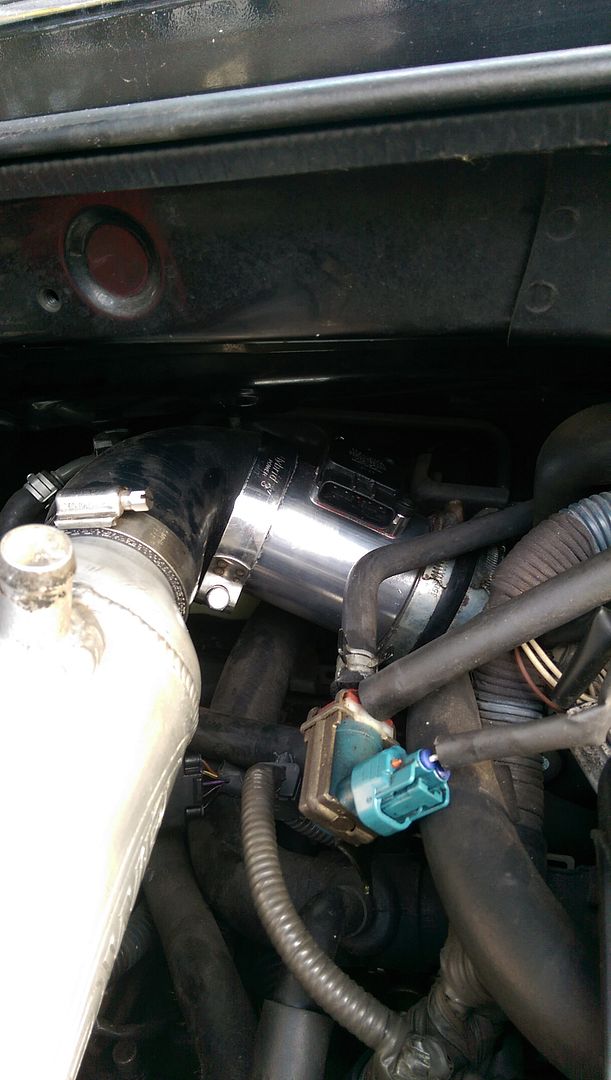

Air intake pipe from behind rear light

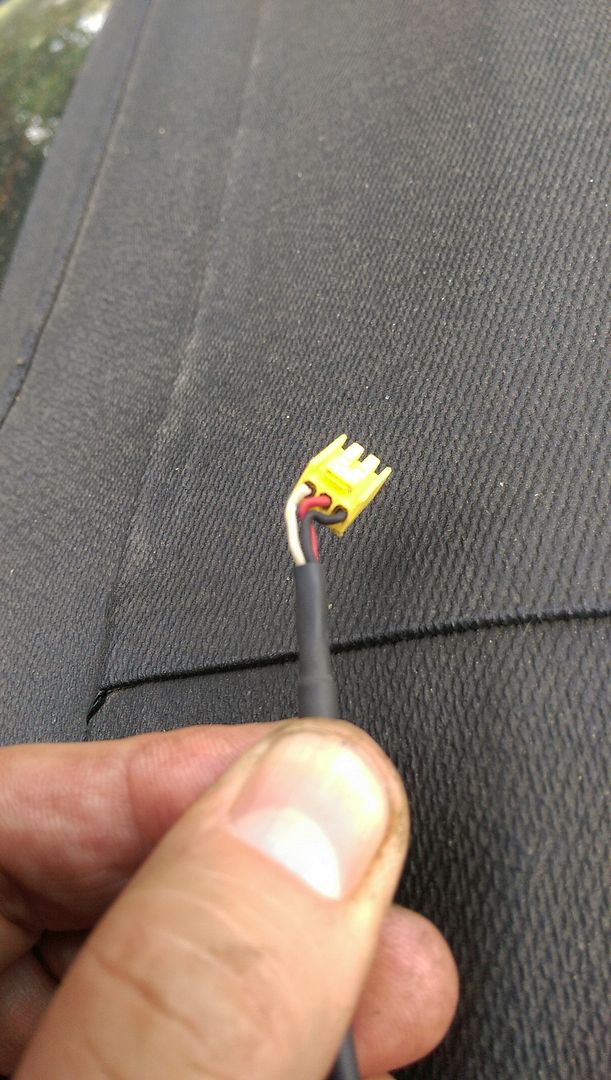

The USB  cable came with the ECU. I noticed today that the pressure sensor cable going into the ECU all three wires are loose from small yellow plug! I now need to find the wiring diagram and secure them.

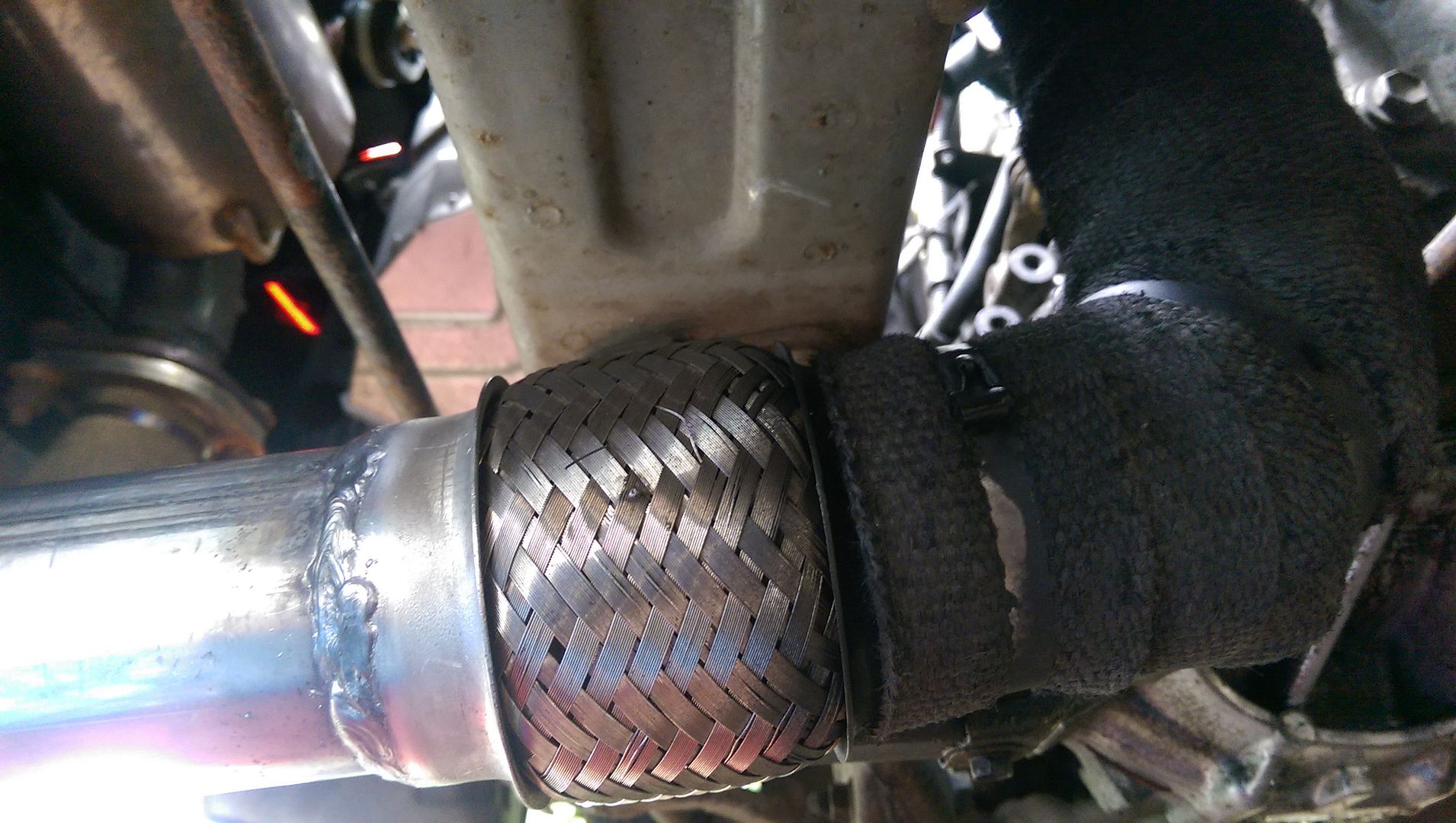

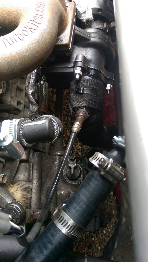

Another 1/2 day spent on the yesterday. Finished and fitted the downpipe, wrapped and sprayed it to try and manage the heat.
Filled it up with oil & water, put battery boost pack on and it fired into life but would not idle. So now need to connect the down pipe to CHE exhaust and sort out the front mounted radiator for the charge cooler. Once this done then I should hopefully be able to get the E-manage to work properly.
