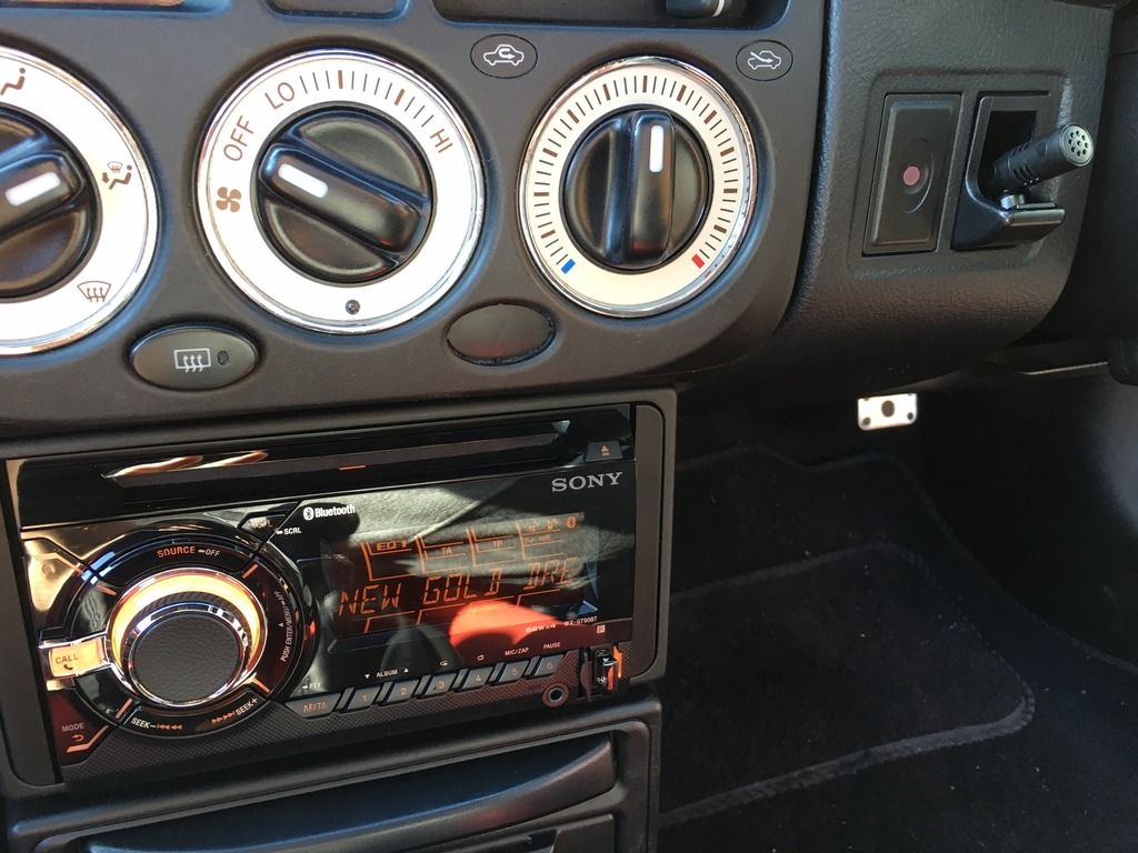

Fitted a new Sony WX-GT90BT today and fitted great with no issues. I have fitted mic into the coin holder after drilling a small hole in it to feed wire. Think it looks nice and tidy.
Quote from: "Scottie"Fitted a new Sony WX-GT90BT today and fitted great with no issues. I have fitted mic into the coin holder after drilling a small hole in it to feed wire. Think it looks nice and tidy.
I wonder how the reception is from that angle. It does hide it away nicely
Scottie
It works fine there,phone calls clear.

same radio , same mic location but in a blank plate and 1/2 recessed.
works perfect , can talk at 70mph no problems.
Scottie what additional wires ect did you have to use? The store said it may not for my car but then I saw you picture! Do you have pfl or fl?

You'll need all the normal things when fitting any radio into a japanese car.
Toyota to ISO adapter for the wiring. or hard wire it, there's a guide somewhere as I used it.
a surround for the front if you don't have PFL one from the factory sony model.
