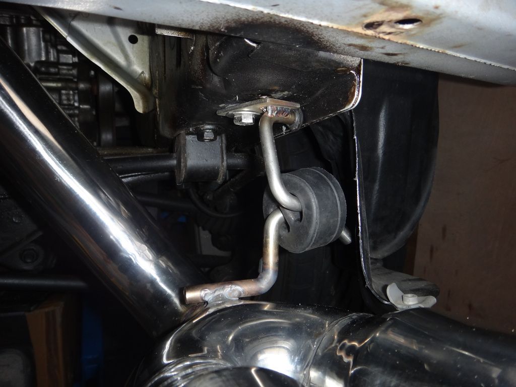

Ok.  First what you should have included a bracket and rubber hanger.  The one I first received was not correct and was replaced by Cobra.  See later pic.  This has been an issue for years and some only use the 3 hangers without issues.

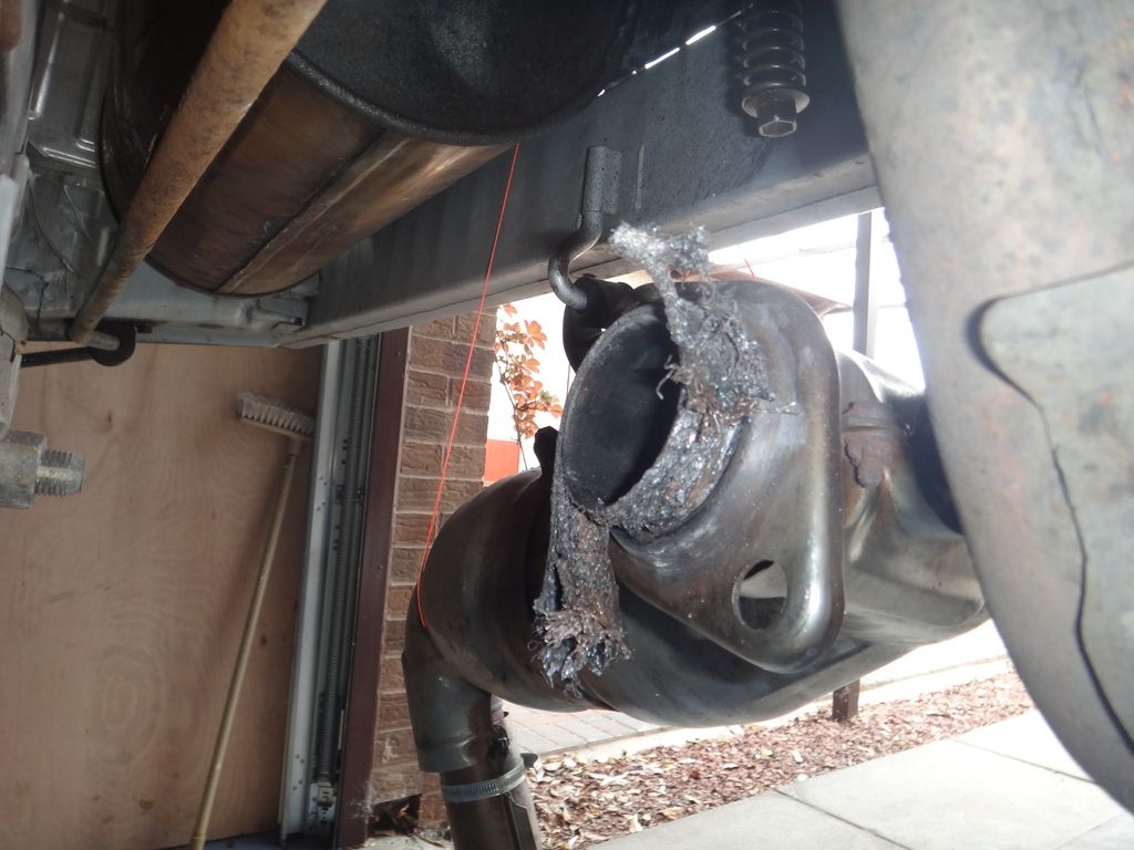

You need to remove the old gasket from the cat, which needed a bit of effort:

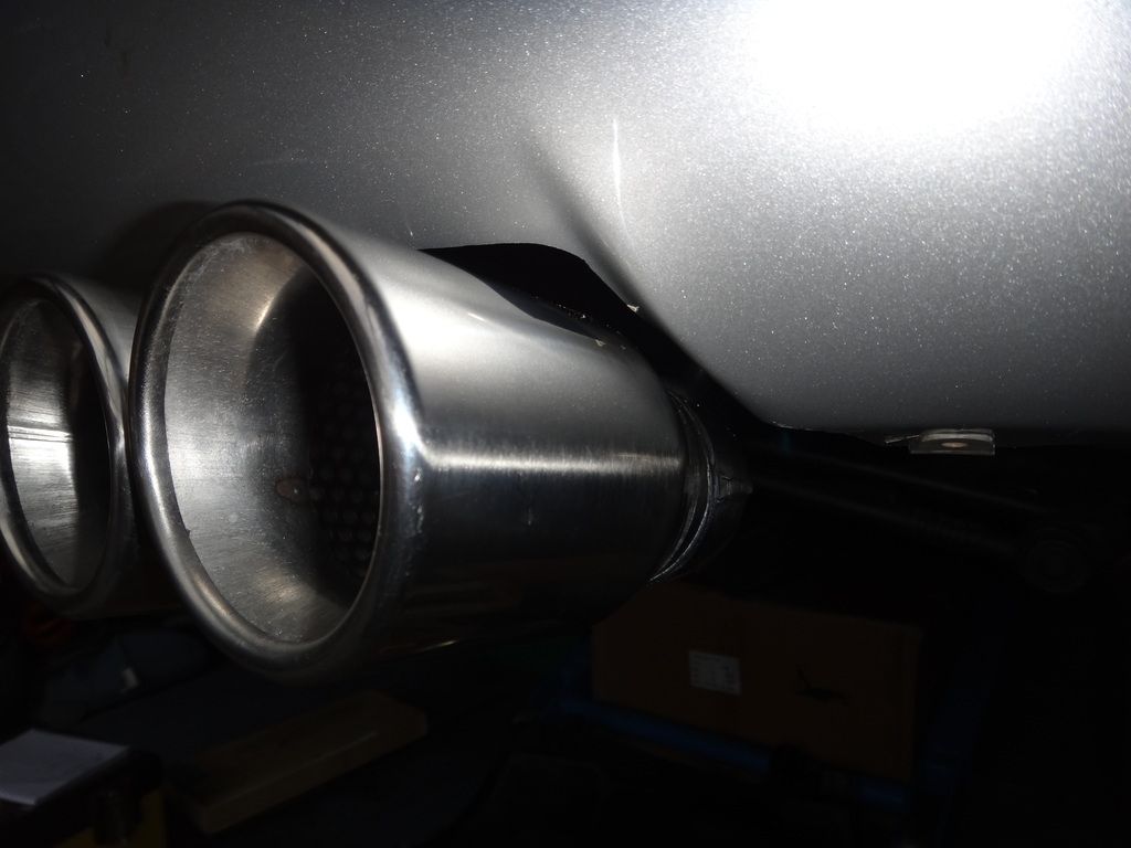

I then cut the bumper on each side:
This is where I fitted the new bracket, but you can see it does not support the pipe:

You will not get a good seal without a new gasket as it crushes to fit and it does not have to be that tight.  The old gasket is probably like a weld and the profile of the old pipe.
