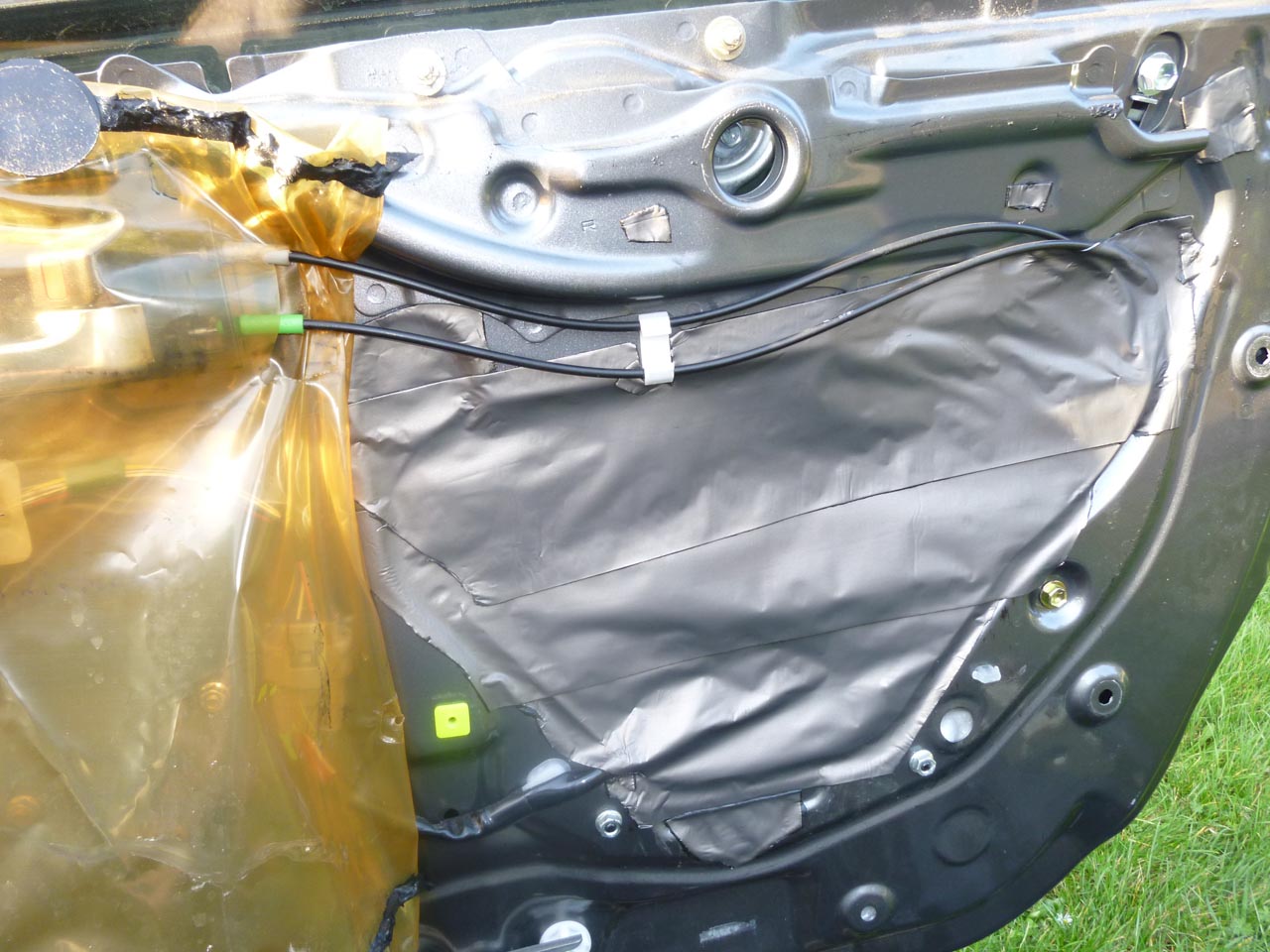

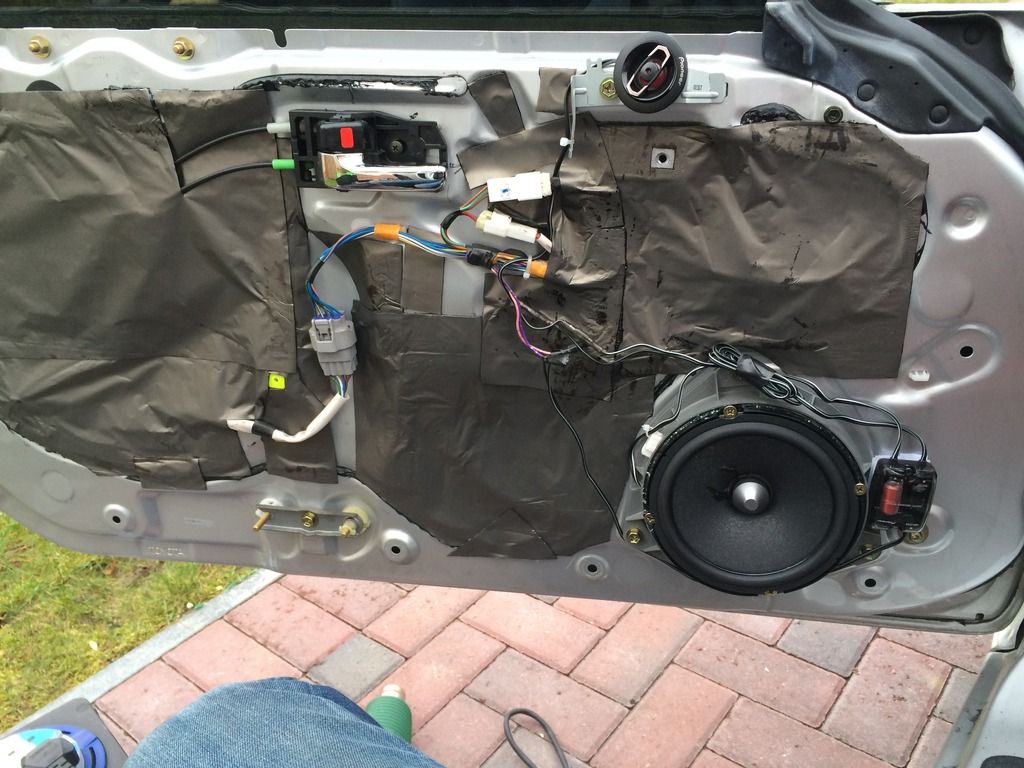

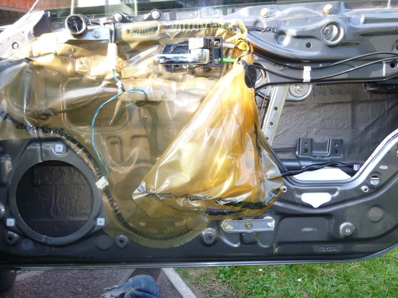

I only used flashing tape and was happy with the difference it made for £12... However, dynamat will obviously make a lot more. No issue with it sticking but I did it on a 25oC day. Here's an idea though:
Inside:
Outside:
Membrane back on:

I'll probably be looking at a hybrid of those Stu. The dynamat type stuff I have (can't remember what it's called, but it's from Amazon and looks the same) will go happily then on the outer skin. I'll think about the inner later.
