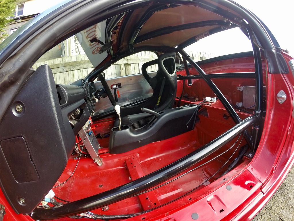

Here's my PP full cage - you could go better still and add some additional stiffening plates.

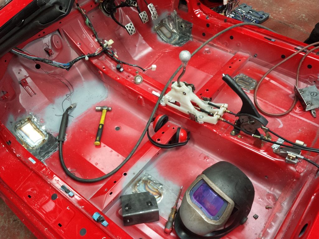

It's the additional work required to the Roadster chassis which is where a lot of the labour goes. There's 4 plates in the floor which need to be cut and welded in, the 4 foot mounts, the plates on the rear bulkhead etc...
Space is also an issue, the PP is less intrusive and almost better designed for the Roadster compared to the other options available. I'm 5' 11" and it's still not the easiest thing to jump out of (not helped by my seat choice admittedly..!)

As Hamish says, the PP cage is great, fits well and no issue with scrutineering as it isso well known.
The only reason I didn't go for it was because I am 6ft 3 and the rear diagonal at the back of the drivers seat intrudes slightly on the amount of rear seat space. I had to get a custom one made which worked out at a similar price to the PP cage (plus paying someone to fit it).
P.S. Just remember if you are fitting a cage to comply with the mr2 championship rules and you go for a custom cage you must make sure it has no extra cage bracing to the turrets at the front and rear, as  the rules stipulate a 6 point cage not 8.
