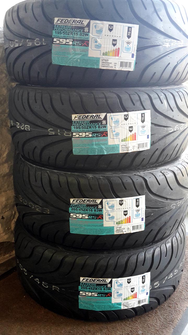

Not a huge lot to report on this but did get a few nice days over christmas to give it a good run out over the tops, she is all running nicely so time for the new rubber which arrived yesterday from Camskill,  my local tyre guy fitting them onto rims today so should get them on tonight :D....track day looming i think :)
Pic below....
I'm really torn between these or another set of my beloved AD08RS next time

Ive used both tyres and for the price the Federal RSR is hard to beat for grip, these cost me £260 for all 4 tyres ( 2 x 195/50-15 & 2 x 205/50-16) whereas AD08's where going to be £100 more in same sizes or £160 more in stock sizes, I find the Federal has more grip but the Yoko slightly firmer sidewalls and maybe longer life, for what I do with car though I think Federals are best (road/sprint/trackday) and cheap as chips :D

As you have found RSR is not available in stock FL sizes but ive gone for 195/50-15 front to give more front end grip I feel car needs, rear ive gone 205/45-16 on rear which I think will give plenty of grip, especially on stock engine!, rolling diameter/circumference is slightly reduced over stock sizes but its same amount front and rear (-1.3%), this gives small reduction in gearing so faster acceleration/lower top speed and I must say on short test drive car did feel a little more sprightly, might just be because I hadn't driven it for a week though and need a dry day to get it out for proper drive.
