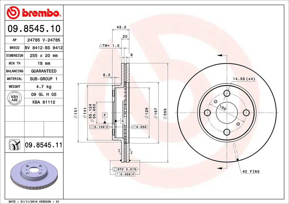

For 1 kg each side id be all over this. If we can get anybody to draw a rotor hat so that we can fit floating discs I can look into making them locally. We can save some more weight for sure.

Quote from: Nvy on June 25, 2023, 06:44For 1 kg each side id be all over this. If we can get anybody to draw a rotor hat so that we can fit floating discs I can look into making them locally. We can save some more weight for sure.
Moddifying the hats will not pass technical inspection here.

Quote from: Nvy on June 25, 2023, 06:44If we can get anybody to draw a rotor hat so that we can fit floating discs I can look into making them locally.
Sent you the details specs/drawing by Brembo. There is not all thát much weight to be gained.
