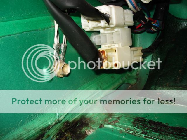

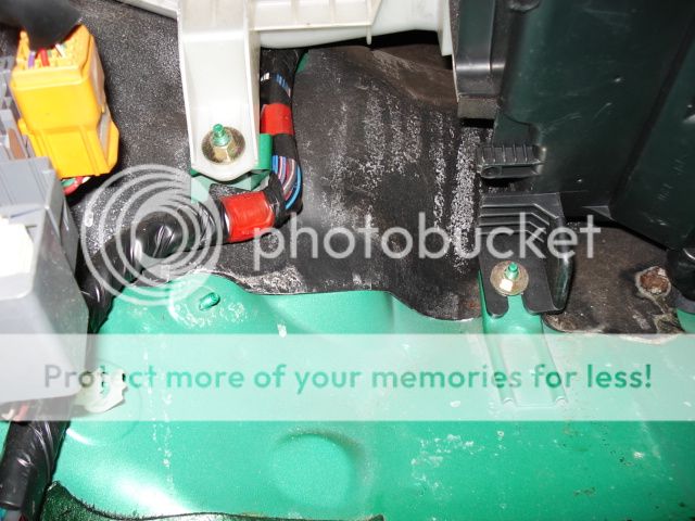

A pic taken of the passenger side front bulkhead shows white-ish lines on the plastic.....could that be water or condensation running down?
Any suggestions as to where ingress could be?
The front firewall/bulkhead has a couple of bungs in it from memory. As you have the carpets out have a scout around that area.
I have a piccy somewhere if you get stuck.
As Stu says, in the passenger footwell bulkhead, under the fan blower box there's a grommet (or should be) that goes straight through to the frunk compartment. I've got cables through mine so should definitely be there, failing that it could be the heater matrix leaking but with that amount of water you'd expect to see the level loss in the expansion tank.

Had a look.  I can't see any holes without a grommet in.  Lifting the liner that drops down the front bulkhead I felt the sound deadening material & it is dry, - no signs on the paintwork of any water stains.
