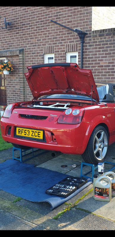

Oil service and final checks done before Donington tomorrow. Cant wait!

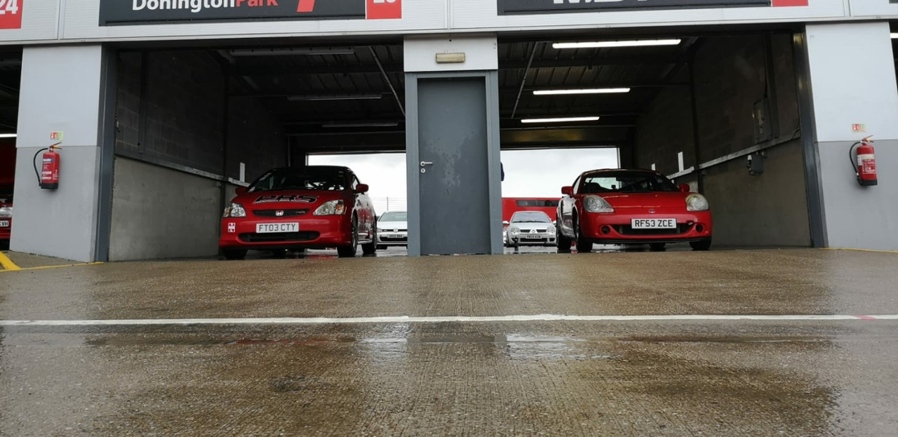

Mixed day at Donington on Friday. Track was wet and very greasy and with that came lots of red flags throughout the day.
A Clio 182 rolled it half an hour in leading to near an hour delay. Then a few more short red flags before dinner.
Then the session after dinner someone cut their finger off in the garages so the ambulance had to leave site to take the guy to hospital leading to a near 2 hour red flag. The session only restarted at 4:15. Then 10 minutes into that 2 cars binned it leading to another red flag.
With all that I still enjoyed the track day, and learned a lot, mainly car control. I did manage to get one session on my AR1's. Highlights below.
This was the session after dinner and thought it would be OK on the near bald AR1's, its wasnt! Car was all over the place and a nice 360 spin at the end.

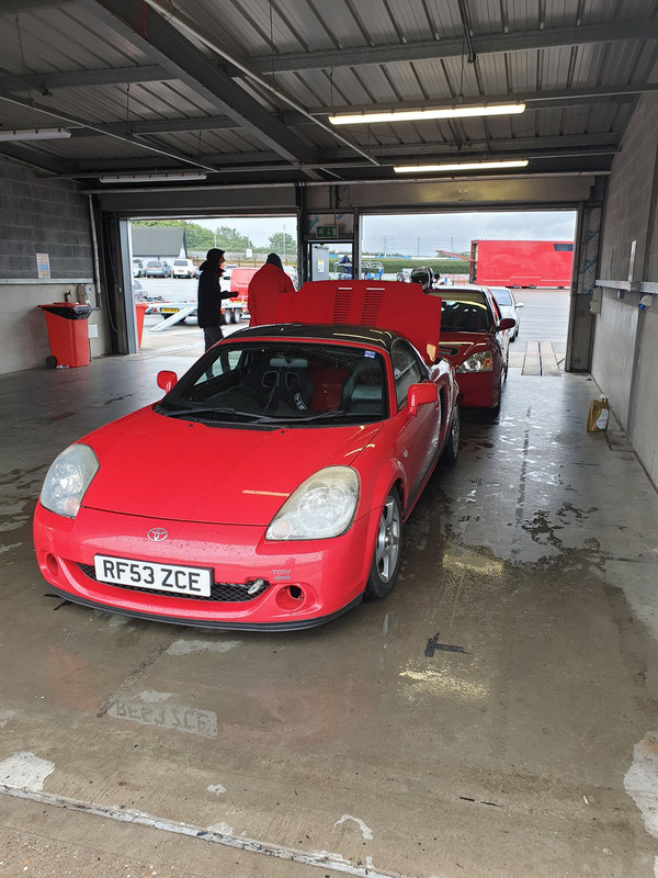

Few (crap) pics from the afternoon were we managed to find an empty garage.

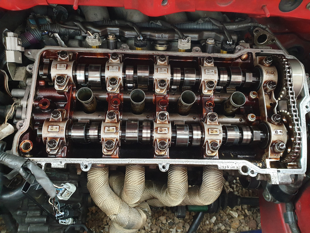

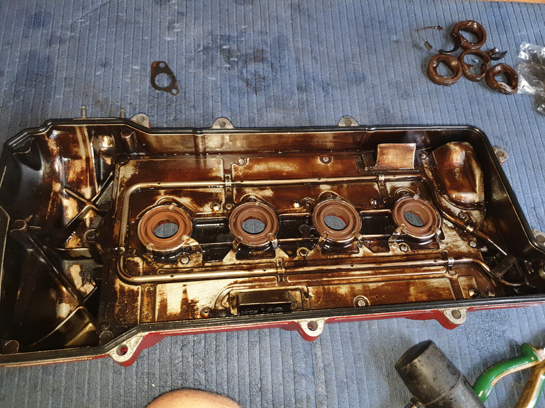

Spark plug tube seals changed. I was getting oil down the tubes so thought I'd change these out to see if it worked.
Worked a treat! Old seals were very hard and brittle so probably factory items.
Also gave me a chance to take a look at the cams after the top end rebuild back in December, 2k miles ago.
All good! No scoring or pitting.

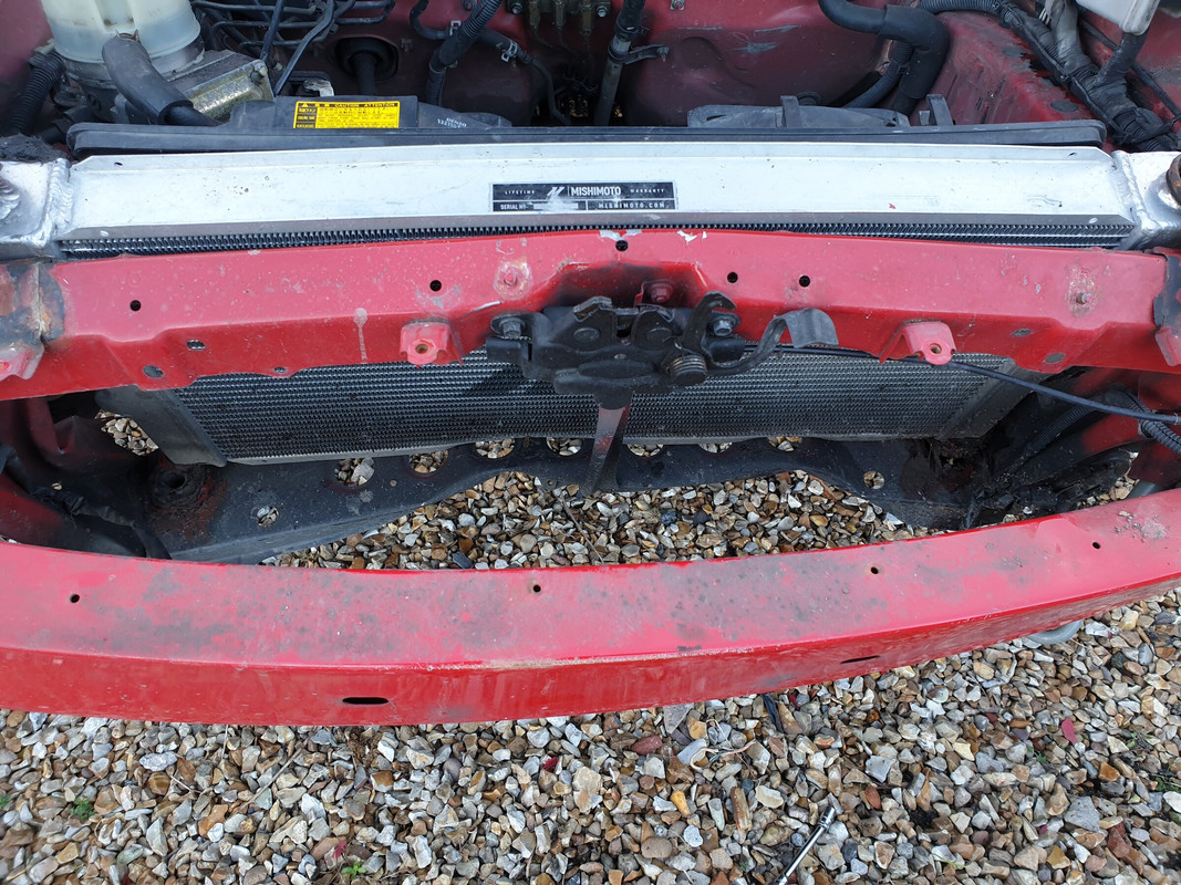

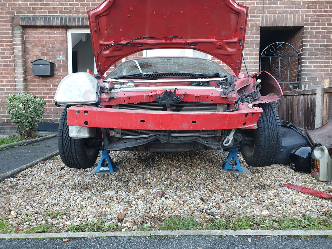

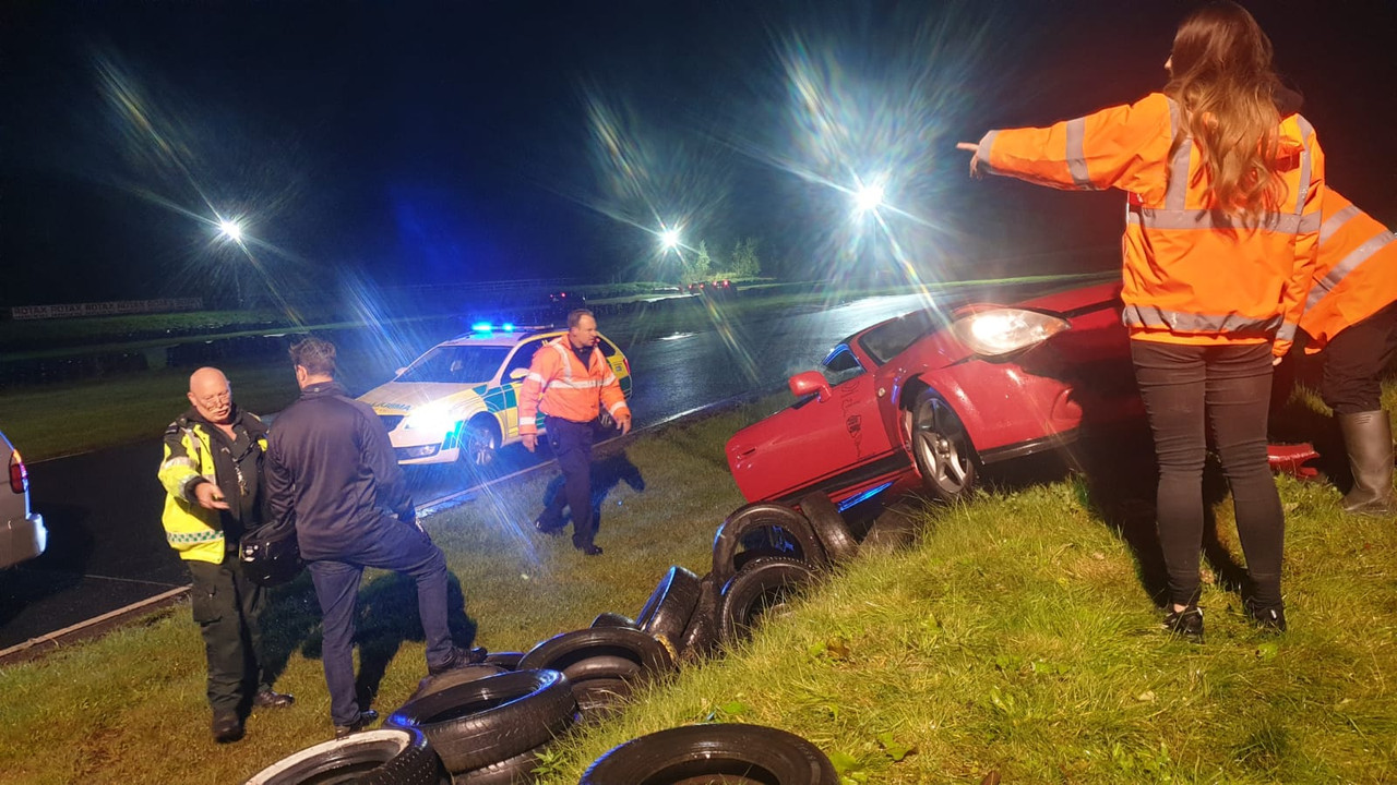

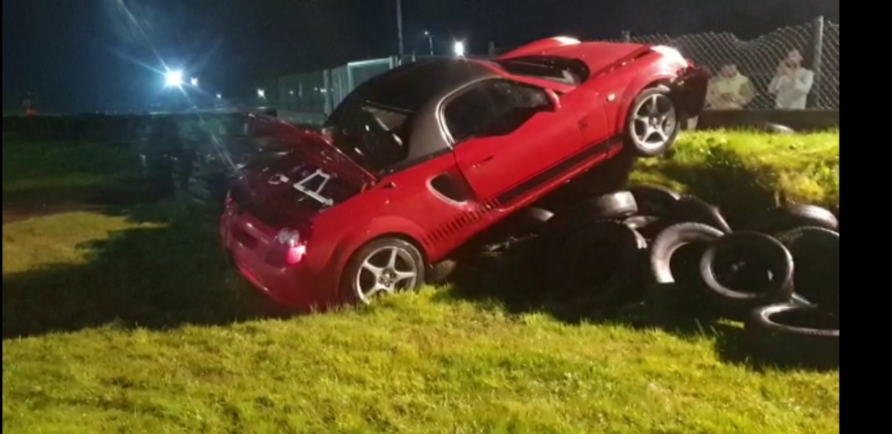

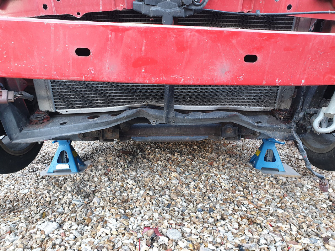

Well another set back for the 2ZZ...
Luckily not to much damage and nothing structural. Front radiator cage had been pushed back pulling the front cross member back with it. Also the tow eye had been caught and pulled the front crash bar back with it. Unbelievably zero damage to any of the arms, wishbones, suspension etc. Car drives straight and true.
