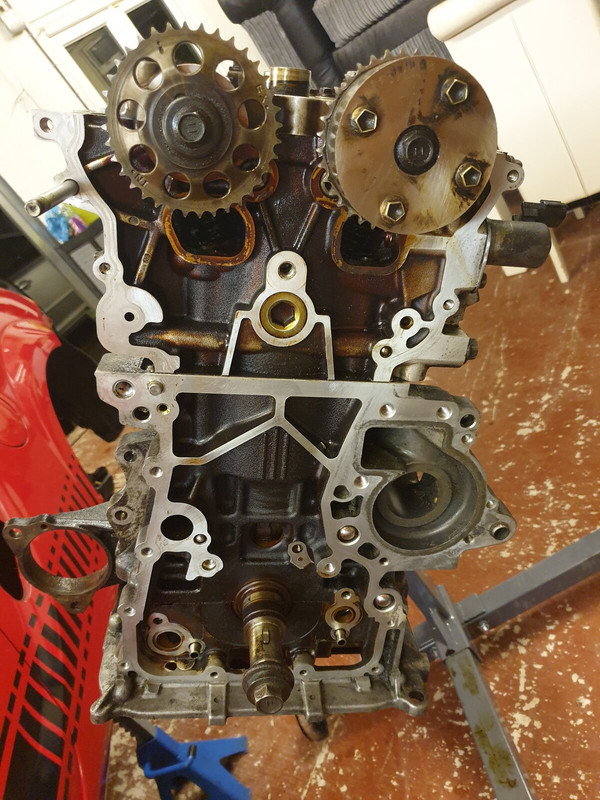

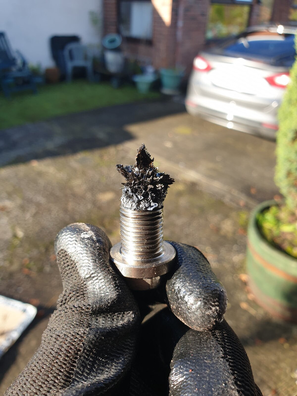

Not updated this in a while, a lot has gone on with the car since my last post which was about attending Oulton Park in September 2019. Unfortunately the bottom end gave up due to low oil. It was an incorrectly spaced dipstick from Rogue Motorsport that caused it, proper school boy error from them and I would have picked up on it if I'd have serviced the car when I purchased it, oh well...

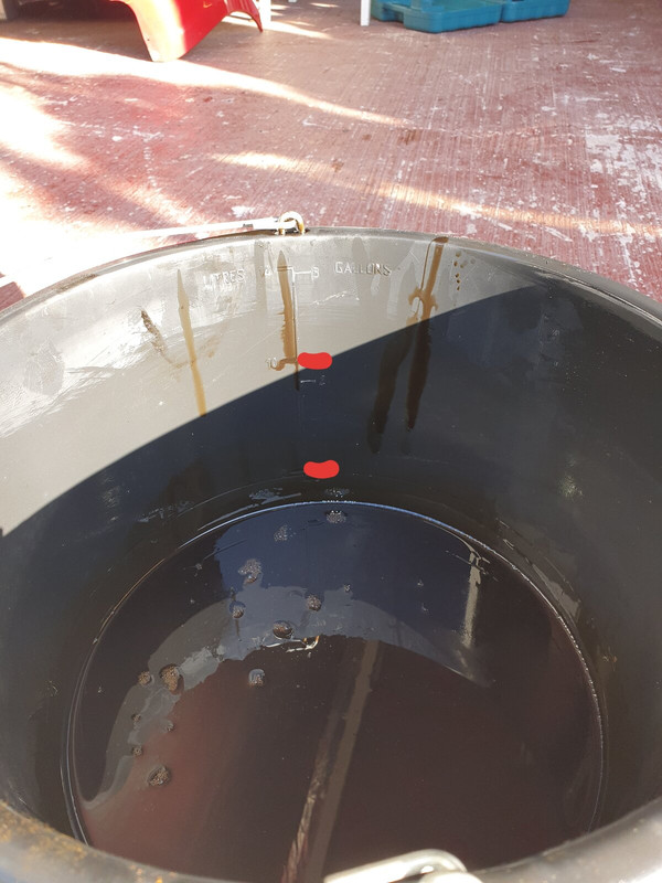

Only 3.5L of oil came out  :'(
Bottom end shards

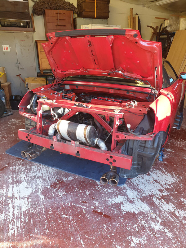

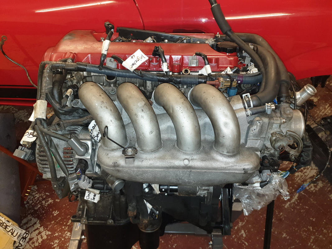

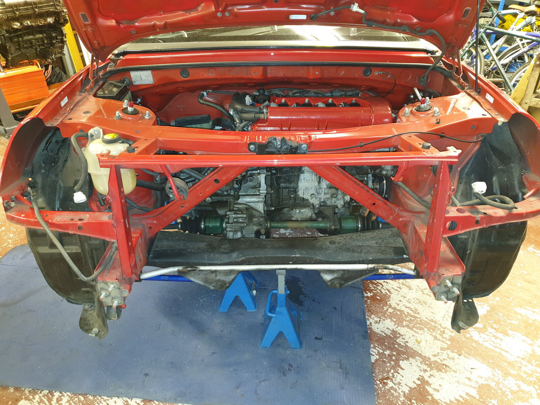

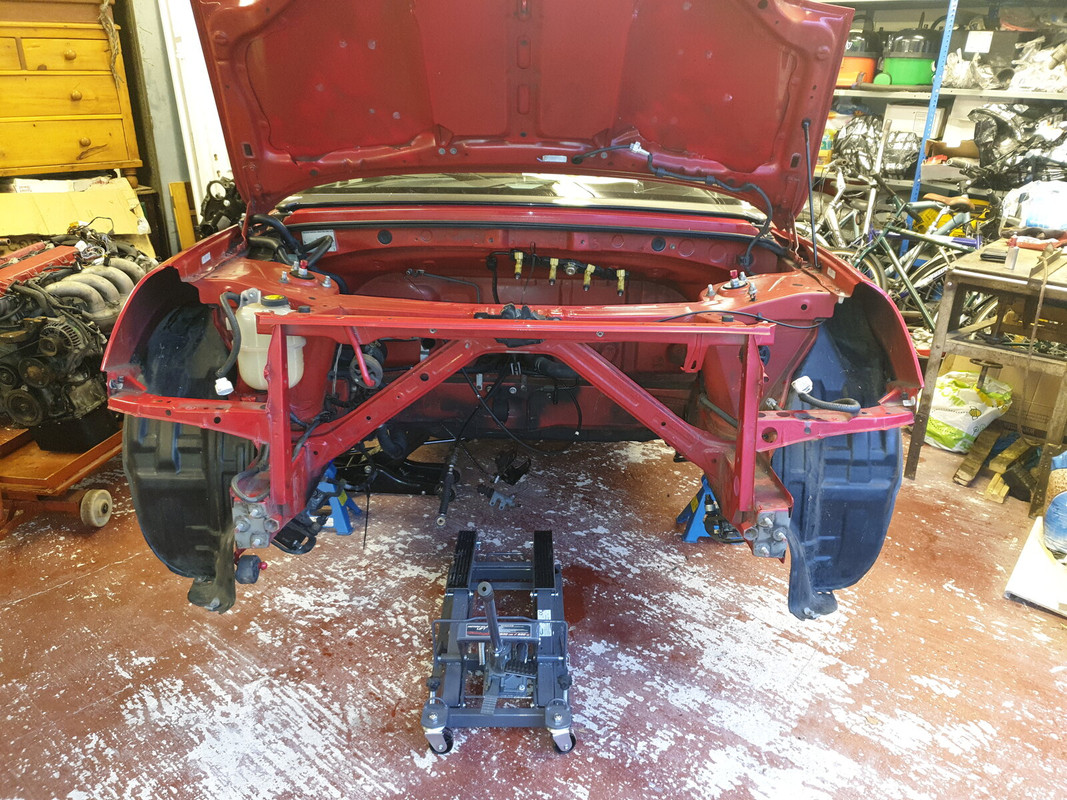

So sourced a used bare engine and attempted to pull it apart and rebuild it. This was my first time fitting an engine and first time opening one up to service/replace parts.
Getting my boy involved in the swap

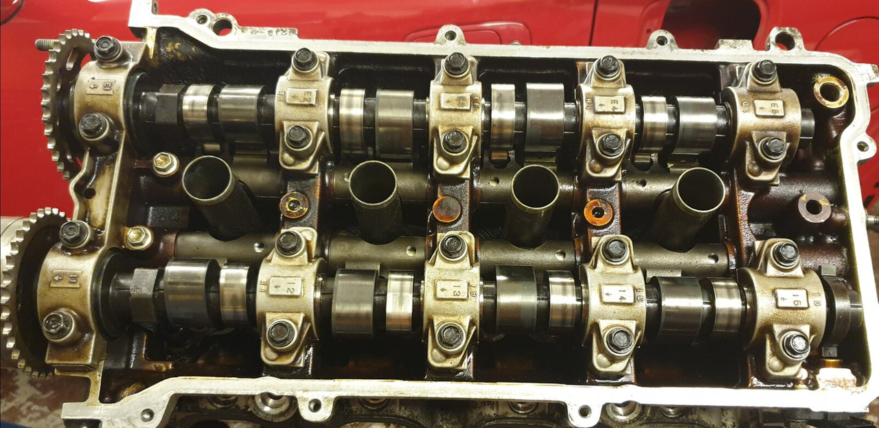

Head of the used engine looked a bit minty. Looks like its been ran on non-synthetic all its life.
All cleaned up and head parts from the blown low mileage engine transferred over. Cams, cam caps, rockers, rocker shafts etc..
Prepping the engine for a chain service.

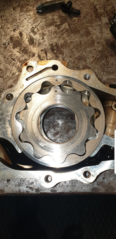

Billet oil gears were toast from the old engine.
New (used) engine all back together.

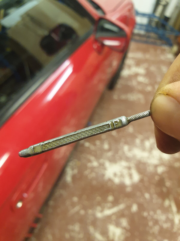

Where 5L of oil came up to on the Rogue spaced dipstick, my thumbnail  >:(
Moment of truth, first start after the rebuild/service. Dropped a teaspoon of oil down each cylinder to help lubricate them for start up as I didn't know how long the engine had been stood.
Corbra box shat itself on start up  :))
New engine has now done 4 track days and 1500 miles, most of those miles at 8k rpm and its not missed a beat with very little oil usage, couldn't be happier for my first attempt.

The amount of time I took to check, re-check and do it all over again on every thing I done was crazy. Really enjoyed it though and as you say I now know the car inside out...literally, lol.
I reckon I could now drop and re-fit the engine in a weekend on my own.
