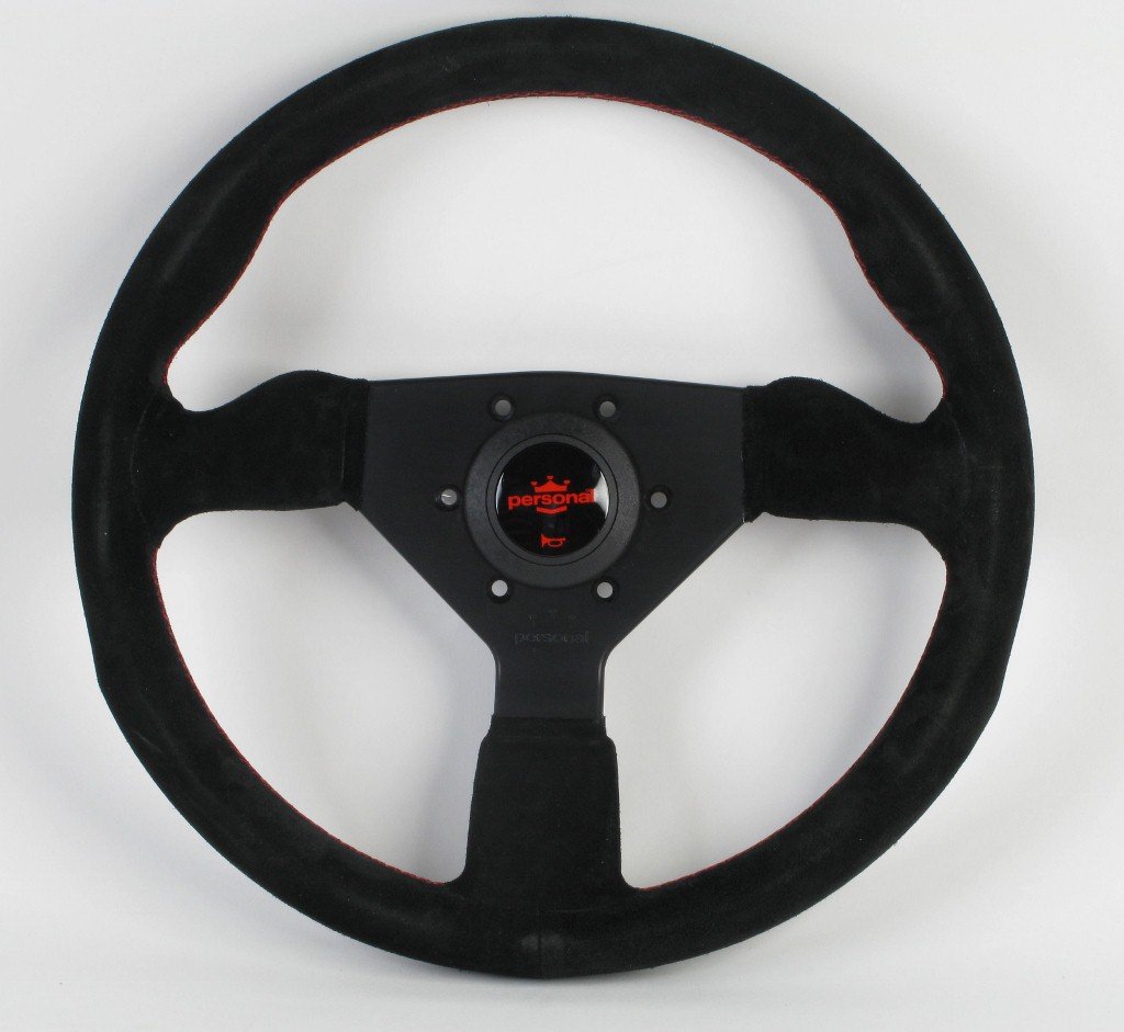

I'm using a 350mm Personal Neo Grinta in suede.
Not had any MOT issues, as the Momo boss I'm using comes with an airbag resistor.
I did have the same wheel in 330mm prior to this, but found it a little small for my tastes, so sold it and bought the 350mm version:

That does look nice and subtle!
I was just reading somewhere that if the car had an airbag in the original wheel, then it's an MOT fail if it's not present. Are you going somewhere friendly or is that just plain wrong?
Nice tip to get one with the resistor built in
