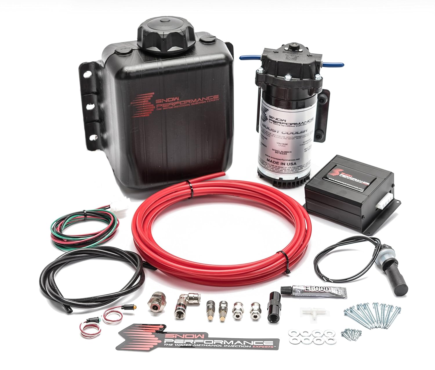

As to weight, a water injection system weighs vary little. You could even use the wiper washer reservoir and fluid.
It is not complicated to synchronise the refilling with stopping for petrol.
The vintage water injection systems had a low pressure, 3 psi, pump, the new ones 200 to 300 even.
Nauhgty nutters have used these systems to add nitromethane/methane rc mix. This both cools ánd adds fuel/oxygen.
It works and is´safer´ than petrol, unlike NOx which additionally sits in you car under high pressure.
The stuff is freely available through rc shops. The EU regulation prohibits over 25% nitromethane but up to 30% is sold. Although not cheap, it is cheaper than NOx.
If using the system to boost with rc combustible, then it needs extra switches to make sure it only adds the fuel at higher revs and a lot of throttle.
It works, is fun, max 5-6 kilos incl. full reservoir, but not a lot of extra oompf.
I had an akin system working on butane gas on my td and thát made sense as it was about 25 hp.
As to expense a modern water injection (for n.a.) would be about 250€ and 350 if you want to adapt it to rc fuel.
New old stock vintage systems are still popping up and set you back 150-200€ as as such only makes sense if you want the simpler, lower pressure system. On a small capacity engine it does not work but on a big V8 it is very cflexible in application. Especially the Holley version which has all the safety switches you might want; water temp., oil pressure, inlet vaccuum, ignition, tps and all to be in serie.
This system from Snow is meant for n.a. and could squirt water, water/methanol, even rc combustible at under 4 kilos.
