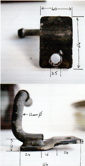

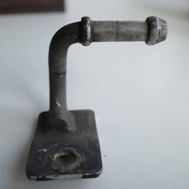

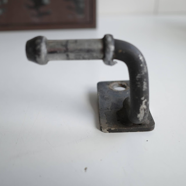

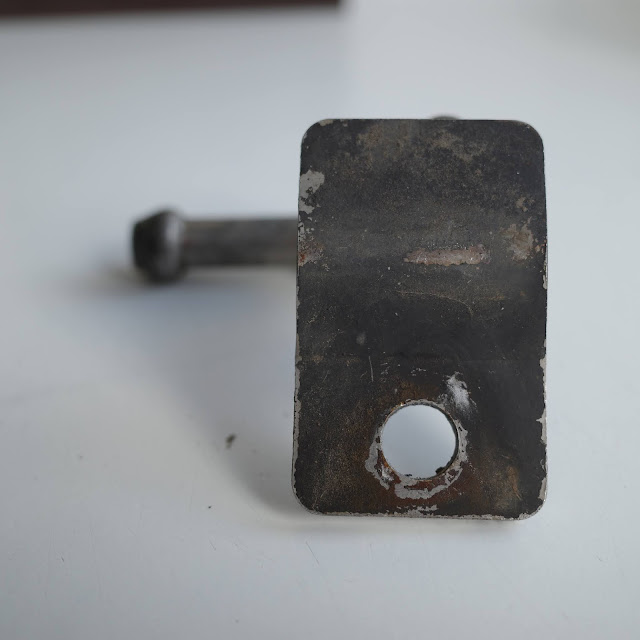

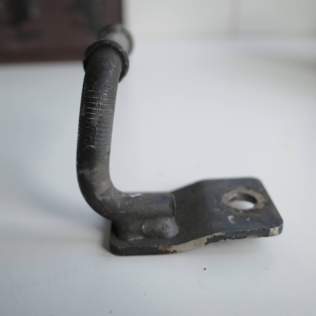

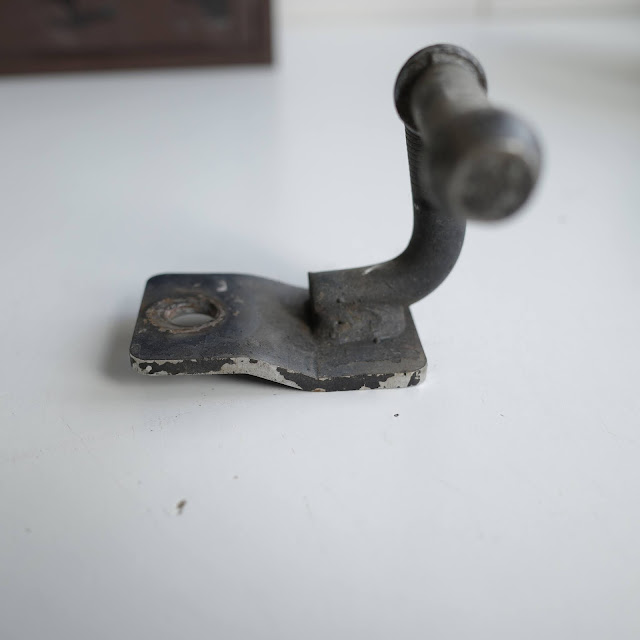

Hopefully this my come in handy sometime in the future. Have taken pics and also some measurements. Should not be too tricky to knock up, if you have the knowledge and kit.
The centre of the bar is 15mm in from the left hand edge. Not Central. From plate to bend is 60mm.
