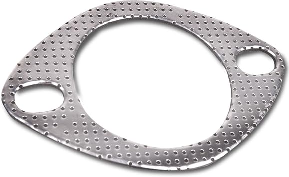

The manifold came with two gaskets. I've never used one before so have no point of reference for comparison.
The material looked like this:
Your garage doesn't know the  1zz engine. If they did they would have re-used the o/e manifold gasket, - it's common practice to do so. If you can I'd get it back from them.
That type used in the cat joint won't last long.  I tried using one & it lasted hours only.  Look up 'crush rings' & if you still have the o/e manifold you'll see the recesses that the crush rings sit into. The type you pictured is designed to work between two flat faces with no recesses.
So you're now thinking 'shouldn't Toyo supply a proper gasket?'  Yes......

The O2 sensors are easily damaged when removing....I've not read an explanation, but it's oft-stated.
Or it could be the man/cat gasket has failed.  I think I did less than 100 miles before mine started to go.
As said above, feel around the joint on start-up.
Crush rings.... https://www.ebay.co.uk/itm/Genuine-AJUSA-OEM-Replacement-Exhaust-Pipe-Gasket-Seal-19003400/232899021405?ssPageName=STRK%3AMEBIDX%3AIT&_trksid=p2060353.m1438.l2649
Some will say they won't work with recesses only on one part (your cat). But they can successfully work. I've seen the suggestion of using exhaust paste surrounding them.
