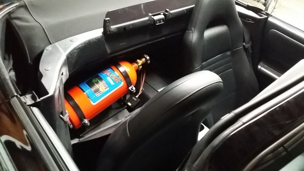

Quote from: 1979scotte on November 29, 2020, 11:56Nope you can't do it its too heavy.
All is relative; it weighs as much as the airco pump so could do a swap. Also used to have one of these in the back:
Puts the added risk in perspective too doesn´t it   ;-)

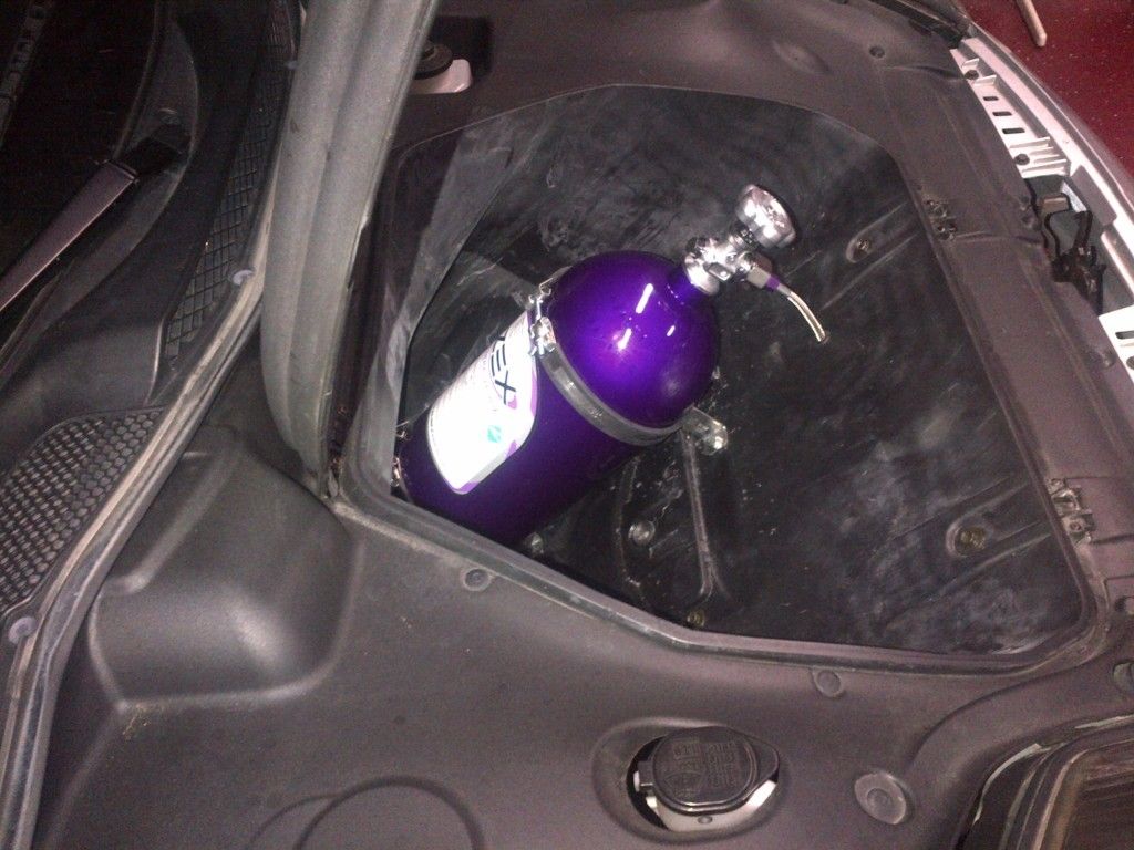

If you must, and I can understand with your national regulations, please put the bottle in the frunk?
Quote from: Carolyn on November 29, 2020, 18:06If you must, and I can understand with your national regulations, please put the bottle in the frunk?
It´s an ideal location for fitting the bottle oriented idealy too.
Lead underneath the car and with a provision for remote bottle opening. Pondering on that.  Not keen on having the lead live all the time. Still have the solenoid I used for the bl@@dy big gas bottle sómewhere.
Not a done deal though Carolyn. Want to tap the gasoline off at the push on quick connect at the fuel rail like
and to my surprise it is not that a common thing. Seems an obvious and reliable thing to do unlike the T-fittings I encounter all over.
Just realised that without the wheel bucket, the bottle mounted directly behind the radiator makes it heated ;-)
At 36 degrees C, N2O becomes a super critical fluid, which can behave very unpredictably. Very complex and potentially dangerous territory.
Have you thought about how you're going to purge the line quickly?

QuoteAt 36 degrees C, N2O becomes a super critical fluid, which can behave very unpredictably.
Better be more unpredictable still ;-)
