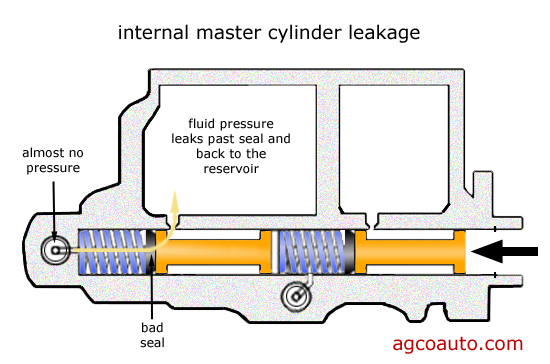

Found a tip online stating if when depressing the pedal to the floor, the fluid in the header rises this is a sign of an internal seal leak, as the fluid isn't transferred down the line, but back into the header, which does make sense, see below.

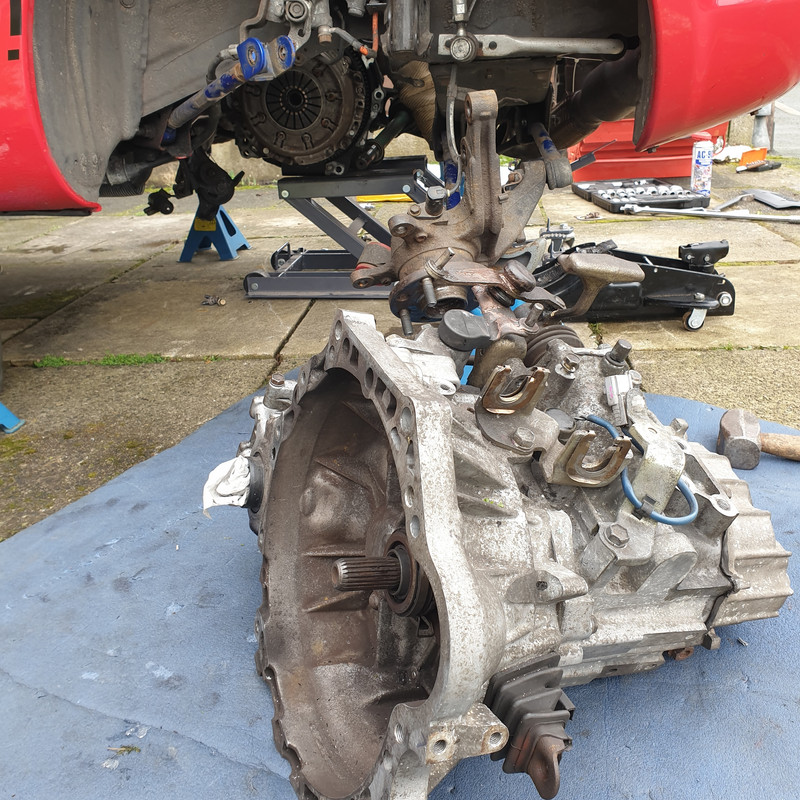

The issue...
Was fun bench pressing the gearbox out on my own.
Yep it's broke! (What's the lump hammer for?).

Will order a LUK 2zz clutch kit tomorrow. Clutch kit had only done 5k miles too. Rougemotorsports handy work again, fitting a 1zz kit with the 2zz swap. The only difference between the 2 kits...the pressure plate, coincidence...
