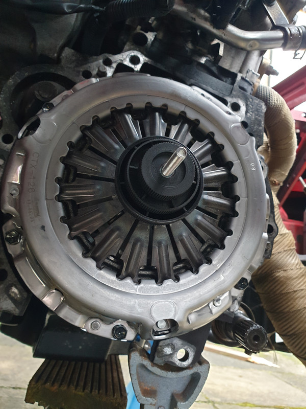

I reckon the disc hasn't seated because I used the universal alignment tool and kept it locked in place when bolting the clutch plate down, as below.
I should have just nipped up the plate enough so the friction disc didn't move, remove the universal alignment tool and then torque the plate.

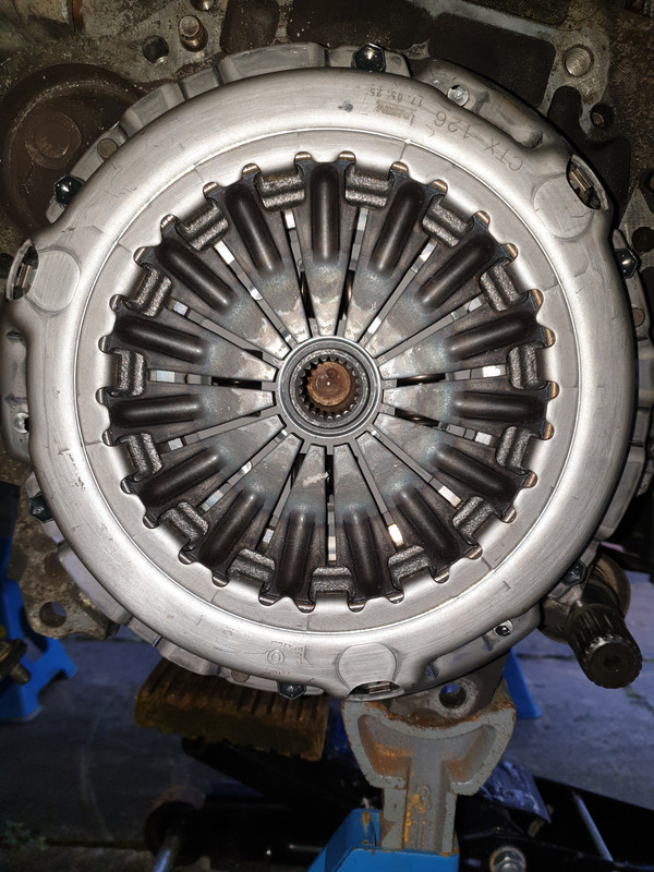

Maybe you've got the friction disc back to front.
Quote from: jonbill on January 31, 2021, 17:36Maybe you've got the friction disc back to front.
easily done!  and sounds most plausible.
We'll soon see, as its coming back off next weekend.

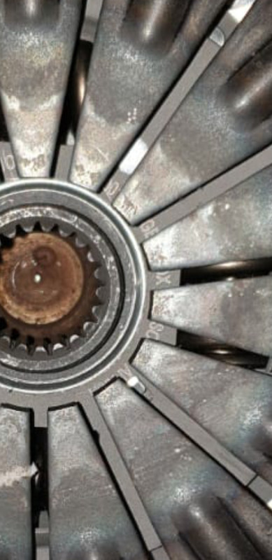

Found this in my camera reel, but had it off and on that much trying to centre it, i don't think this is the last shot before fitting.
I was conscious of the 'gearbox side' marker, and sure I double checked it looking through the fingers after removing the adjustment tool, but you never know i may have fitted it wrong.
