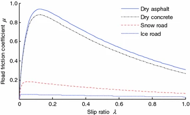

Have a look at the tyre adhesion graph:
There are many more and the values are irrelevant. It is the shape of the top that is the crux.
The only thing specific for the Spyder is the low moment of inertia, that it can go relatively quicker BUT it is off set by the largish wheelbase ánd the low pmi giving both more gip and allowing easier correction.
What the grip curve tells you is that grip does not plummet: If the front starts to understeer you cán still steer, even a bit more. If the rear starts to go you cán still smear it forward.
Ergo; do not panic and overreact.
