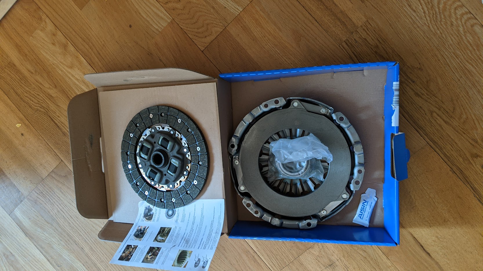

I found the product code for an Aisin Corolla SC clutch kit so I used this, the cover is different to the standard 2ZZ one.

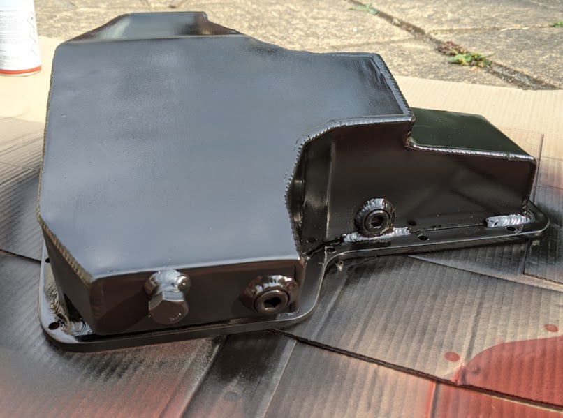

Big wing sump fitted but leaking very slightly so I need to refit

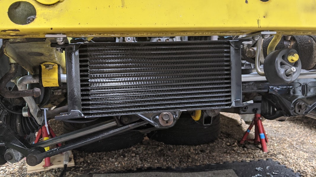

Oil cooler and Whiteline ARBs fitted
