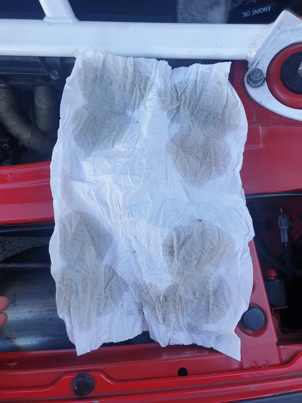

95% sure its the sump 🙃
Fitted the flywheel cover that slots in behind the narrowest part of the sump, then stuffed paper towel up around the sump join, and...
That was after just 10 miles road driving, oil only up to 92°c. Zero oil coming out of the bell housing like before.

Quote from: JB21 on November 21, 2021, 13:5895% sure its the sump 🙃
A much easier fix!
