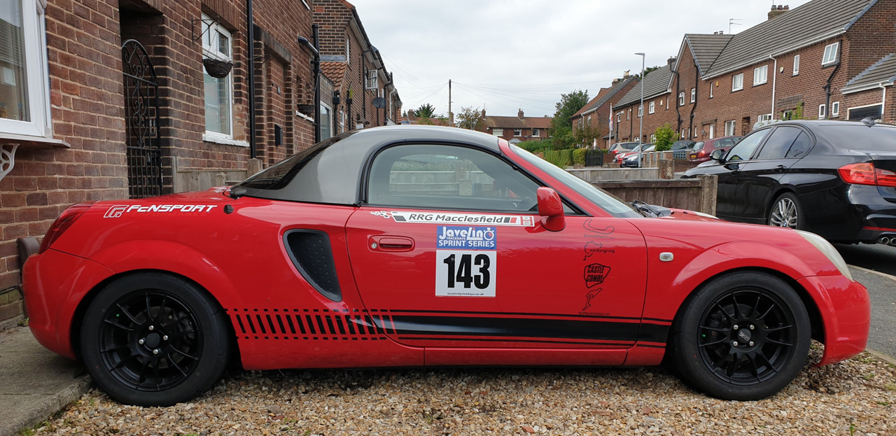

Mine isnt floaty at all, even at speeds over 110mph. Car is 950kg and all weight removed from the front, even the bonnet is gutted. I find this car handles best with parallel rake and as low as possible without going out of the roll center limits.
Its low but still usable on the road.
