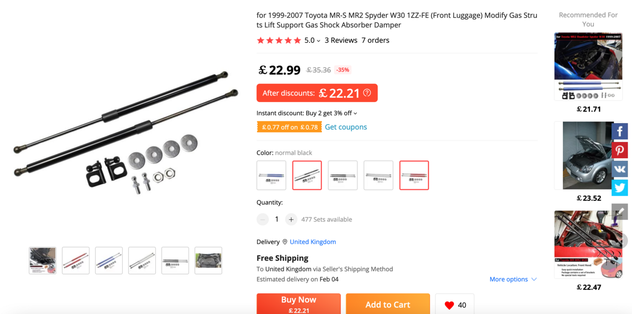

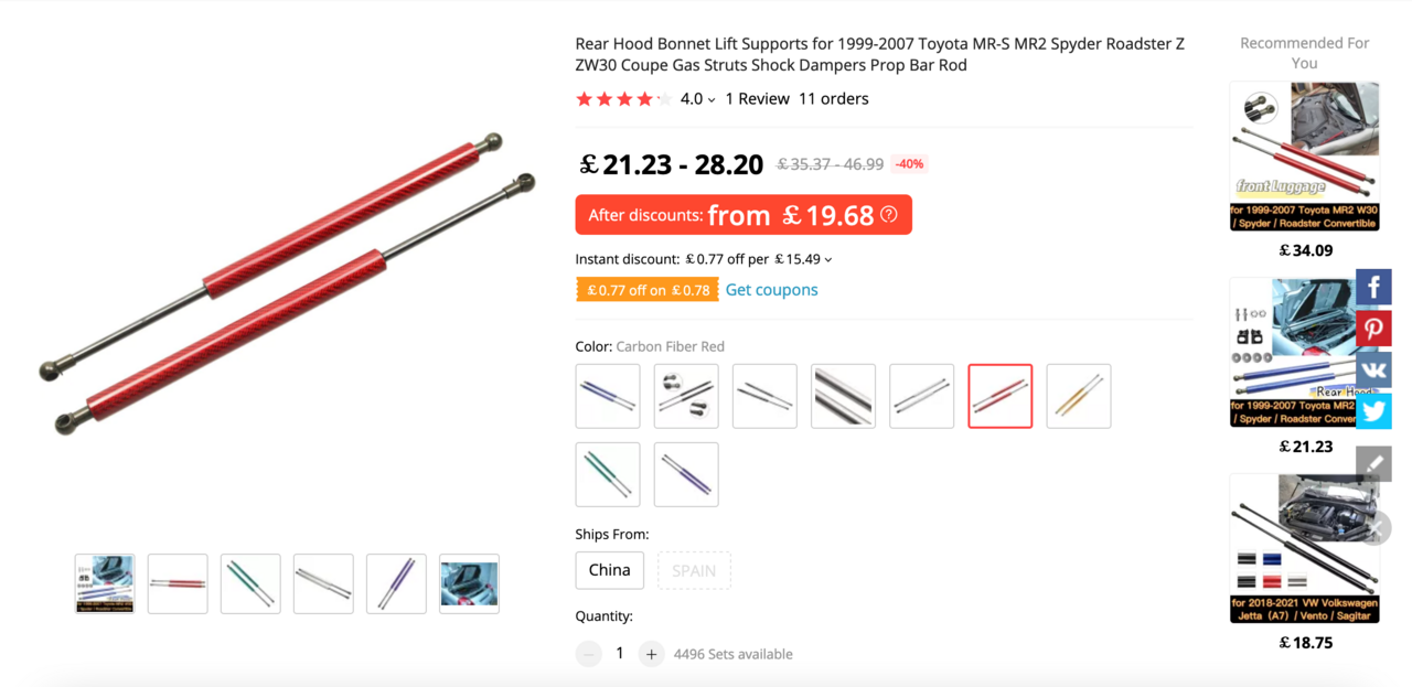

I was planing on putting this kit together myself,
once I came across kits being sold on Alixpress
https://www.aliexpress.com/item/4001172680153.html?spm=a2g0s.8937460.0.0.2dc02e0eaGmrGs
from £21 not worth the hassle of collating all the parts myself
My MR2 is Sable coloured with a red top, I'm not sure if getting red struts would go with mine or if I should just go for black, any opinions?
Edited to add: forgot to mention they do them for the front too from£23

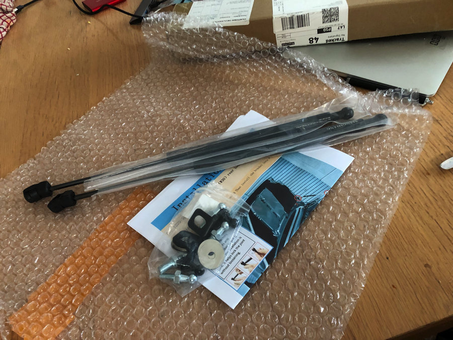

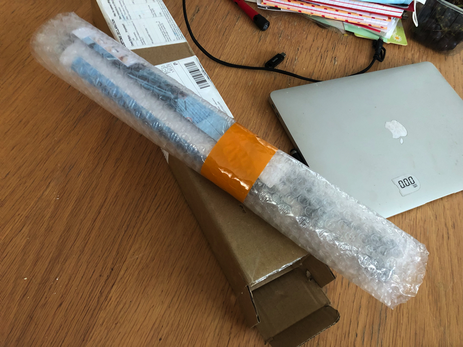

Had a knock on the door this morroning was the postie with a small packet, turns out the MR2's rear struts didn't take that look to get here to the UK,
I couldn't wait to see what they looked like, after all, for £25.50 that includes shipping and 20% UK VAT I wasn't too sure what I was going to get
I thought the struts were well packed for shipping

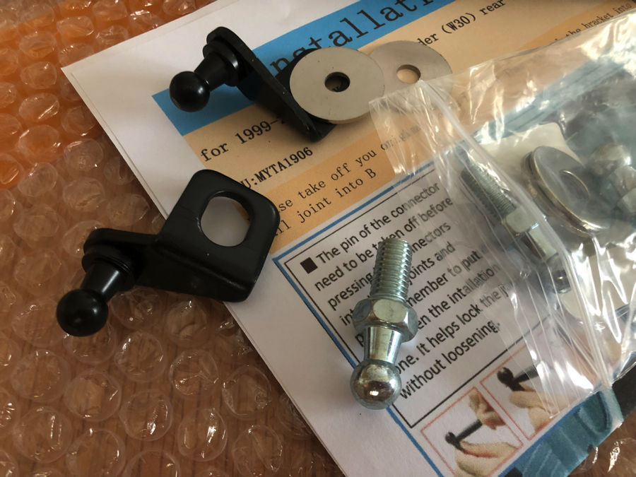

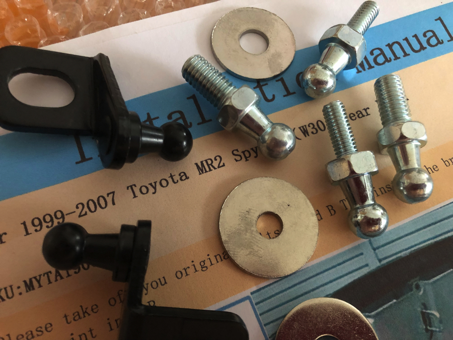

It came with an A4 instruction sheet and all the fittings

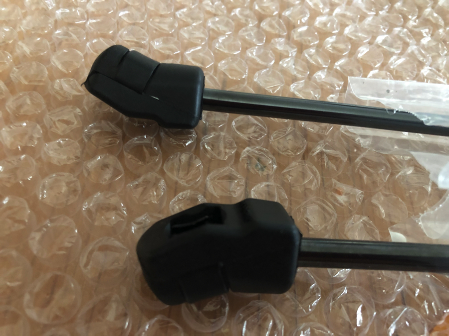

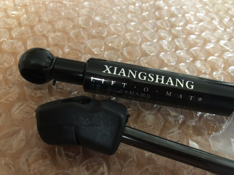

I should think these struts are all made in the same factory in China and the branding is placed on them by individual sellers
Either I got lucky and they provided more fitting than I need or they provide fittings for all combinations
