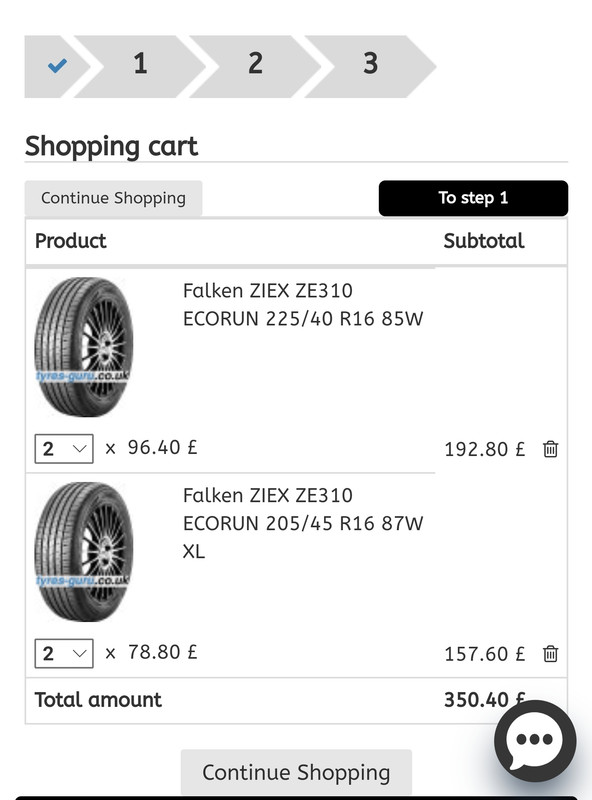

225 40 16 is a rare size. You'd be better with a 225 45 16. But if you're set on the sizes you mention then Falken do them.
https://www.tyres-guru.co.uk/cart
@JB21 , That's 2 hours 11 minutes since @SuperArt asked the question! What took you so long?
Quote from: Joesson on December  6, 2021, 19:02@JB21 , That's 2 hours 11 minutes since @SuperArt asked the question! What took you so long?
Haha I did see it earlier but work got in the way of my reply 😁
