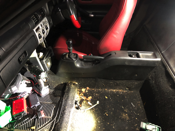

Our MR2 went in for it's MOT last week after standing on our driveway for a good 18 months (due to covid one car in the family was enough), it failed on three major things, a leaking damper, a coil spring had a hairline crack and the hand brake was found to be too slack, needed tightening

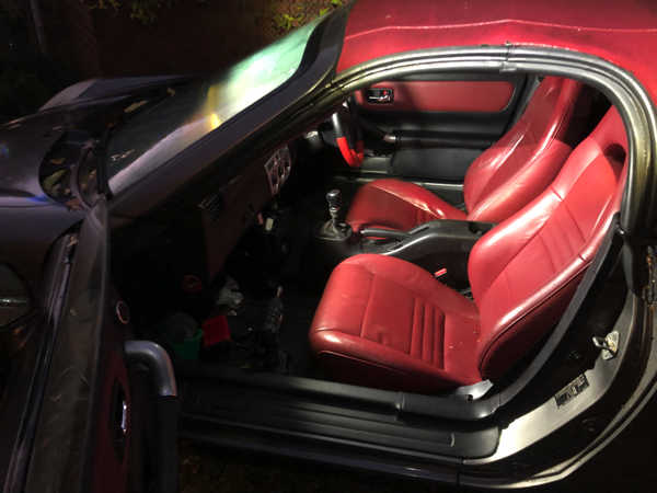

I thought handbrake was a job I could do so  after viewing lots of YouTube clips on adjusting the handbrake, I got down to it this afternoon

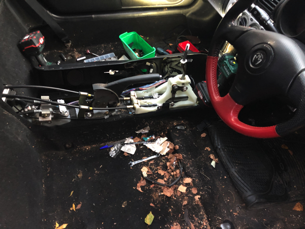

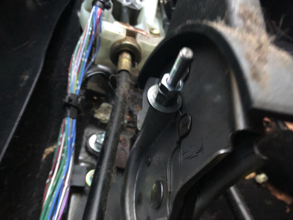

To get to this 10mm nut

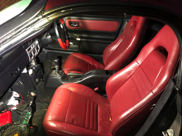

Then the work of getting it all back in
Refitting the self tappers back in I was thinking of replacing these Phillips screw heard for 10mm hex head, so that next time I needed to lift off the centre console I could undo the front ones without having to take out the seats but by then it was getting dark

Good job. There is a way using a swivel socket and extension to adjust the handbrake without removing the center console. I used to bring with me the socket to local meets and reset everyones parking brake.

I leave those front screws out, will put back in when i sell the car...
Zxrob
I cheat and take the seats out, makes things much easier ;)
