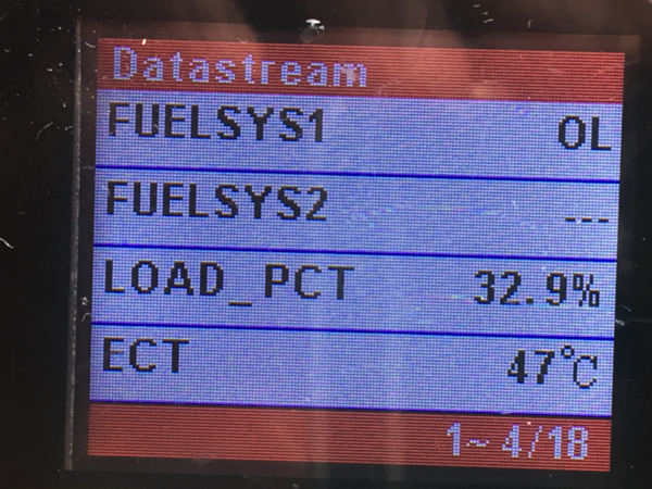

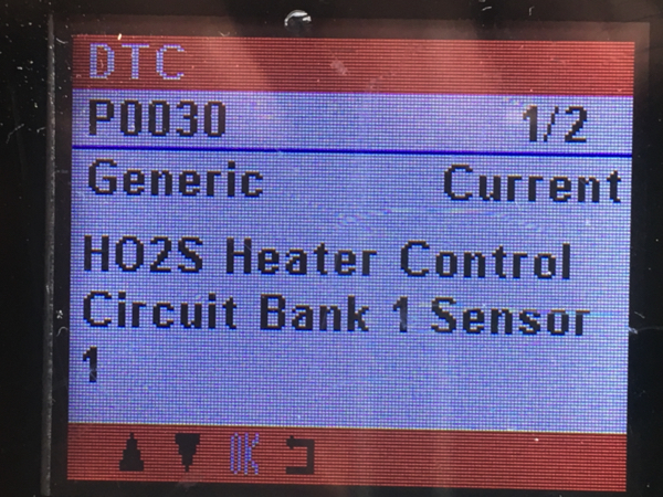

Getting my MR2 back on the road last week from an 18 month off road, I had to use an OBDII reader to wipe the error code off from the MIL light on the dash to get it through the MOT

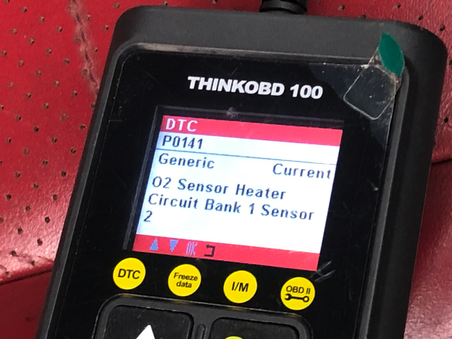

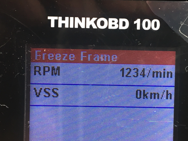

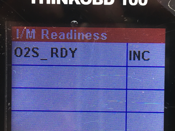

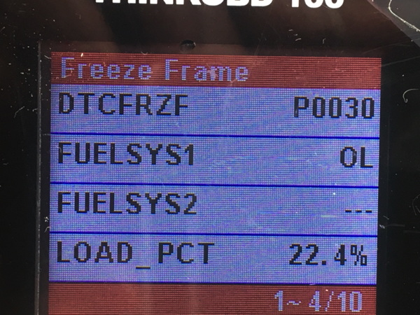

The OBDII reader shows that there is an O2 sensor issue, error code P0030 (I gather this is an error code for the heater of the 02 sensor),

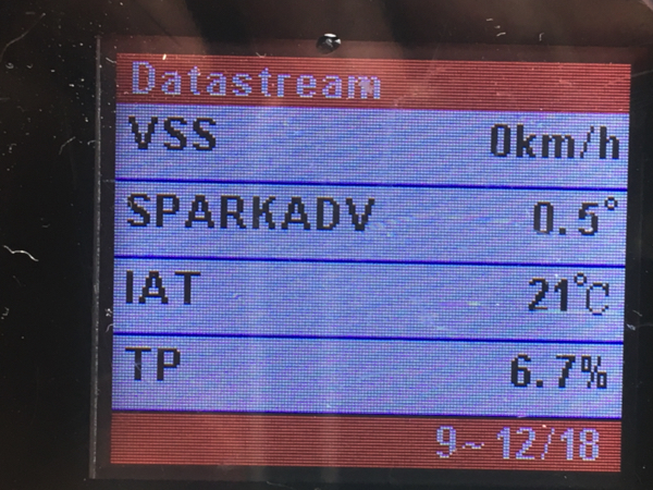

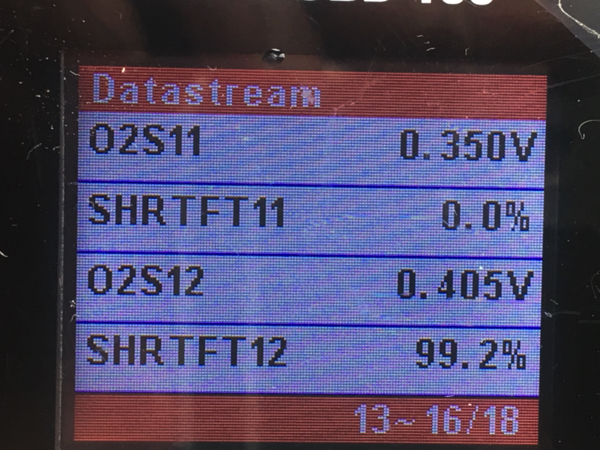

looking at the screenshot of the OBDII reader it looks like two of the three sensors are playing up

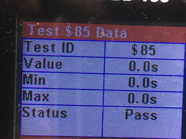

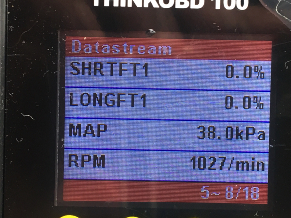

Seeing how much each 02 sensor costs, I thought I'd post on here for any help before I fork out for them, here are the readouts, if any issues are spotted I'd be grateful for any help

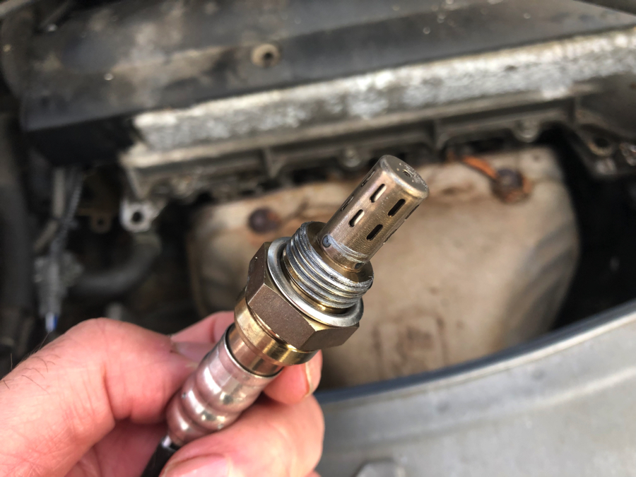

The two part for the 02 sensor

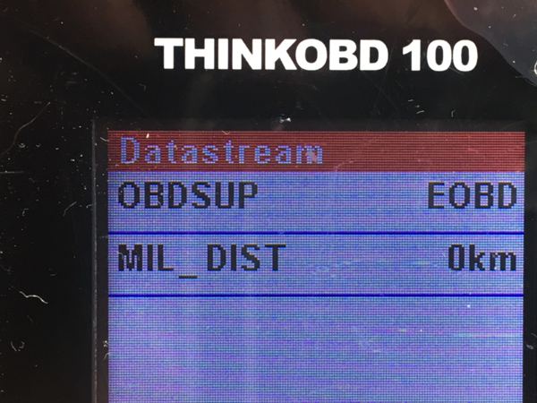

These are the rest of the readouts
I have replaced the over 2 year old air filter and plan on cleaning the 02 sensors and use a multimeter on them to see if it shows any resistance from heater wires, I bought a can of carb cleaner and a small bottle of injector cleaner to use on them.  I took out the MAP sensor and gave it a good squirt of carb cleaner but that didn't do anything

A maf can be faulty but doesn't produce codes.  Both displays say Bank 1 sensor 1, which is one on the right side as you look at it. Don't waste your time cleaning it. You can disconnect Bank2/1 & measure it (should be ok), but don't remove the sensor. It often damages them internally doing so.
There is a bodge of wiring a resistor across the heater cct wires so that the ecu sees a circuit. Google it.
 Using a multimeter to test the heater circuit is a good move. If the heater is burnt out it just needs a new 02 sensor and you are done. You should never clean 02 sensors as it can damage them.
paulj
Its one sensor you need. The current code shows a fault and the pending code shows a fault which hasn't yet triggered the engine light. As mentioned there is a bodge for the heater circuit but I would suggest a new sensor. Once replaced it is one less thing to think of!

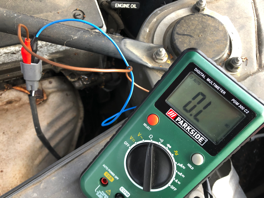

I put the multimeter to the two top 02 sensors,. the one on the right (driver side) there was neither continuity or any resistance
Continuity
Resistance
the one on the left (passenger side) there was both continuity and resistance

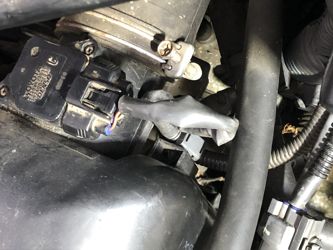

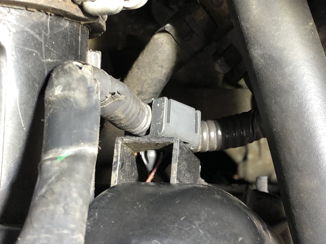

On a side note, we've had (it's my wife's car) the MR2 since November/December 2006, when we bought the car it was around 17/18 months old so we weren't the original owners, in all this time I've only this morning noticed that the wires going to the MAP sensor look as if they have been tied up and not anchored to a point on the car with the connector attached to the wiring
Or is it a case of these sensors are made to be used on other Toyota cars as well and as such the fixing point is not needed on the MR2?

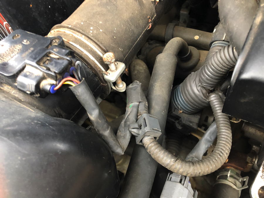

@Mollydog
That fixing "point" should connect into a "socket" on the vertical face of the air filter housing adjacent to where it's now "hovering".
I would guess it meant that at some time it was disconnected to open the filter housing and, hopefully, replace the filter.
@Joesson
thank you, I'll go and take a look now
Edited to add:
I found it and fixed the issue, not that I have OCD but like to know it's fixed safely
I saw that protruding on the air filter box when I changed the air filter the other day, I didn't know what it was for though,
I bet at one time or another a mechanic, when doing the service on the car thought it wasn't the right place for the fixing, I have to agree I don't think its the right location for the fixing point as every time the filter gets changed you have to faff about the fixing
Now I do my own service on the MR2, next time I change the air filter I might do what the mechanic did and tie it up off the air filter box
 The two black wires on the 02 sensor wiring is for the heater circuit. If it is open then the heater is blown. This is a good sign that no other diagnosis is necessary and it just needs a new 02 sensor.
Thank you Dev, yes looks like the driver side one had blown, hopefully the bottom one is OK, if not another one will have to be fitted there too

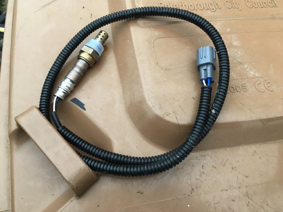

I was surprised to say the least to see that my O2 sensor had arrived this morning as I only ordered it Sunday night and wasn't supposed to be here before this Thursday
I didn't waste  a minute getting the 22mm 02 sensor socket out to the car

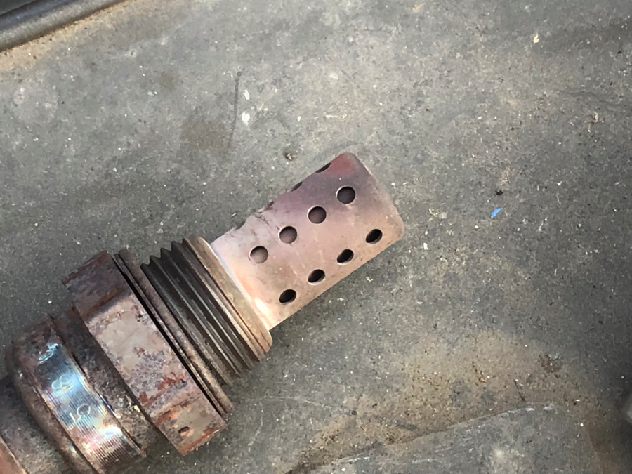

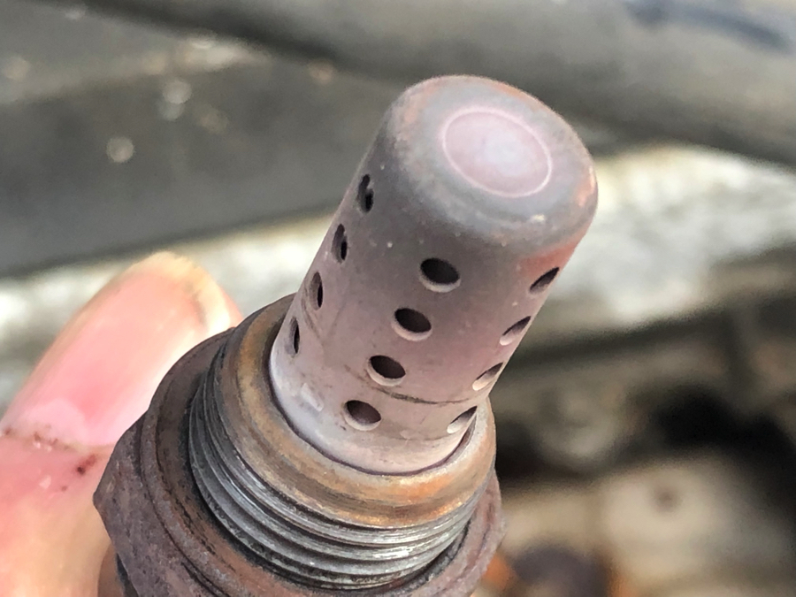

This is/was the condition of the old (maybe original) 02 sensor
This is the new one (not Toyota original)

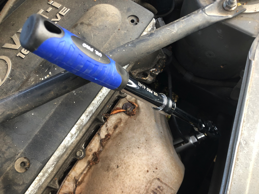

I torqued the 02 sensor to 44Nm

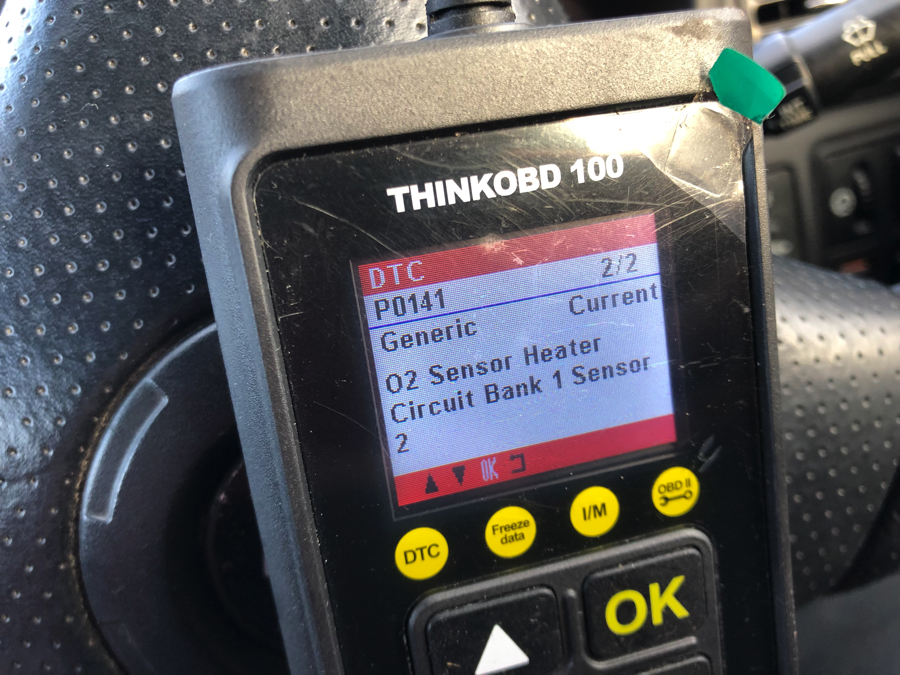

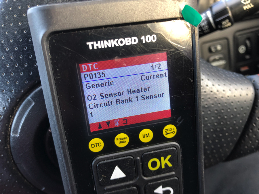

I got out the OBDII reader and showed PO135, bank one sensor one was still an issue,
but this time also showing that there is an issue with bank one sensor two PO141

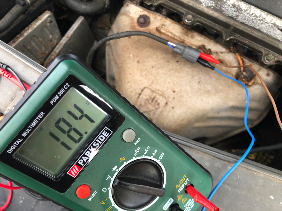

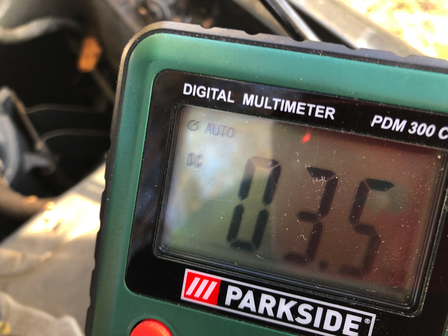

I checked if there was any power to bank 1 sensor 1 and tested the two power wires for voltage and the meter showed 3.5v

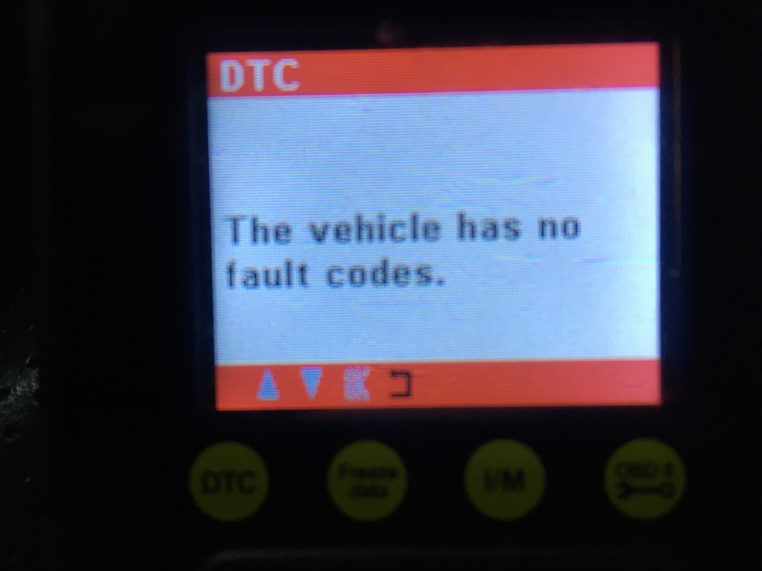

I cleared the error code and took the MR2 for a drive on the A1 (M1) near me that's around 20 miles long

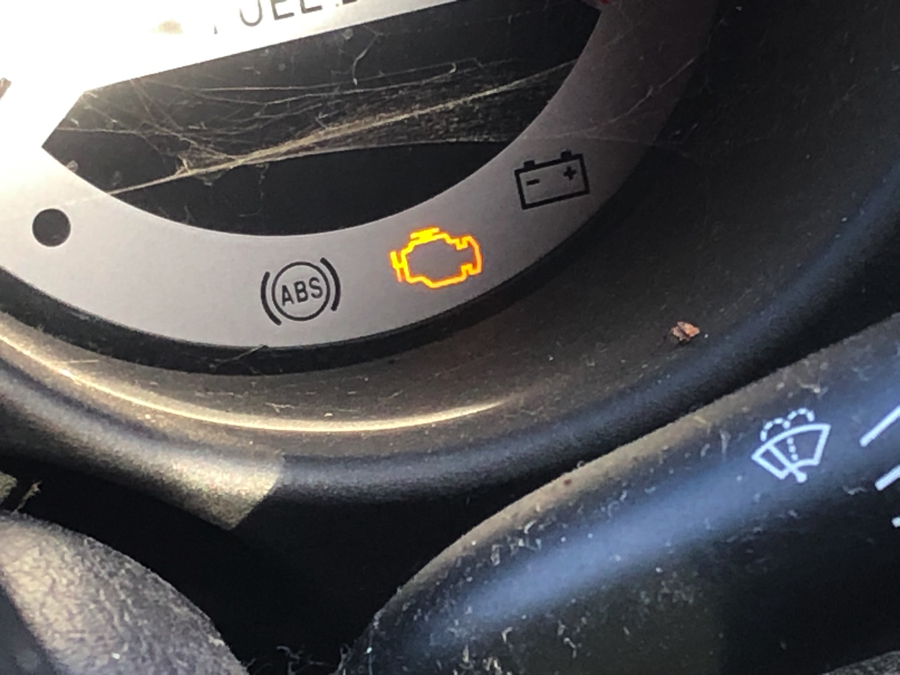

Around a mile or so before the road turns back in to an A road the MIL light comes on,  once on the A road I pull over and get out the OBDII reader to check what error codes it was going to throw up
This time all that showed up was the error code PO141, no PO135 code showing
I cleared the code and drove back home sure enough around a mile from home the MIL on the dash comes on, I get out the OBDII reader and it shows only error PO141 no PO135 code

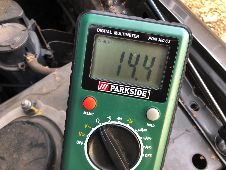

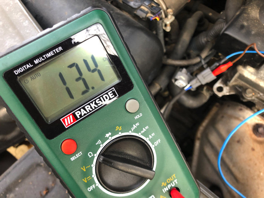

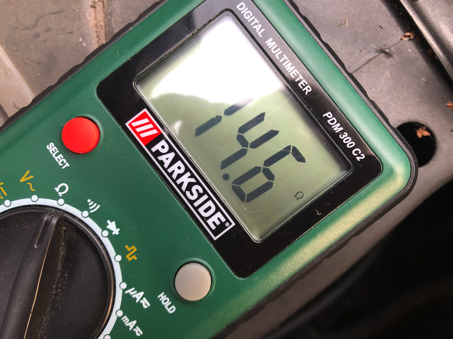

I put my multimeter on the heater wires on the bank 1 sensor 1 02 sensor and the meter shows a resistance of 14.6 with engine at running temperature
thought I'd see what the continuity was, it was 14.4
It's getting dark outside now so in the morning I'll be putting the multimeter to the post CAT 02 sensor and see what shows up
This is a bit of a mystery really

I checked the downstream sensor yesterday and as expected no resistance or continuity so placed another order for an 02 sensor, hoping this will sort out the issues, in passing apart from a longer cable is there a difference between the upstream and downstream 02 sensors?

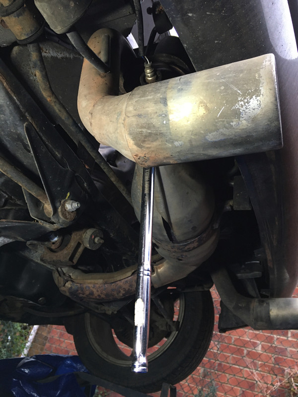

Be aware that they can be stuck with rust. One of mine wouldn't come off on a garage ramp & a big breaker bar on it. I did the resistor bodge.
Seized-on is not uncommon, garage said sometimes the pipe cracks before the sensor does.
The post cat sensor can be a bugger to get out, as Gaz says.
If it won't budge, I take an angle grinder to it and cut it down to the hexagon, then get it good and hot with a plumber's torch, then a six point socket and a breaker bar.
I've done a few, and that has always done the trick.

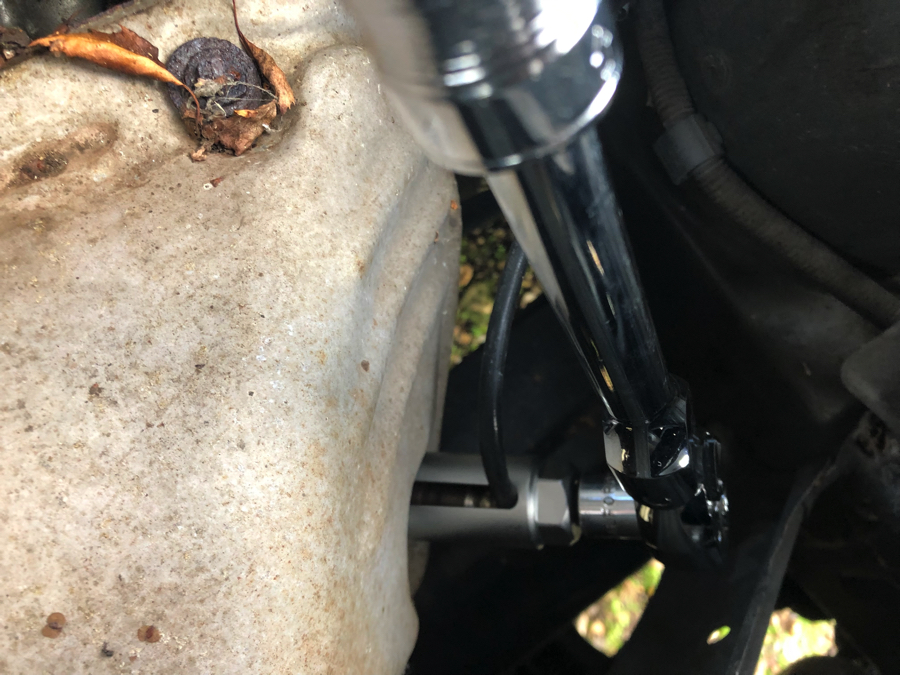

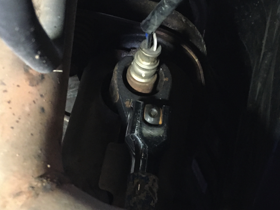

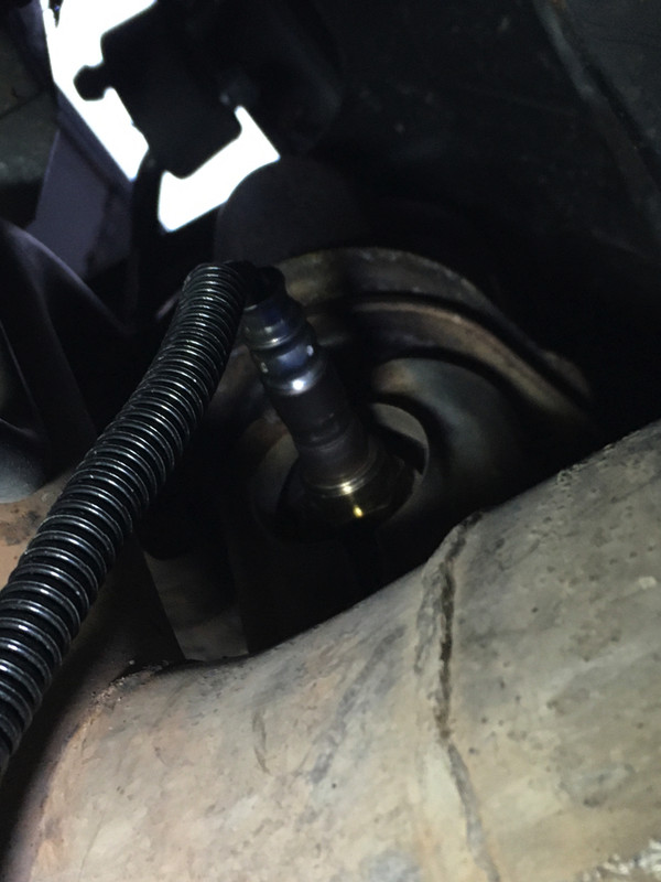

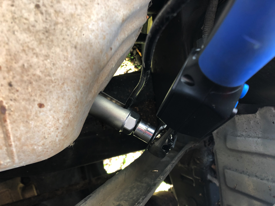

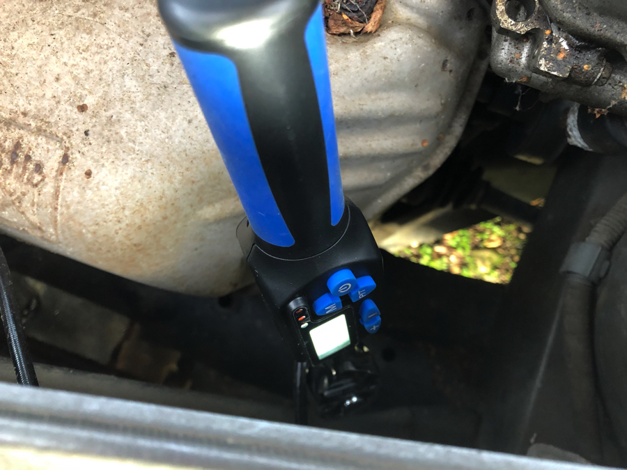

As I was changing the oil I had the car on ramps, I made a start on the 02 sensor, circuit bank 1 sensor 2, the one past the catalytic  converter

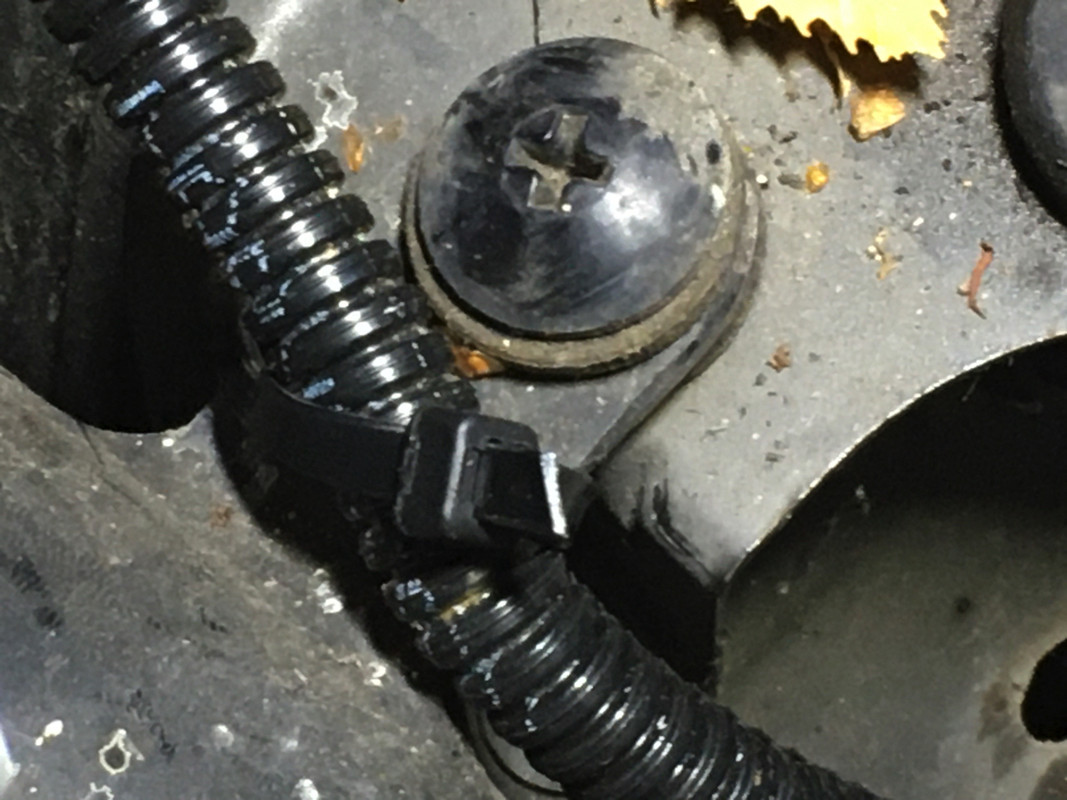

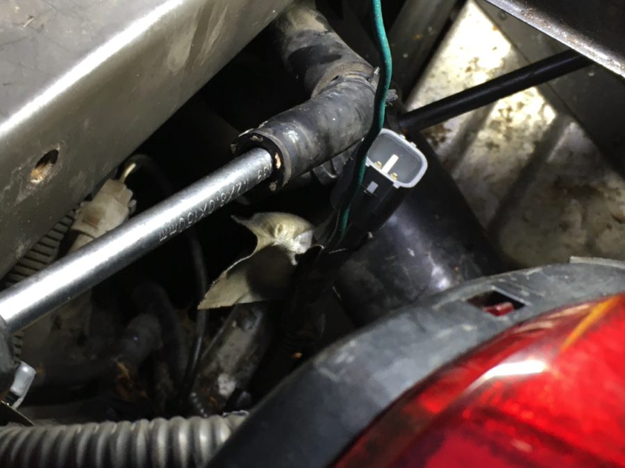

Seeing how hard it was getting the 02 sensor wire off I couldn't see myself using the same fixing points Toyota used for the 02 sensor wire,
I found it difficult taking the rear lights off as I have that duck tail so I took out the  header tank and this gave me room to move around behind the lights and connect the 02 plugs together

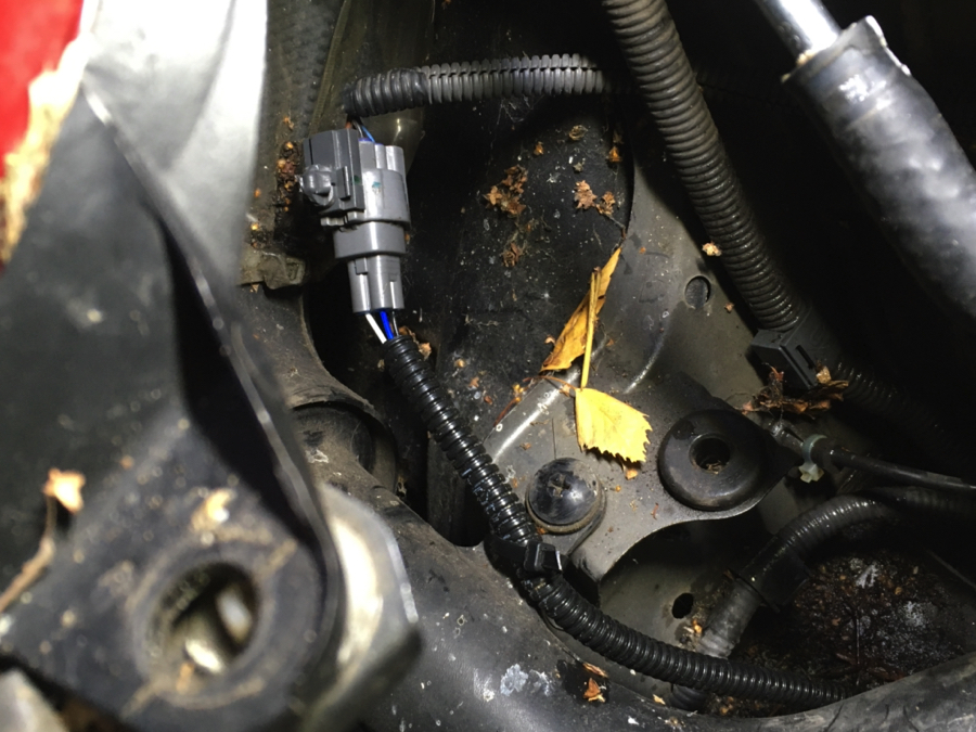

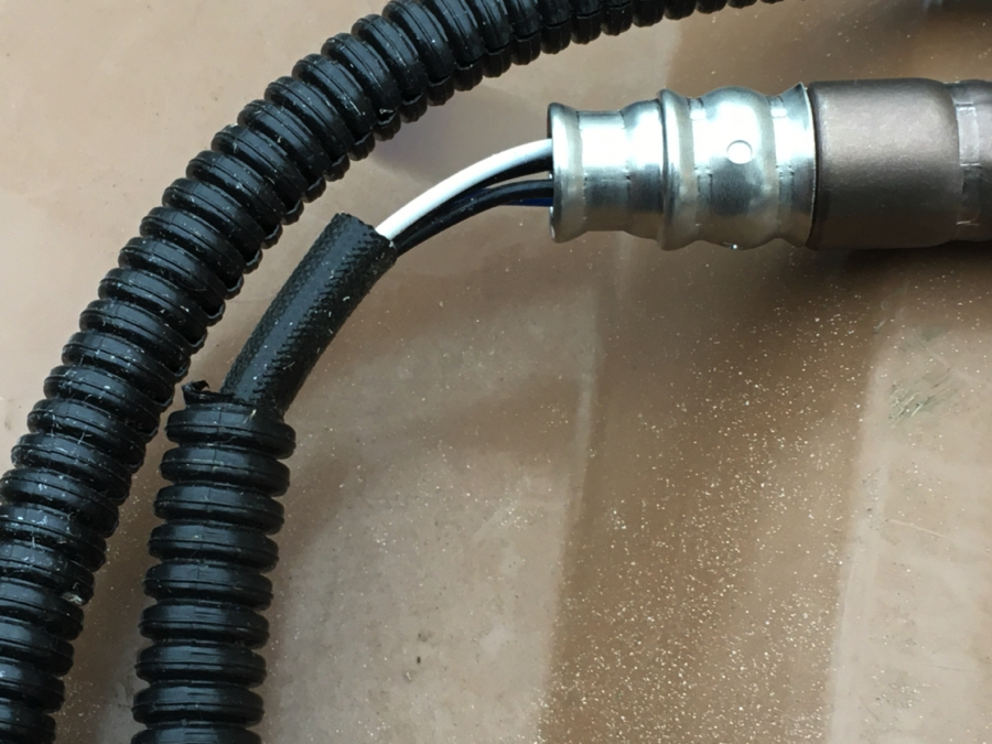

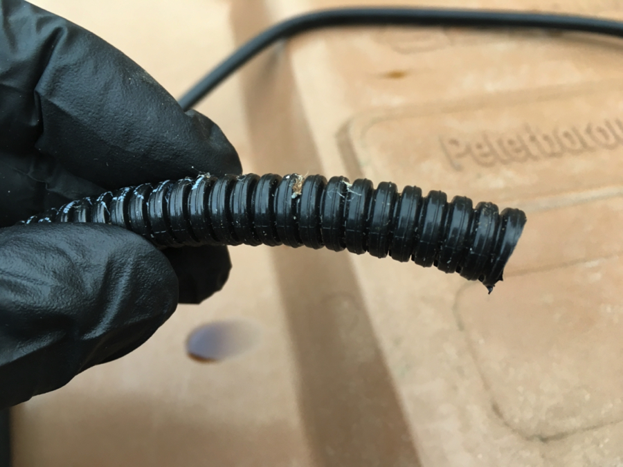

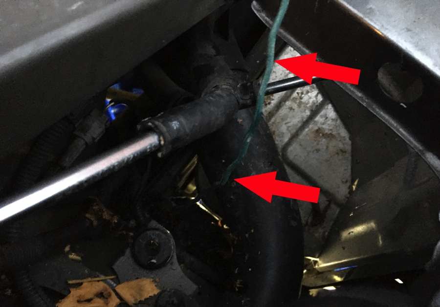

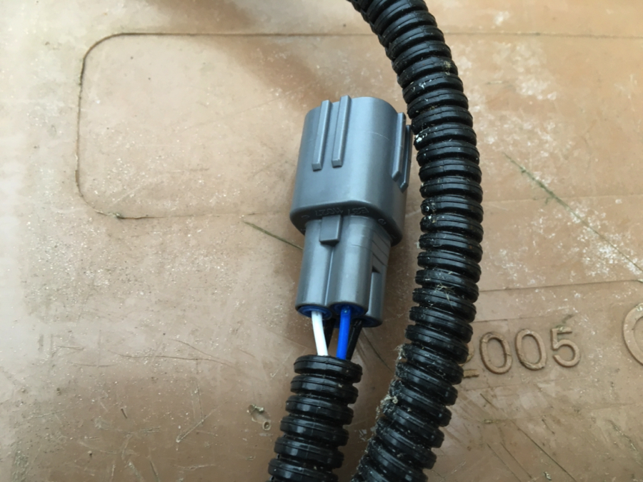

I have a lot of this wire shield conduit I use on my cars when doing electrical mods
So to protect the wiring from chafing I cut a length of it to cover the full length of the 02 sensor wire
I used a 3/8 breaker bar and to my surprise with little effort the 02 sensor moved and I ended up unscrewing it with my fingers
Fitting the new sensor was a bit fiddly as it wasn't easy catching the thread and a few attempts were made before I got a small bite then used the 02 sensor socket to hand tighten before I used the breaker bar on it, NOT over tightened just a bit more than hand tight

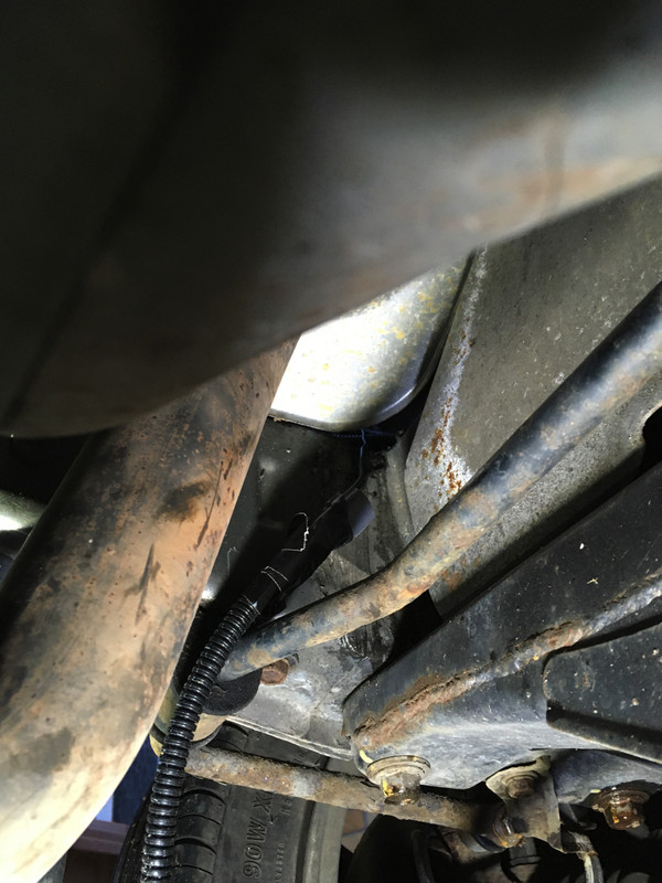

Then came the threading of the new cable, I attached a stiff wire to one end of the 02 sensor wire and threaded this through to below the header tank location
Pushing up
Pulling up
I used a few cable ties to hold down the wiring
