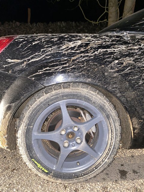

Hi, just wondering how you got on with yours, I did my first event in 10 years last night in my 2zz roadster, hindered and slowed downa lot by a rear guard that was acting as a scoop for all the grass in the middle of the road, I've just ordered a set of KYB standard height springs to replace the h&r ones currently on the konis, but is there any other options for gaining a bit more clearance that you are aware of? the guard in the picture was flush to the floor at the start of the event, my spreaders clearly worked because the floor seems to have held up well.
https://i.ibb.co/YPp5k9S/2c7e0d36e3bc.jpg
https://i.ibb.co/Jvfjjvp/0c85ac9936fb.jpg
Quote from: Tommk2rs on February 19, 2023, 21:12but is there any other options for gaining a bit more clearance that you are aware of?
There are only two options for that;
- longer springs
- higher tyres (on 16" rims)

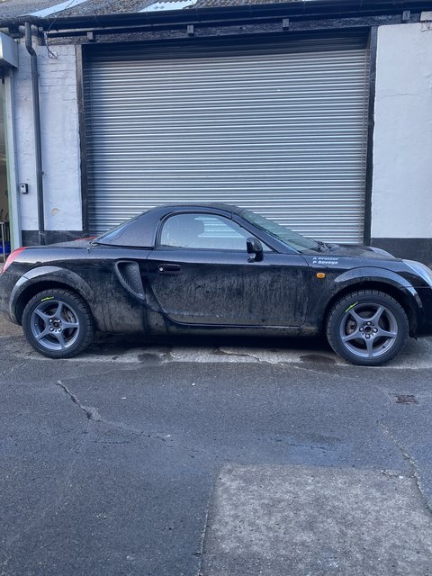

Again, apologies for the delay, but here is an update from the end of February 2023.
I finally got my car back ready for its first rough night rally, new springs fitted and three guards underneath. The new ride height looked good, as did the 5mm alloy guards that my mechanic had cut and shaped to protect it as much as possible. It makes it almost flat underneath, if only I was going to go fast enough to benefit from its improved aerodynamic efficiency 😆.
With fresh gravel tyres fitted we set off to Derbyshire for the rally. With no time for even a small test drive it was into the unknown for the first bit of the rally, a couple of laps round a go kart track where the event started, whilst all the other competitors were watching!
The car was perfect for the kart track and we came out with fastest time. We then set out into the countryside for the the start of the rally proper, the first section was to include 10 miles of fast flowing roads and a lovely gravel track for a couple of miles that included a deep Ford.
Before we ever got to the gravel track however, it was evident that all wasn't well with the suspension. We were grounding out at the rear on medium compressions and it became apparent that the new springs had failed!
We continued on being very careful on the rough stuff, of which there was lots and competed the rally running with less ride height than standard. It was painful at times with the rear grounding out all the time, but other than that the car ran faultlessly and it was great fun on the smoother sections.
Back to the drawing board on the spring front.
