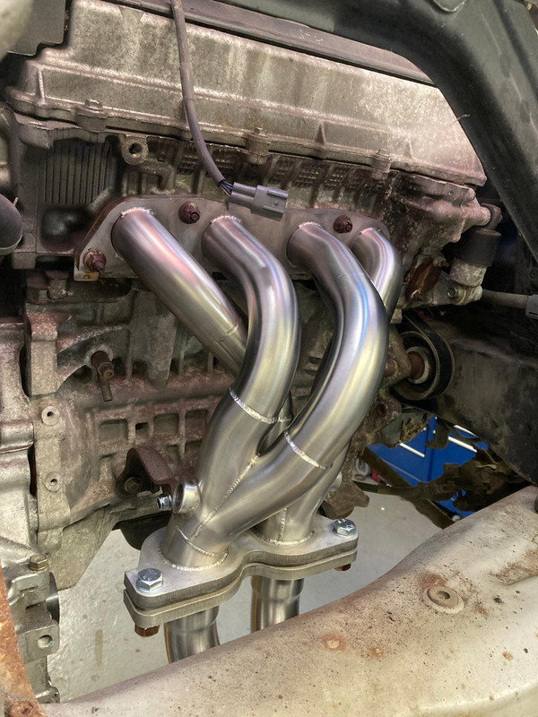

The full Zero Exhaust system has now been installed, a few photos for you.
Looks effective, minimalistic and light! I would not want that AT ALL  ;)
Hammond
Quote from: Pundershaw on April 23, 2022, 13:00The full Zero Exhaust system has now been installed, a few photos for you.
How does it sound? Looks like a nice bit of kit!
