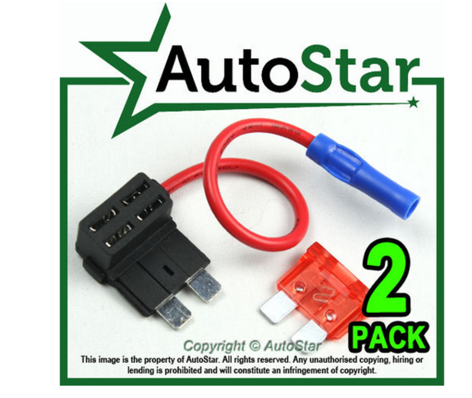

I've only once temporarily  fitted a DVR to our MR2, I piggybacked power from one of the 10amp fuses on the passenger side on the dash using one of these:

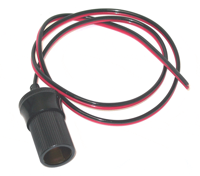

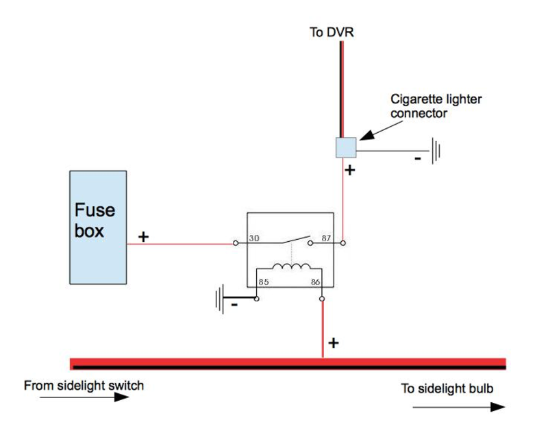

On our Elise  (as on the MR2 as well) we never drive the car(s) without the lights on, day or night so on the Elise I wired the DVR with a relay, to get power  on when the lights are switched on
The cigarette connector plug shown in the diagram isn't the factory fitted one used for cigarette lighting, but a new one placed near the fuse box this then powers the DVR either by 12v DC or if the DVR uses a USB then a 5v DC

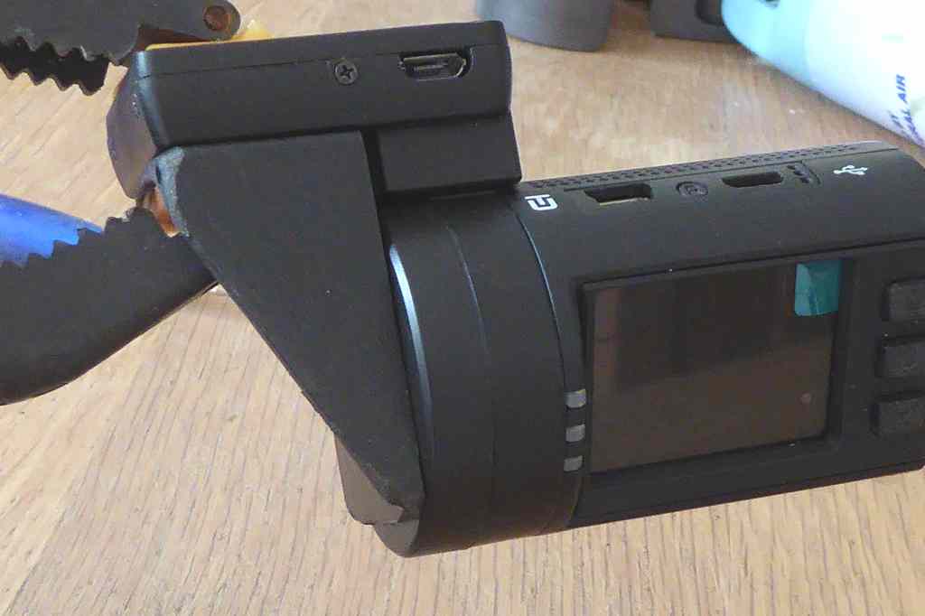

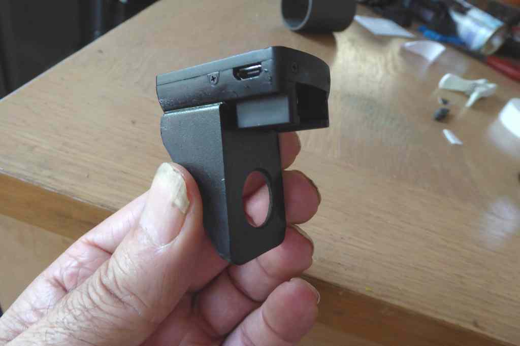

This DVR was a Mini 0906 dual 1080 front and rear, I had to reinforce the bracket for it as it flexed too much while driving

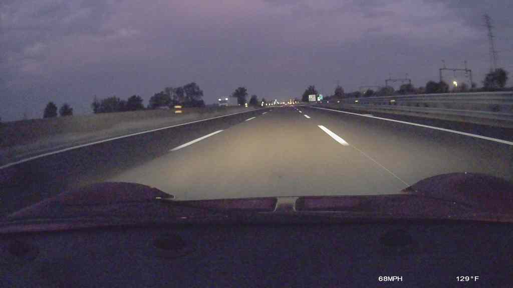

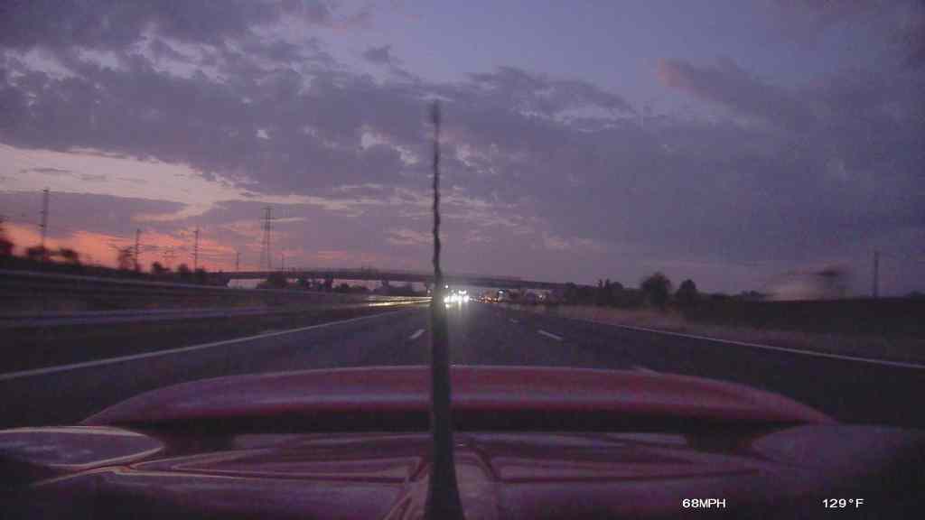

And with most DVR's a good polarising filter isn't a bad idea
Used to capture good night images, providing it wasn't pitch dark
Front
Rear
