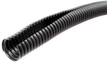

apart from the RCA plug the wires aren't that thick but I would like to shield the wires in split ducting like this one
This will be either 10mm diameter (my preferred size) or 6mm diameter if there's not enough room for the 10mm, if going through a grommet maybe have to stop the ducting on one side of the grommet and start again on the other side

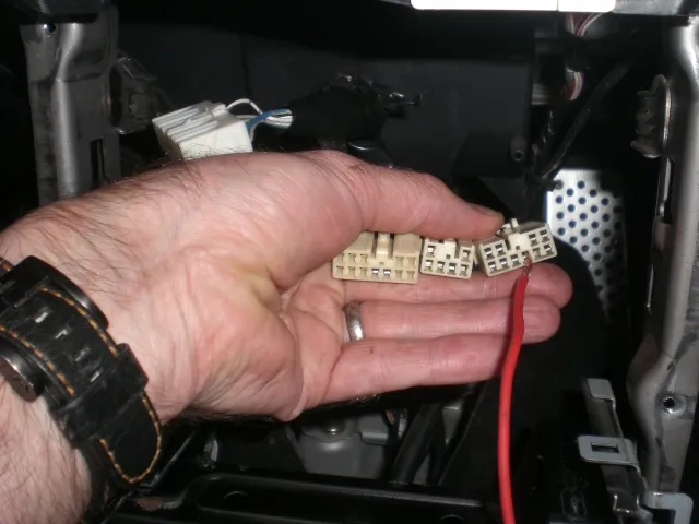

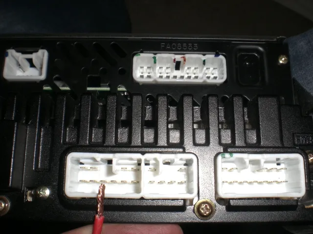

On a side note, my intentions are to keep using the electrical aerial, the head unit has an aerial wire popping out of it, and doing searches on here I came across  two images, am  I right in thinking the wire coming out of the head unit needs to connect with the pin shown here, if so are there any blank plugs one could buy to do this connection?
I presume the pin OUT from the Toyota head unit?
