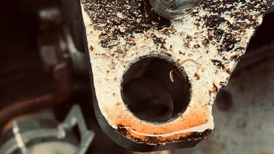

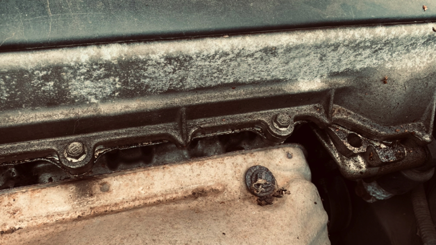

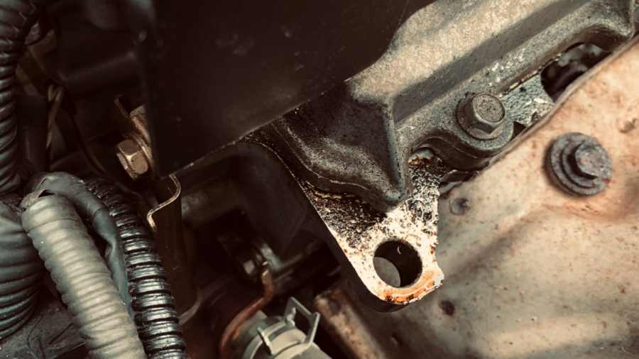

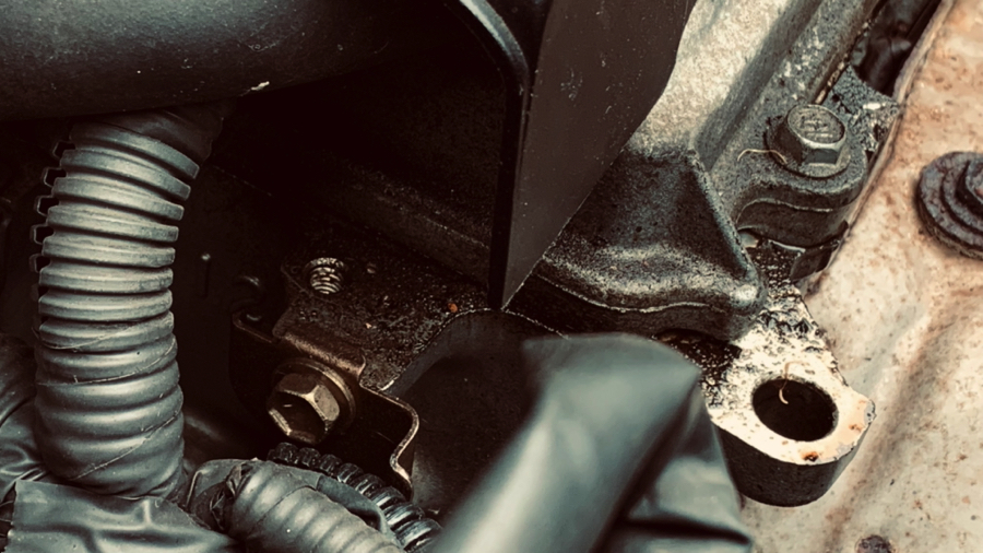

Went to check on the coolant and oil level this morning and I saw what looks like a bit of oil weeping on the cam cover gasket, I hadn't noticed this before so not sure how long it's been weeping
Here are some images
This is what first got my attention

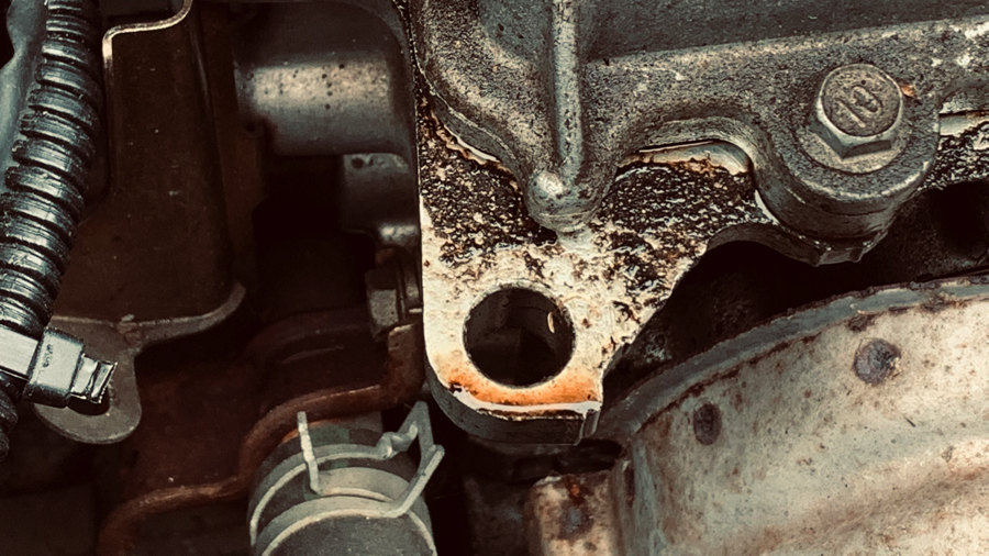

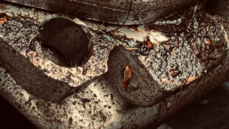

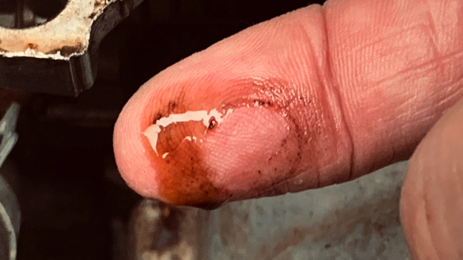

I placed my finger under the hole where the oil was gathering, and see it's oily under it too

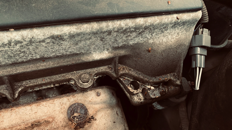

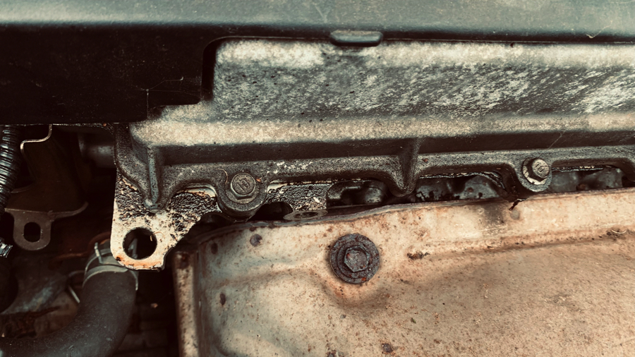

Looks like it's all along to the other end
I looked up the side and noticed it look like it's a bit drier there and no or little oil leak at the sides,  maybe just running along the bottom
After checking the oil and coolant both hadn't moved up or down so don't think there is any contamination also the coolant still has that pinky anti freeze colour with no sign of mayonnaise in the header tank
Any opinion if I should be replacing the gasket and if yes is there something I should be looking out for when doing the work?
 Many thanks
Nice easy job.
Been some issues with blue coloured gaskets.
Go oem. Not that expensive.
Remove old and clean groove. Clean mating surface.
Could just be old and has let go if nothing else is cause for concern.
Those in the know would be better equipped to answer. A pic of the inside when the cover is off will help others advise. Clean and golden coloured is good.

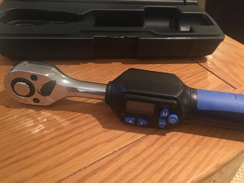

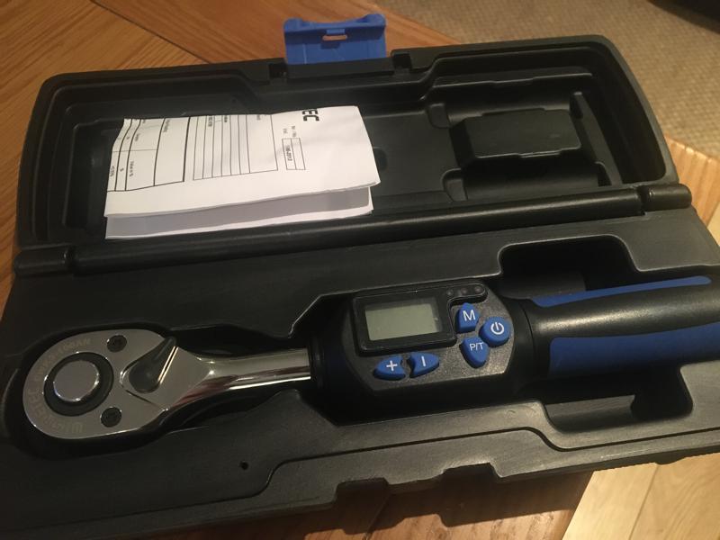

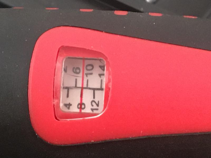

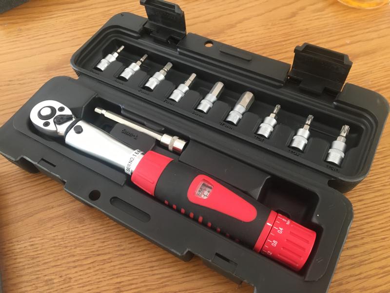

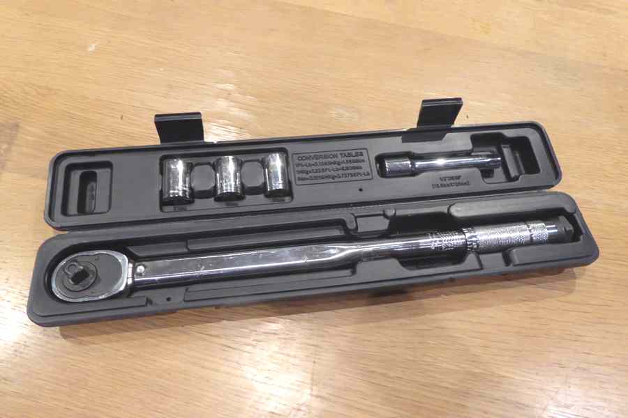

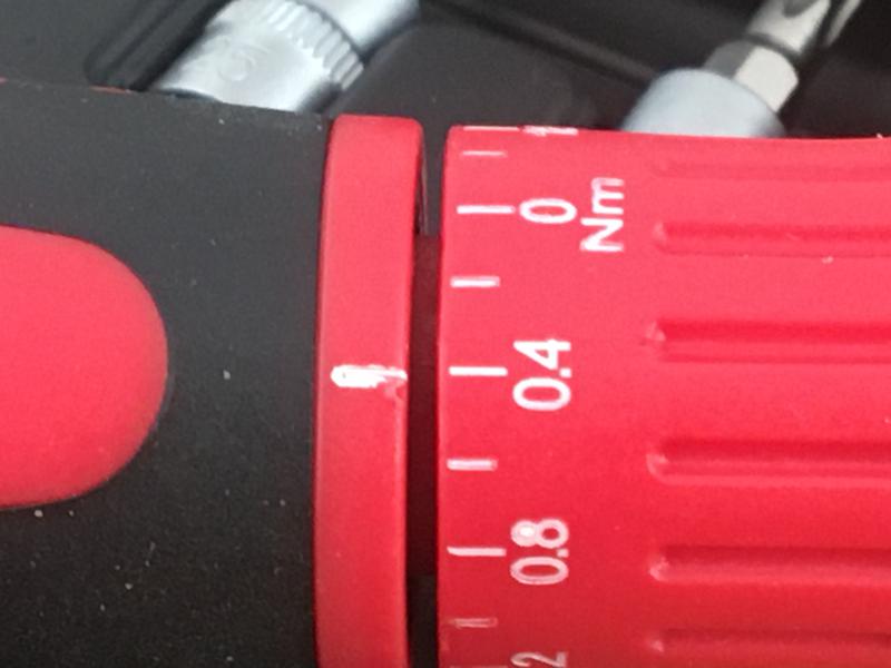

I have a range of torque wrenches 1/2, 3/8 and 1/4
This 1/4 comes in hands for low torque setting 2Nm to 24Nm

If I know the torque setting I like to set it, if I don't know then I'll play it by ear, my late father who used to do all his own maintenance on all his car's, and over all those years he never saw a torque wrench in his life, and I must say nothing ever fell off
he never opened up an engine or major things like that but general run of home maintenance
I'm impressed.
I like things torqued correctly. Never seen a low torque, torque wrench like that.
Do I "need", no. Want? Yes.
My biggest weakness is buying tools thinking I might eventually find a use for them, I'm sure I have lots of tools that have maybe seen one time use, as I explain to my (understanding) wife, these tools are my toys :)
I have a correction to make

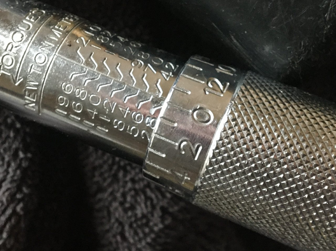

I made an error, I have two 1/2 Inch torque wrenches and one 1/3 Inch torque wrench (the one above), shows how regular these are needed
This one is a 1/2 inch 0 - 100Nm digital torque wrench
And this one is the analog 1/2 inch 28Nm - 210Nm

Stop showing those wrenches please, I have one but now I want a small one like yours !! :)

Quote from: TheTigerUK on May 11, 2022, 09:15Stop showing those wrenches please, I have one but now I want a small one like yours !! :)
Never heard of anybody wanting a small one before.
TheTigerUK
Quote from: 1979scotte on May 11, 2022, 10:09Never heard of anybody wanting a small one before.
You obviously havent had the struggle and strain of living with and using a big one !! :)

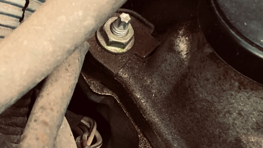

It was rather hot this Saturday morning, I was thinking of leaving changing the gasket for Sunday, I'm pleased I didn't as Sunday was a wet and cold day,
I've added two videos of my replacing the gasket, this isn't a tutorial, it just shows what I did to replace the gasket, I edited out all the slow time and showing around 95% of the work involved

Time taken from taking off the steady bar and refitting it, just over an hour, a good few bit of time was taken swapping over tools  from the bench and back to the car and stopping drinking (lots) of water, it was a very hot day so I would think going steady, this job could be done in around 30 to 40 minutes
I'm adding two video clips, one from the left side of the car and the other from behind me on the right side of the car, as I mentioned this isn't a tutorial, it just shows the process I took
