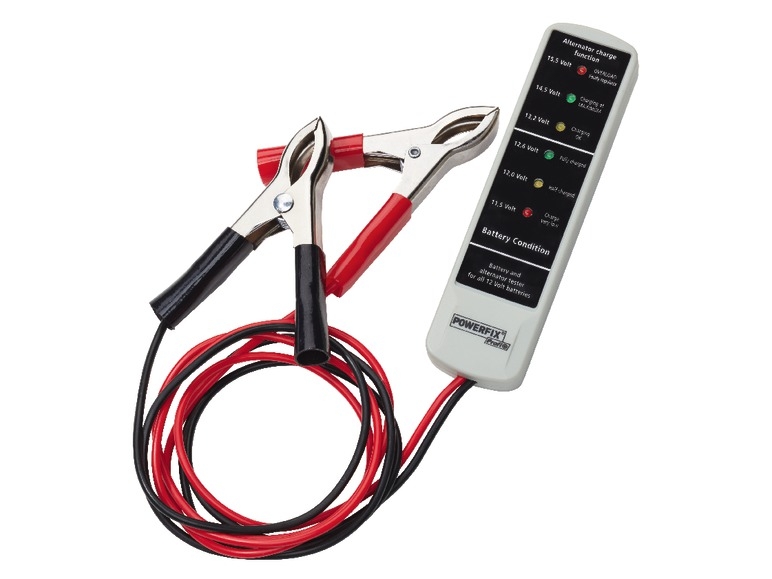

If you think it might be the alternator playing up, I bought this tester here in the UK from Lidl for under a fiver
https://youtu.be/34aVP0UA0uM
Tells you battery condition and if the alternator is charging OK, charging high or over charging, for the price worth getting if you're not sure its the alternator at fault
Thanks @Mollydog
I have a voltage meter installed.
That is why it was so confusing.
