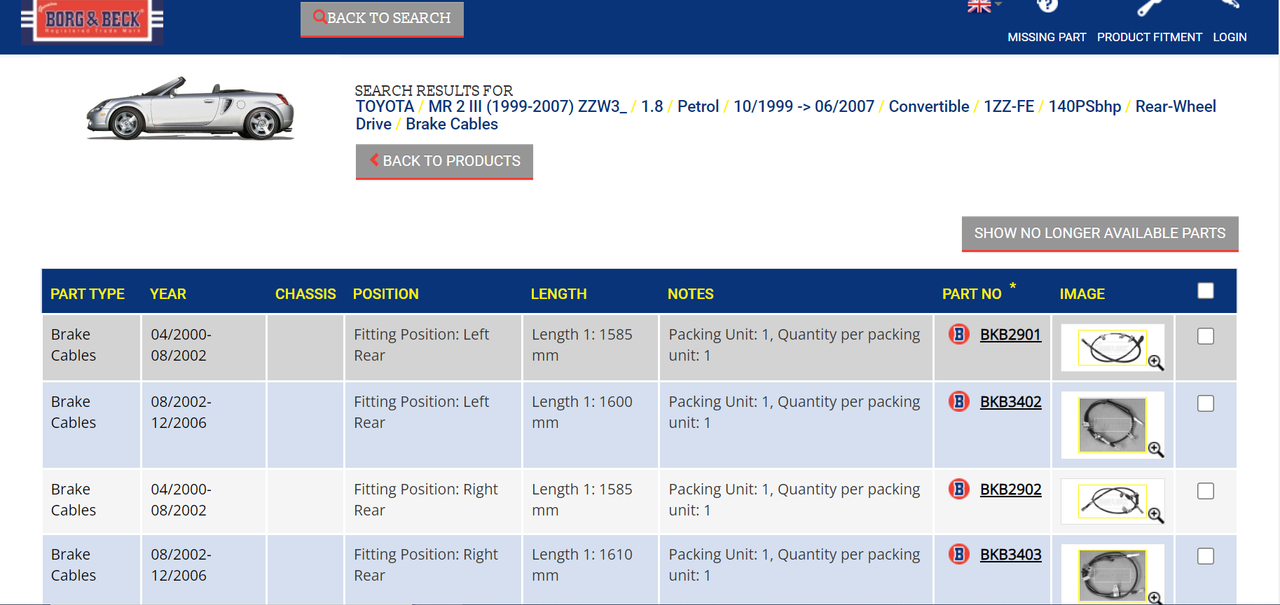

From reading there are different cables for PFL & FL. The PFL cables are shorter, so if you have fitted FL cables to a PFL car this could be your issue as the cables will be to long and not actuating the handbrake lever enough on the calipers.
I have ordered Borg & Beck FL cables for mine and I've now got to risk a heavy fine to drive it to a garage for fitting.
See below on B&B cables.

Thanks for the response, I did indeed fit FL borg&beck cables as you have ordered following a positive review from someone else online. A little tip but I'm sure you're aware - be very careful which side the cables go as they're slightly different lengths.
To be honest I can't think of it being anything but the caliper but I've got a lot to learn when it comes to mechanics so didn't want to just be throwing parts at the problem without troubleshooting first.

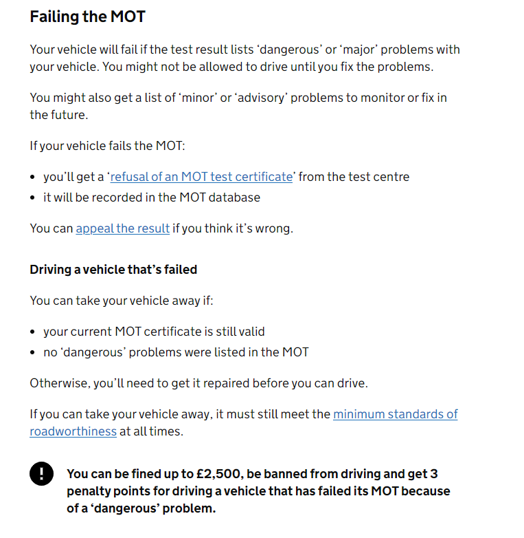

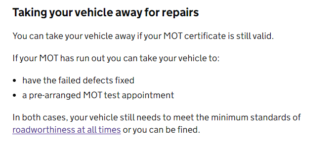

If I'm reading it correctly online, not since the new 2018 MOT rules. If you can find me a statement on the gov website stating I can still drive to a pre-booked repair appointment with a 'DANGEROUS DEFECT' then this would save me a ton of cash on garage labor. It even states on the fail cert 'DO NOT DRIVE UNTIL REPAIRED'
Saying that, just rechecked the GOV site, and I interpratate this as I can take it away for repairs?

When you have got a dangerous defect on the mot you are not supposed to drive it until it is repaired.
I do KNOW of some garages using the wording to their advantage and insisting it gets repaired with them.. this is a main dealer!
By driving the vehicle KNOWING it is classed as unroadworthy will be what you can be prosecuted for.
When I fail a car for a dangerous defect I advise them of this but also say it is up to them and I have no power to stop them.
You gotta be pretty unlucky to get stopped.

Quote from: mr2garageswindon on December  7, 2022, 10:29When you have got a dangerous defect on the mot you are not supposed to drive it until it is repaired.
I'll only get stopped if I go past an ANPR equipped police car and it pings for MOT. Like you say if I do get stopped, I have no case to fight.
Quote from: JB21 on December  7, 2022, 10:37I'll only get stopped if I go past an ANPR equipped police car and it pings for MOT. Like you say if I do get stopped, I have no case to fight.
If you get pinged on the way back from the failed test and it's already updated on the system then YES technically you could be prosecuted but if you're driving it TO a pre booked retest then you're ok, as long as you're not knowingly driving with a dangerous fault.
But again that's making the assumption that you're aware of a dangerous fault, as far as you're concerned you've sorted it before taking it back.
