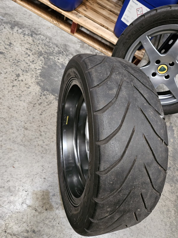

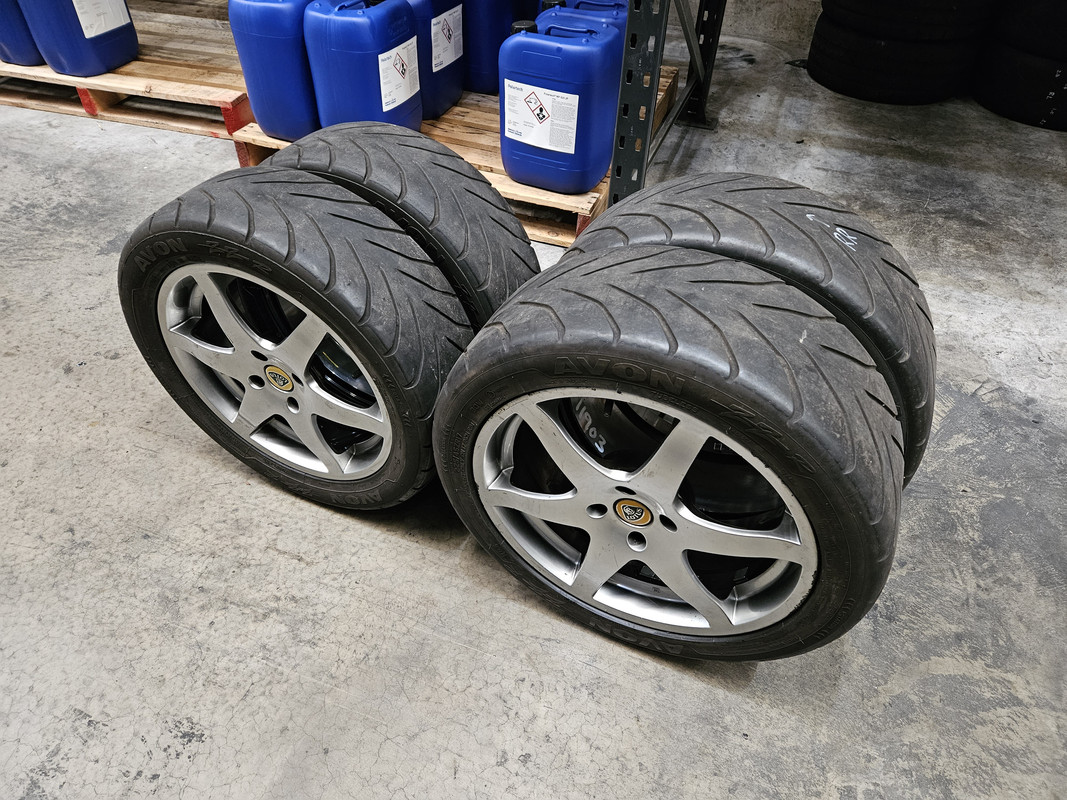

Finally got some tyres fitted to the Lotus wheels. Avon ZZRs 195/50/16-225/45/17 Elise/Exige spec.
Oulton 18/11 for testing
No issue with 195 tyres on 5.5J rims
Tyres look mega. Be interested in feedback.
AdamR28
ZZRs are excellent. As long as its dry  ;D
SuperArt
Do you notice the difference when running larger diameter wheels at the back?
Why not keep 16's all round just with wider width rears? I'd have thought the get-up-and-go would be blunted with a bigger diameter rear wheel.
I'm on 205 R16 front 225 R16 rear. I don't like this setup, can't explain it but it doesn't feel nimble like stock sizes.

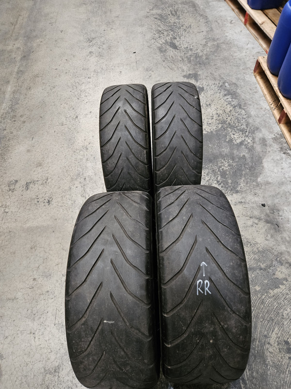

I've just weighed the Lotus wheels and Avon ZZR tyres and also my lightweight 15X7 OZ Ultraleggera's with Yoko A048 tyres and the difference is staggering.
Lotus/ZZR - 195/50/16 = 18kg
Lotus/ZZR - 225/45/17 = 21kg
Total mass 78kg
OZ/A048 - 195/50/15 = 13.5kg
OZ/A048 - 225/50/15 = 15.2kg
Total mass 57.4kg
So that's a difference of 20.6kg in unsprung weight total, and 11.6kg difference in rotational mass on the rear wheels  :o
I'm now putting these up for sale if anyone is interested as this is just to much extra weight to cart around track. They come with aluminum spigot rings and slimline wheel nuts to fit straight onto the ZZW30 - £500.
20KGs! Wow. Fully not worth it.
Well done to you for putting function in front of form.
Shame that, as they look lovely!

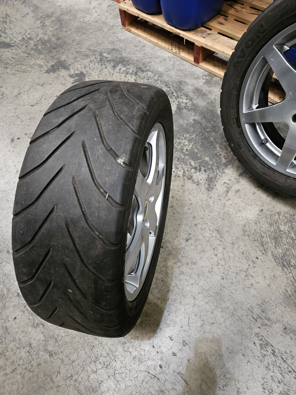

OK so a bit more wheel and tyre weighing, this time my OE FL wheels and Yokohama A052's.
FL 15" front/A052 - 205/50/15 = 15.1kg
FL 16" rear/A052 - 225/50/16 = 17.6kg
So this is a much more respectable 8kg difference vs one of the lightest wheels on the market.
