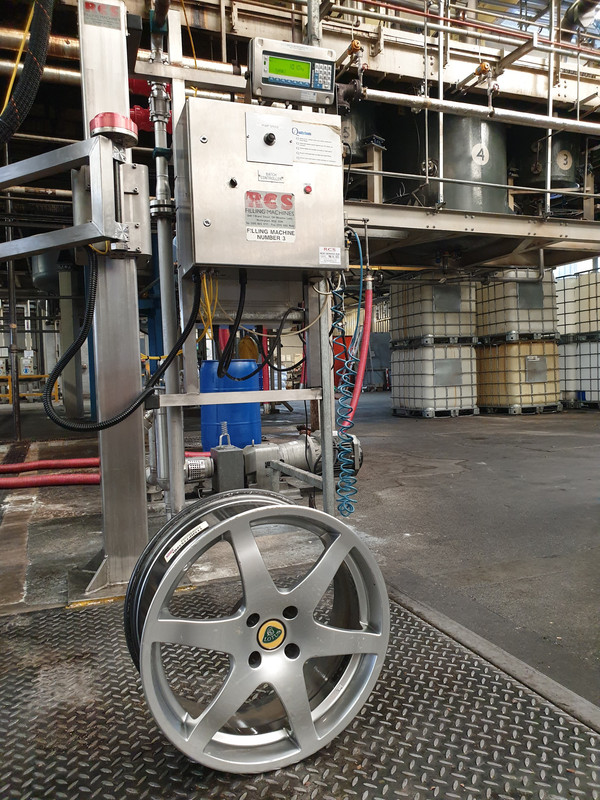

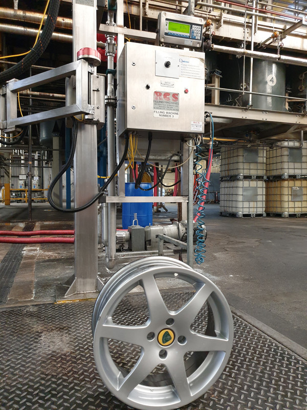

Lotus OE (Rimstock 6 spoke) wheels have arrived and obviously the first thing to do was weigh them.
Front 16x5.5J = 8.1kg
Rear 17x7.5J = 10.1kg
Not exactly Lotus lightness but not terrible.
