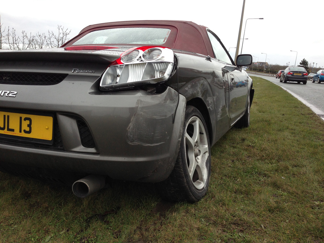

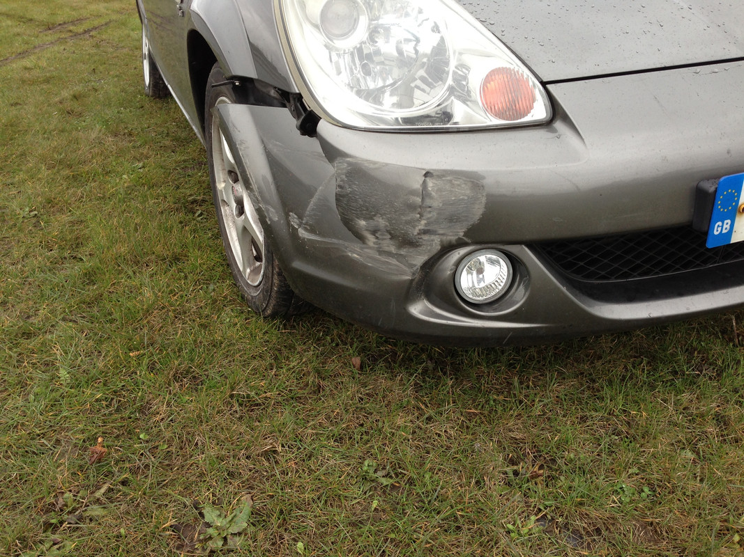

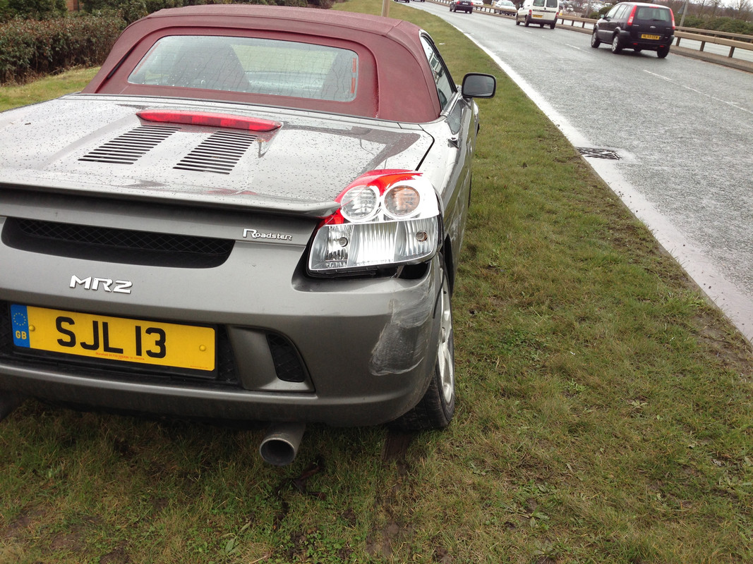

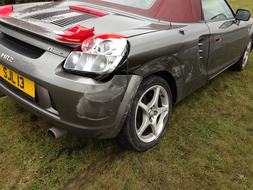

as 10 years ago this March my son was driving and as he came off a round-a-bout he hit an ice patch and spun in to the barriers damaging a lot on the car
The insurers were going to write it off, something we didn't want, at the time these MR2's were going for around 5 to 6K as luck would have it there wasn't any MR2 RED's for sale anywhere to replace ours, my argument with the insurers was all I want was to be in the same position with the car as I was before the accident, we were with Direct Line at the time, they were great and in the end the loss adjuster agreed to pay out for the repairs
excluding the hire car the bill for the repaired came to well over 6K.  On driving the car out of the repairers yard, the steering wasn't right so I stopped and pointed this out to them, so I had their hire car for a further 2 weeks while the had the car re tracked
