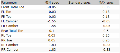

Just found the OE specs (below) so mine above aren't a million miles away from OE. Toe is in minutes and the minus sign - is toe out. I like all my cars toeing out at the front as this makes for darty steering, the drawback it can wander about a bit on the motorway but what I recommended wont be to bad at all.
