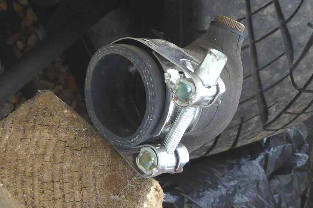

Just a heads up really, I've had a couple of 2's in recently with low coolant level.
Both times I have found the metal spring hose clips that go from the rubber hose to the underbody coolant pipes (At the front of the car)  badly corroded and weeping.
Nice easy fix undo a quality jubilee clip wrap it round the hose, move old rusty clip to where you can cut or break it.
Tighten new clip in old position.. No coolant loss happy days.
Worth a look next time you are under the car

I'll replace the original spring clip with one of these T bolts (as I have done on the Elise)
