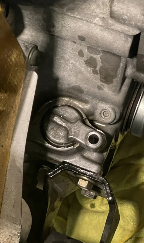

Where are your filling the transmission. Some people are mistaking filling the transmission using the 10mm hex bolt instead of the 17mm fill bolt and getting half a liter less in the transmission.
Quote from: Dev on May  9, 2023, 15:54Where are your filling the transmission. Some people are mistaking filling the transmission using the 10mm hex bolt instead of the 17mm fill bolt and getting half a liter less in the transmission.
I fill mine from the top bung thing, speed sensor hole maybe?
https://i.postimg.cc/rpwYdyTV/Screenshot-20230509-165428-Samsung-Internet.jpg
For the level i undo the top 17mm fill hole and fill until it drizzles out. It takes around 1.8L.
Quote from: JB21 on May  9, 2023, 16:58I fill mine from the top bung thing, speed sensor hole maybe?
That would be fine as long as it drips out of the 17mm fill hole. It's probably because you have an LSD and I have an open diff.  I had to fill 2.3 liters in my C60 transmission.
 There were people filling it at the hex bolt and only got 2 us quarts which was low.
