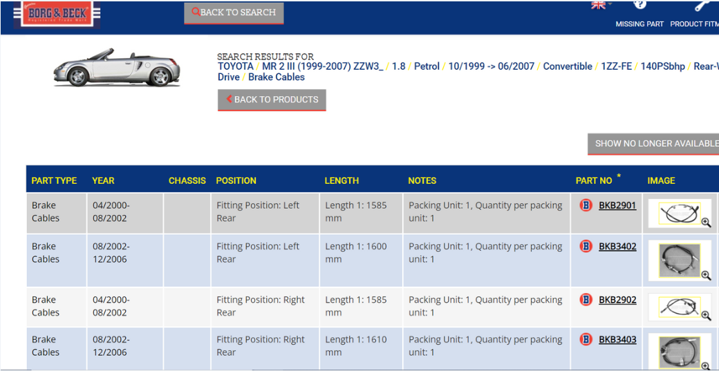

I've recently used Borg & Beck cables from Arnold Clarke. Please note there is a difference in PFL & FL.
Just enter the B&B part number into the below site.
https://www.arnoldclarkautoparts.com/

Thanks for that @JB21  8)
I did actually go ahead + order from that very site yesterday am
Borg + Beck are not a 'fly by night' co. ....I would hope and expect their cables are 1/2 reasonable at worst
