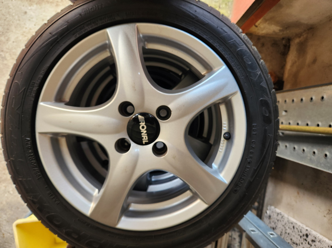

Right, so I'm thinking that I might get the standard wheels refurbed, (although they are in really great nick), and finished in satin black or gunmetal. I also have a really good set of Ronal 5 spoke wheels due to be delivered today that came with the car, all standard size, so I'll fit them first and see which I prefer. Either way they will finish up satin black or gunmetal.

Quote from: Pete McCue on August 29, 2024, 11:23Right, so I'm thinking that I might get the standard wheels refurbed, (although they are in really great nick), and finished in satin black or gunmetal. I also have a really good set of Ronal 5 spoke wheels due to be delivered today that came with the car, all standard size, so I'll fit them first and see which I prefer. Either way they will finish up satin black or gunmetal.
Curiosity etc. Would you mind weighing the ronals.
Pete McCue
Quote from: Ardent on August 29, 2024, 12:44Curiosity etc. Would you mind weighing the ronals.
Will do. They are certainly chunkier.

Pete McCue
The Ronals are 15x6 & 15x7 in this style:
The 15x7 with a 205mm TOYO tyre weighs 17kg

Quote from: Pete McCue on August 30, 2024, 09:23The Ronals are 15x6 & 15x7 in this style:
Thank you.
