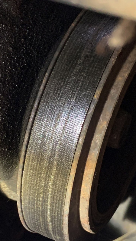

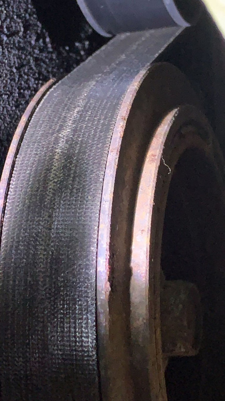

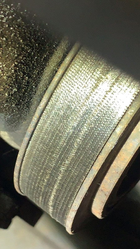

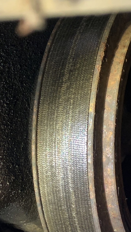

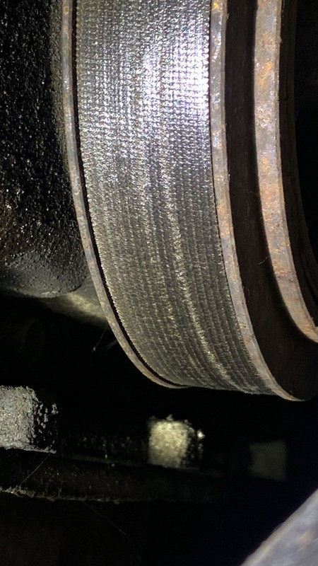

I did an oil change on my MR2 the other day, only after I refitted the nappy I thought of taking a look at the Aux drive/serpentine belt
would like to know if it's now time to replace the belt, the car has done 90K, we've owned the car from around 14 months old and never had the belt changed has no A/C
I've took a few photos of the belt I could see with the nappy on if it helps
Also any opinions on whether  to go for original MrT or after market?  Many thanks
I've seen worse, but it's about due.
I always recommend Gates belts.  They cost a bit more but the quality is hard to beat.
There's a 'How To' for changing the belt.
Thank you Carolyn. :) Gates belt it is then, in passing the car is a 2005MY

For all it takes and the relatively low cost I did mine a couple of years ago for peace of mind. Had been carrying a spare for a couple of years before that!
Didn't have any visible cracks but it looked a bit sad. I used a Continental belt, not for any particular reason, but it has been fine so far.
2004 Silver. Stock(ish).
Pete McCue
It's so easy and cheap to do, just do it anyway. Mine looked very similar to yours but the grooves on the inside were very cracked. I got a Gates.
