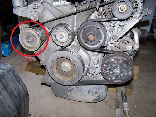

Just went and took the belt off, pulleys feel fine bar the one circled below, it spins freely and has quite a bit of play. Can anyone confirm if 13570-22010 is the correct part no. please? Is it worth replacing the long bolt that holds it in place too?
Beachbum957
That is the correct part # for the grooved idler

Beachbum957
Quote from: Joesson on December 22, 2024, 13:51@JP
https://autoparts.toyota.com/products/product/idler-assy-v-ribbed-1357022010
This diagram shows the pulley 13570, but also a bush/ bearing 90440-18010.
90440-18010 is just a spacer and does not move.  The only bearing is in the pulley.
J.P.
Quote from: Beachbum957 on December 22, 2024, 11:20That is the correct part # for the grooved idler
That being the case it could be that the bush/ bearing is the part that is worn!
I suggest removal of the OE pulley and have a look see.
Quote from: Beachbum957 on December 22, 2024, 16:5590440-18010 is just a spacer and does not move.  The only bearing is in the pulley.
