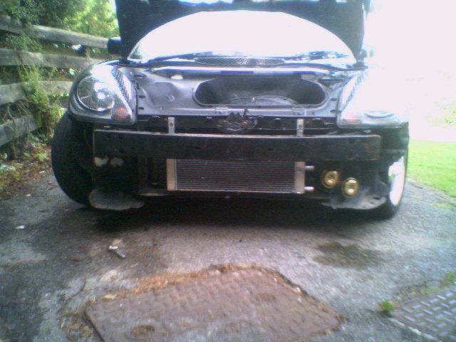

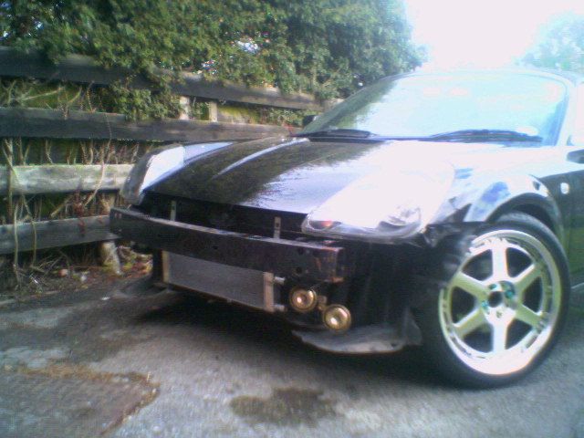

MR-S Turbo
I have a rad for the charge cooler but it came as part of a kit.  Pics below.
It is mounted in front of the original radiator.

philster_d
cool thats what im thinking
